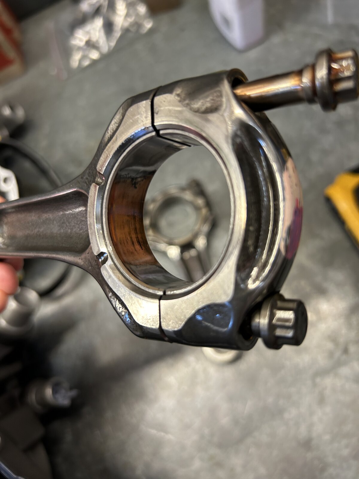

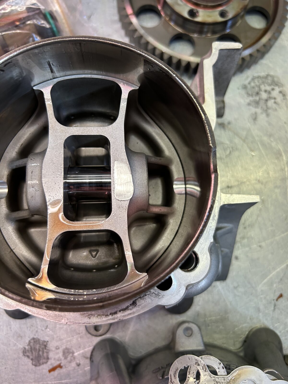

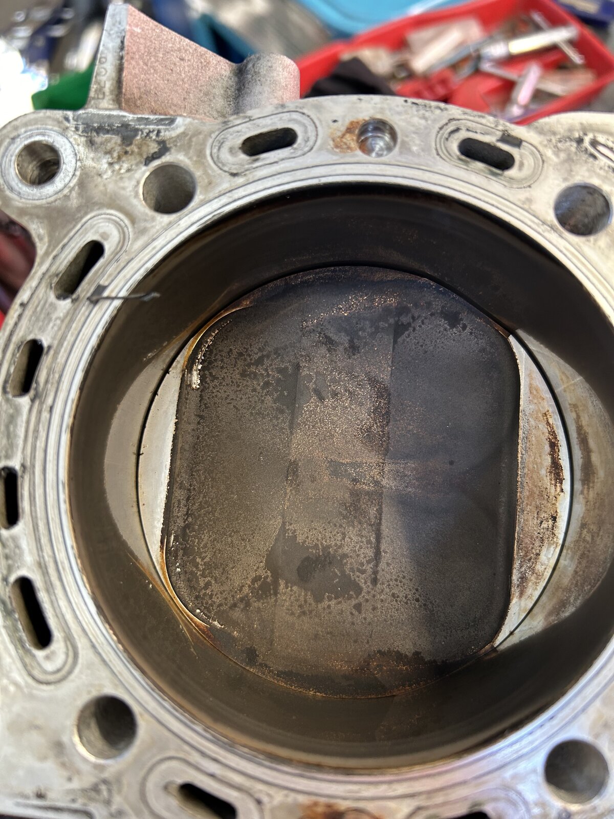

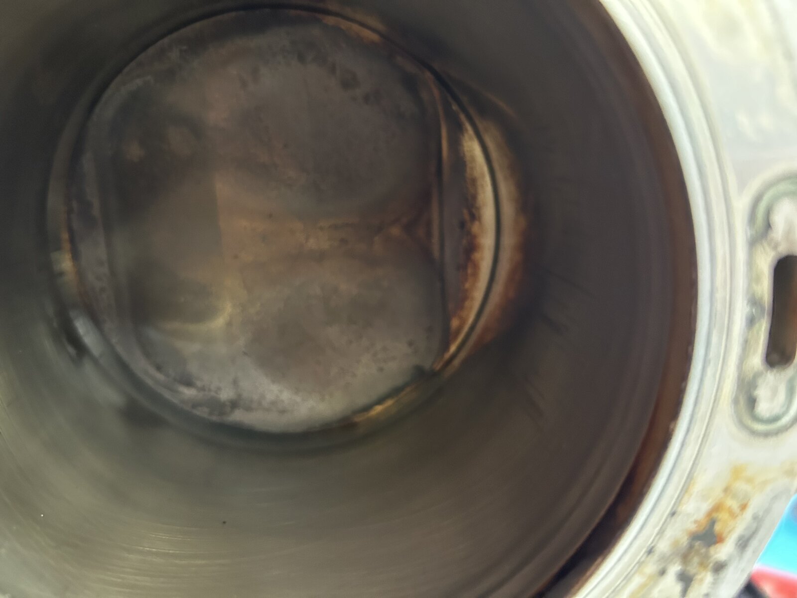

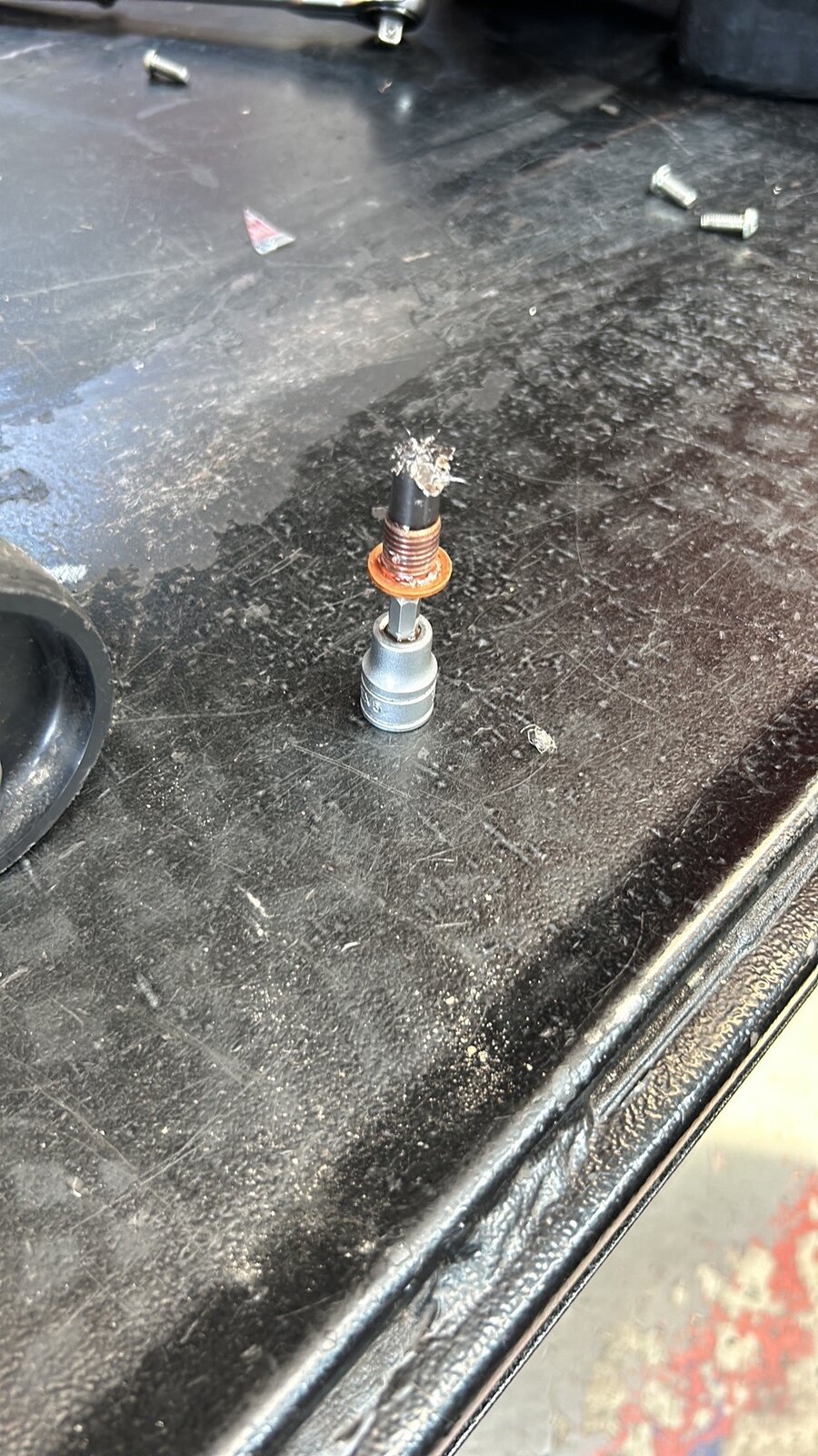

  1. Hi i have had my 1198s for a while now. It is well maintained only done about 9k but I do use it on track days. Unfortunately the big end ( I think) packed in down park straight on the warm up lap yesterday. So I am looking at a rebuild. Just wondering if anyone had any parts/advice on what to upgrade whilst its apart. I hope it hasn’t done the heads or crank as it may end too expensive to sort.
    Couple of photos and the debris below, thanks anyone for any advice.

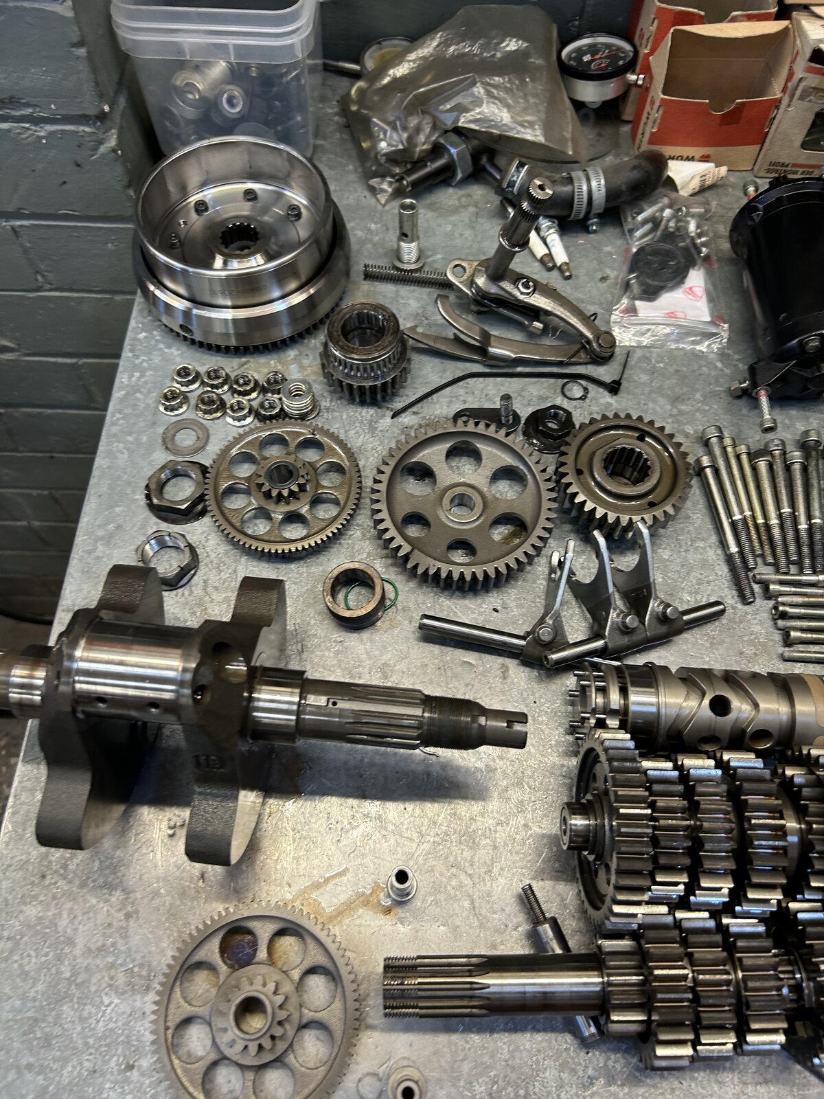

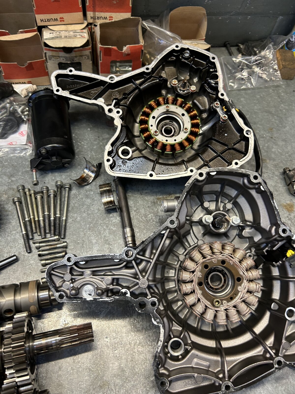

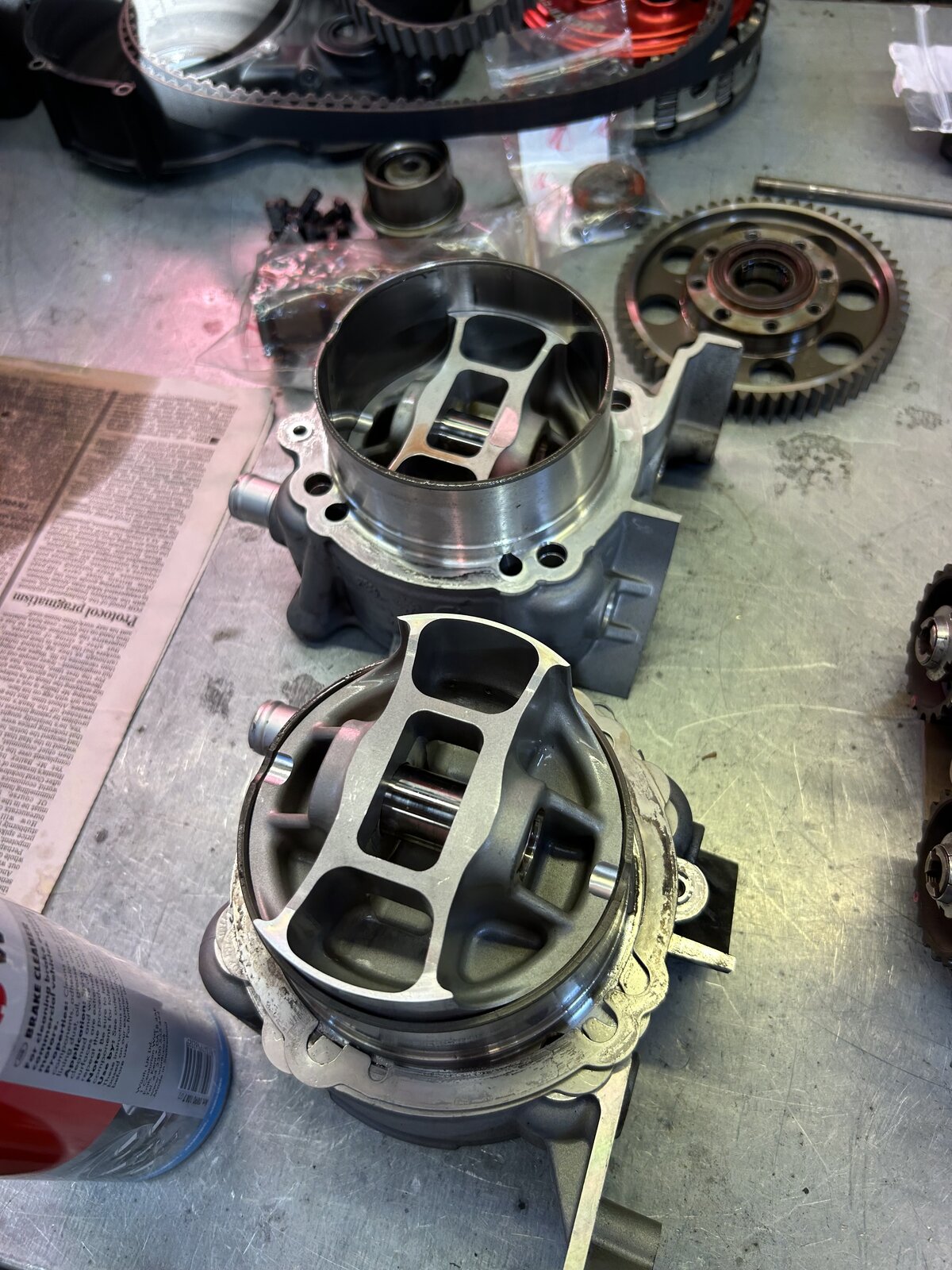

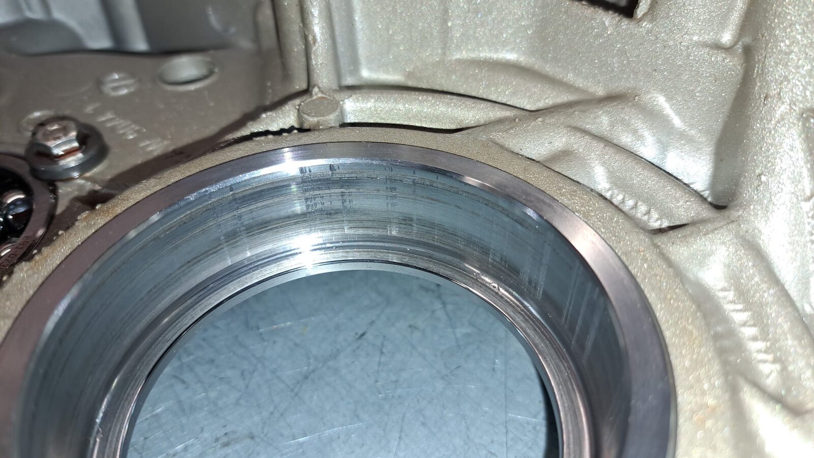

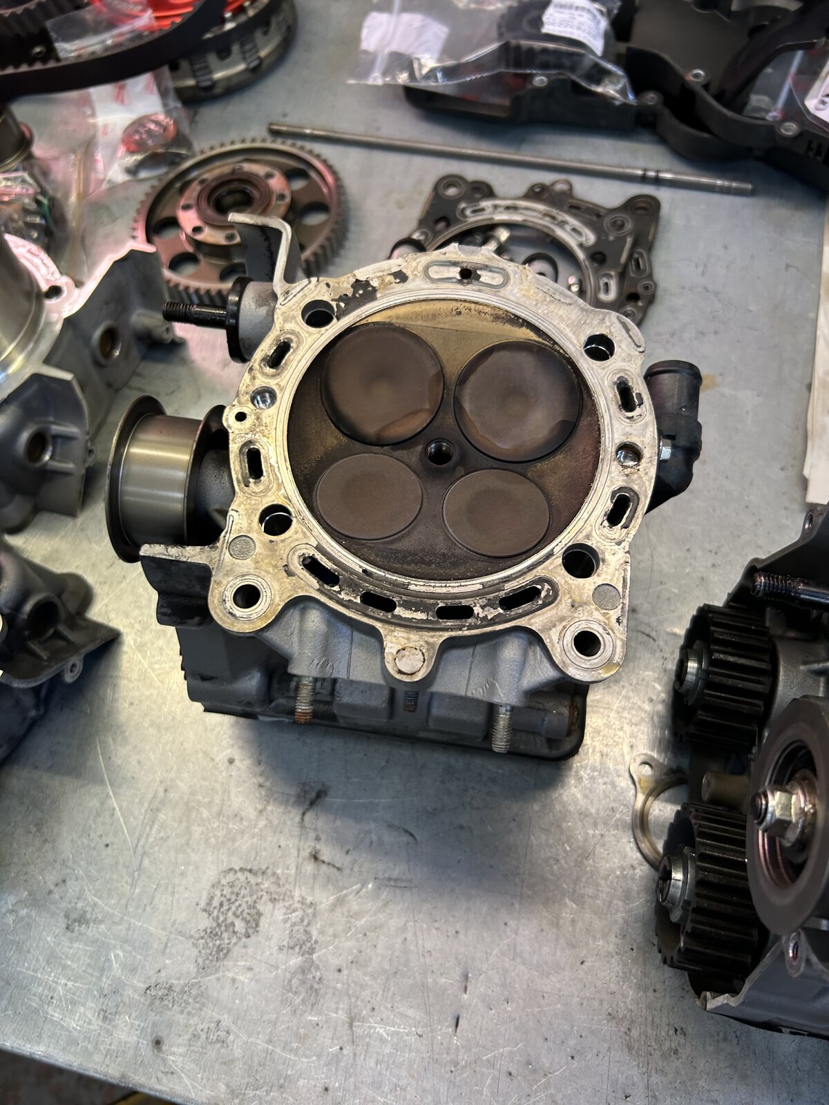

  12. So it’s taken a while but it’s in bits and I can see the scale of the issues. I have already got a replacement Crank and Rods. Cannot decide if it’s worth getting some wossner pistons. Any thoughts? Are they worth is there a benefit?
    my pistons show a small amount of damage from the crank and the head but it looks very minor to me. The heads look fine.

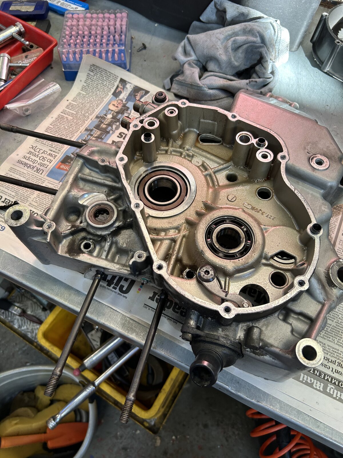

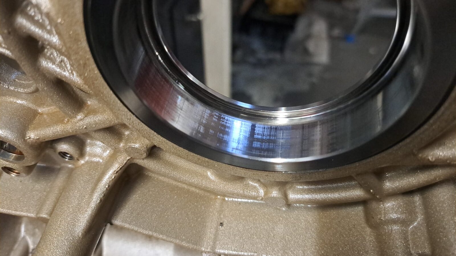

  13. Have you measured and confirmed the main bearing housings on the crank cases are round and within tolerance..?
  14. Not yet, they looked ok but will check them before they are replaced. The idle gear has worked itself lose despite the screw being tight. Currently looking at options around sorting that too. The crankcase has worn slightly oval so it will need machining. An 848 Evo cover would be the ideal fix but cannot find one.
    • Lock Thread Lock Thread x 1

  17. So had the bearings removed, both were tight but the right one has spun in the cup so will need to be replaced. Any tips on what I should be looking for here? Is it worth changing both cups?
    The case seems ok,
    • Nuke Post Nuke Post x 1
  18. Opinions might vary, but a "no brainer "for me, definitely replace both.
    how does the crankshaft conrod bearing journal measure up? Any sign of discolouration? It's not something that can be decided on a picture, Ditto the conrod with the junk bearing, there's a chance that replacement might be safest option if in any doubt.
  19. I would get the bores accurately measured before proceeding you need to be confident they are indeed round and within tolerance
    then I’ll put you in contact with the RS engine
  20. how long is a piece of string? You might as well start checking every single bearing housing in that case. are there any signs of slipping on either internal or external journal, and any signs of overheating? some people have suggested some engine rebuild experts, it might be quicker to take all suspect components to somebody that you trust and get them to actually look at everything.
