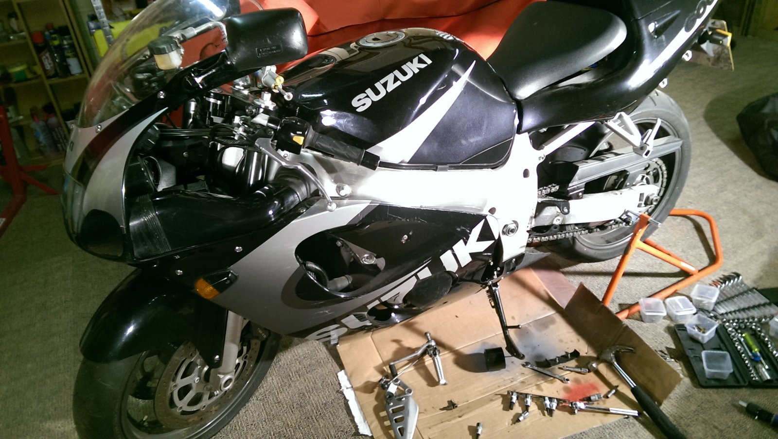

  14. Starting to put GSXR back together, learnt:
    You can never take enough pics.
    The more little bags with more little notes in the better.
    Wiring is a bitch.
    If they could harness the kinetic energy created by a washer landing on a garage floor and exploding to a far flung darkened corner the world's energy crisis would be solved
