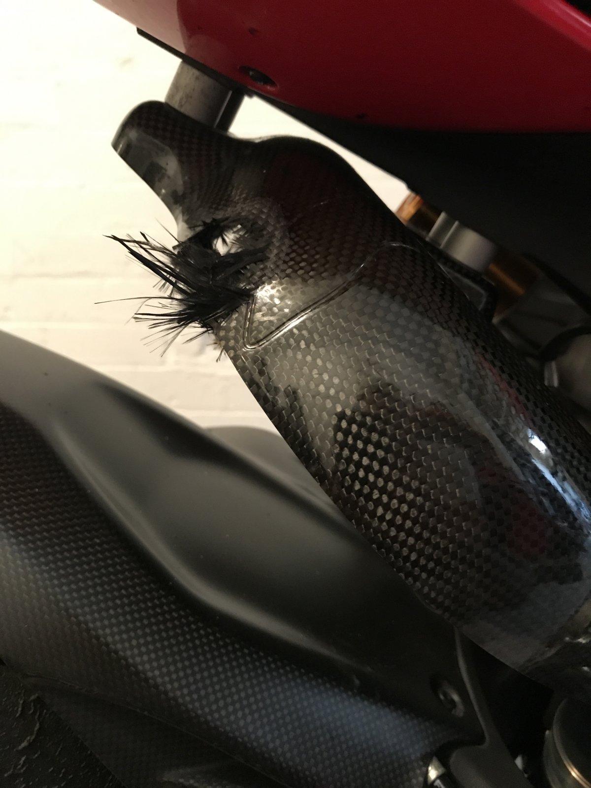

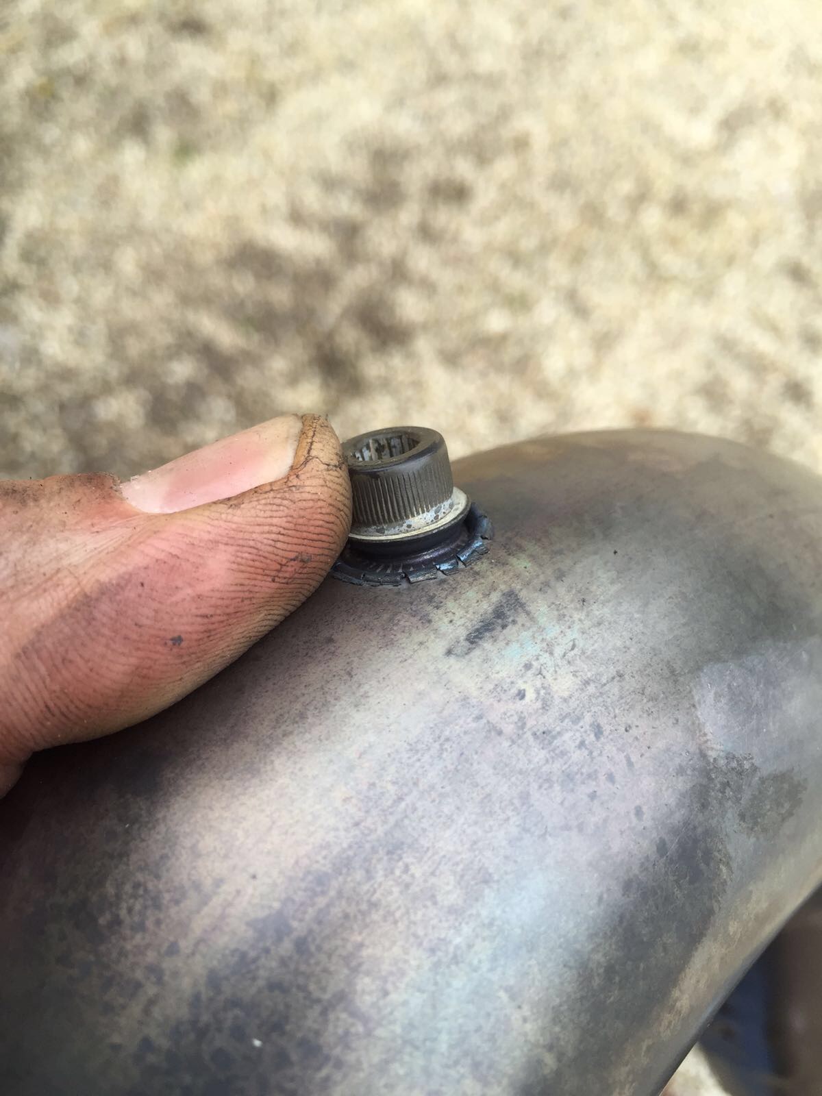

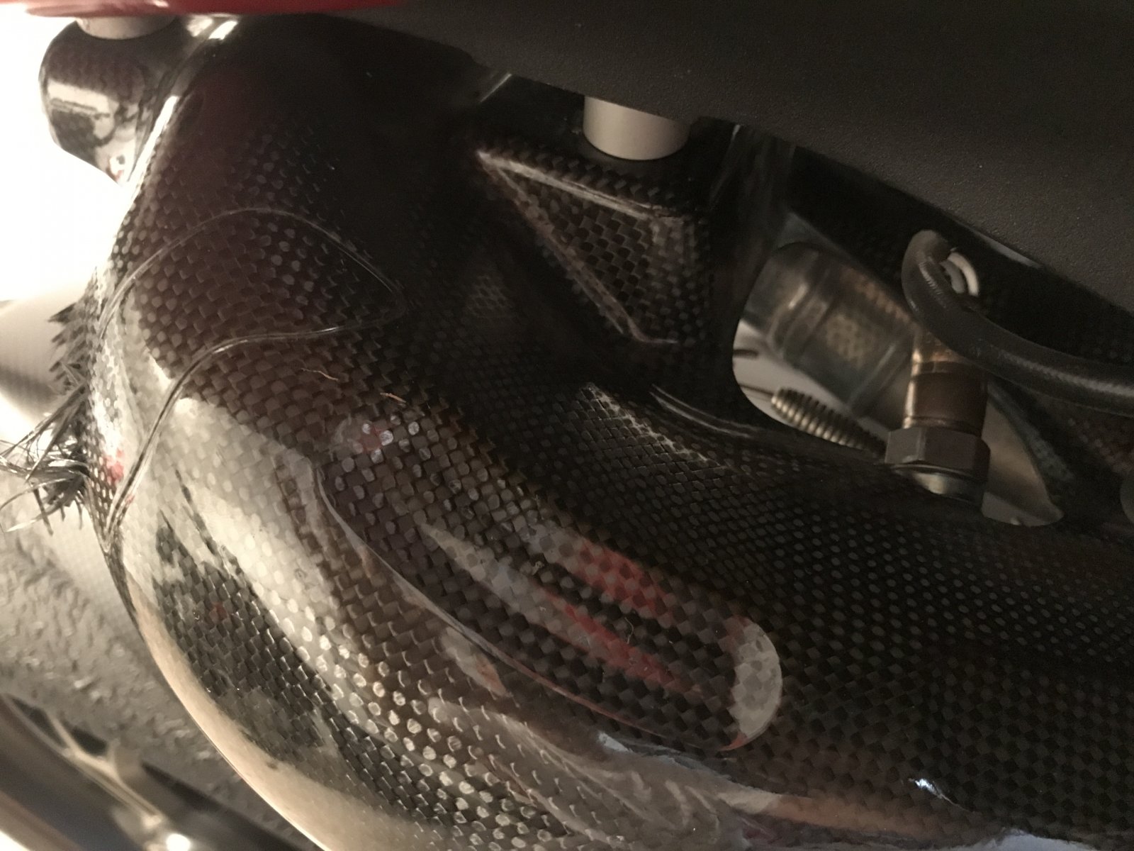

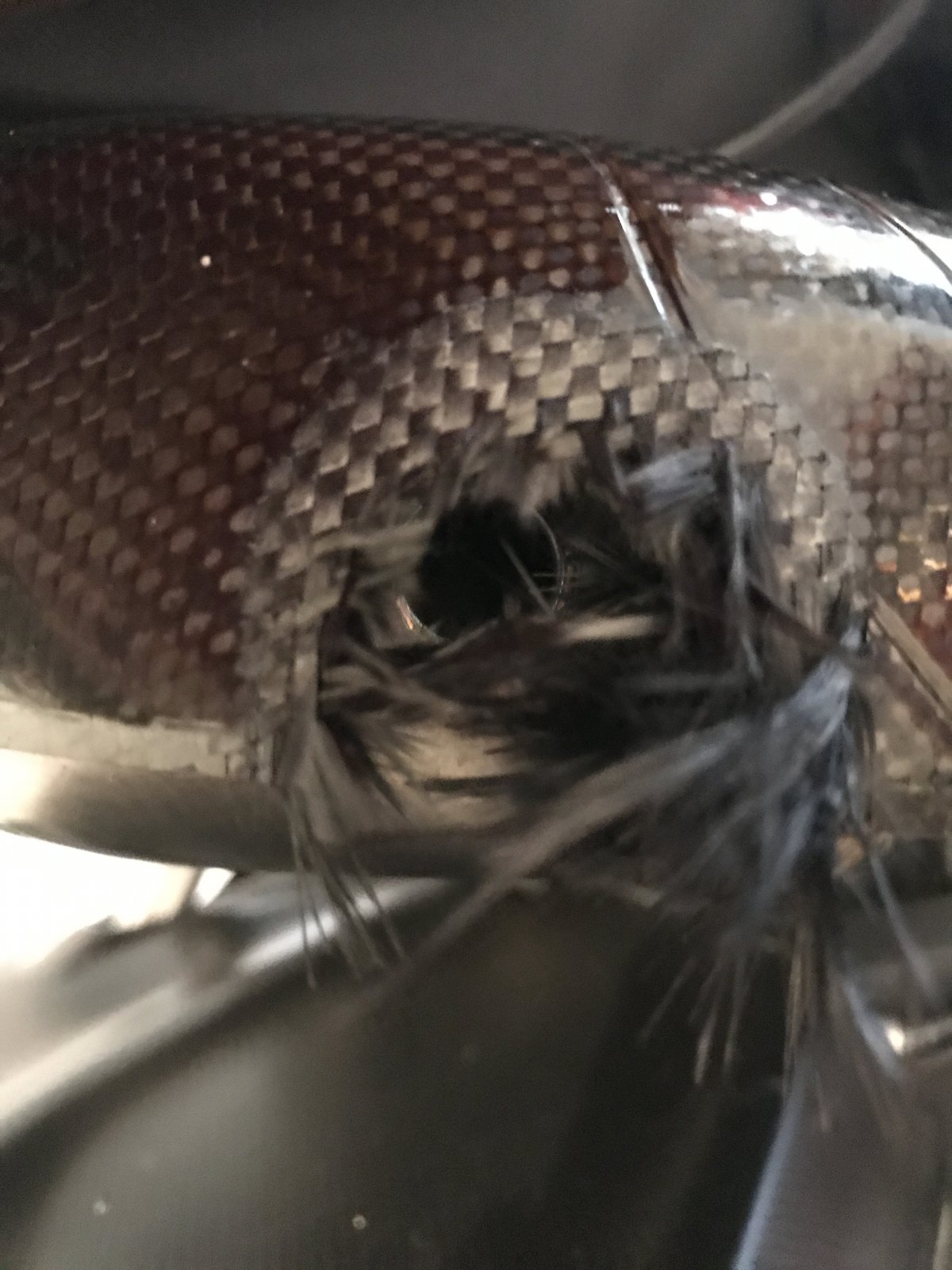

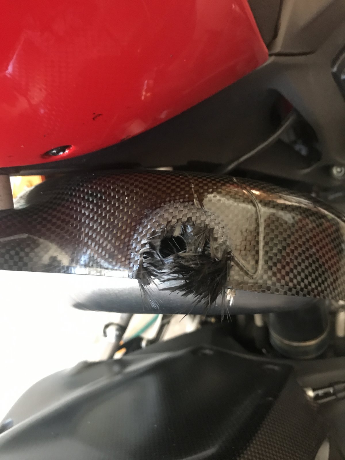

  1. IMG_1172.JPG IMG_1175.JPG IMG_1177.JPG Hi
    Can anyone with a full Akra system let me know what was once where this hole is now? Some sort of plug/weld?? Noticed after Silverstone on Thursday
    Cheers. Harry
  2. Plug for lamba sensor
    Is this not the lambda sensor on the right??
  4. its for a secondary theres usually a plug in it
  5. Cheers Benny. Not anymore. It's on Silverstone track somewhere
  6. It's a rivet but that has come loose. It's for taking co2 readings apparently. Easy enough to fit a new one (with the right tool which luckily my dealer has) but shitter about the carbon heat shield which is £350 to replace. Will be tidying it up as best I can with a file!

  9. Ouch! Looks like your exhaust has been shot at.
  10. Although the carbon shield is KIA you can probably TIG a blanking plug in the exhaust. If the shield can be removed it can probably be welded without removing the exhaust....Just be sure to disconnect the battery
  11. TBF it was a good job the heat shield was there to slow down the projectile...Could have been pretty hectic being twatted by that on the race track

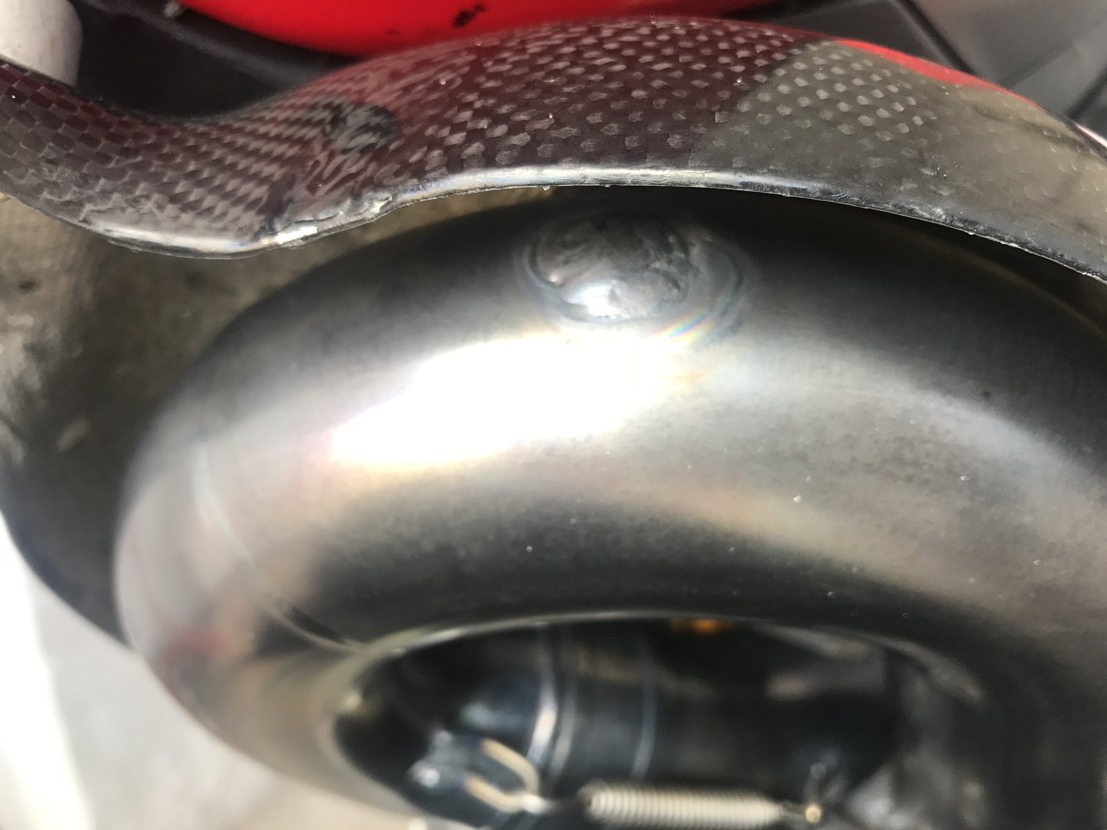

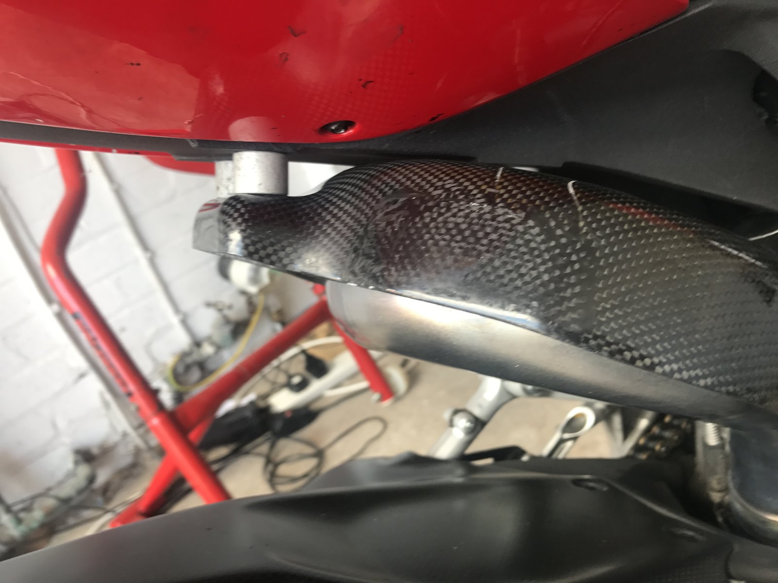

  16. IMG_1380.JPG IMG_1381.JPG So... went for the hole welded up £30 and a £70 repair on the carbon heat shield.
  17. Happy days, thats nicely done :)
