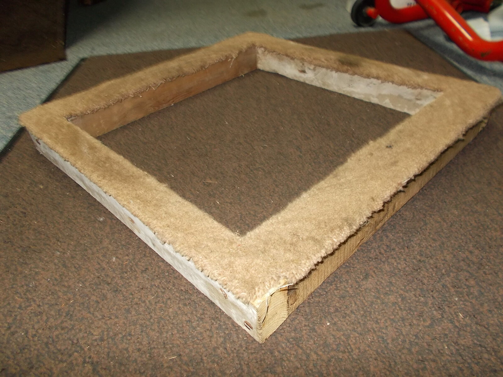

    Take a bit of time and make a tyre changing board ( the bit with carpet on ) you can't see from the pic but it has 2" batons all around the underside so its raised off the floor, then when you drop the disc into the big hole, the wheel sits nicely on the carpet and doesn't get scratched.

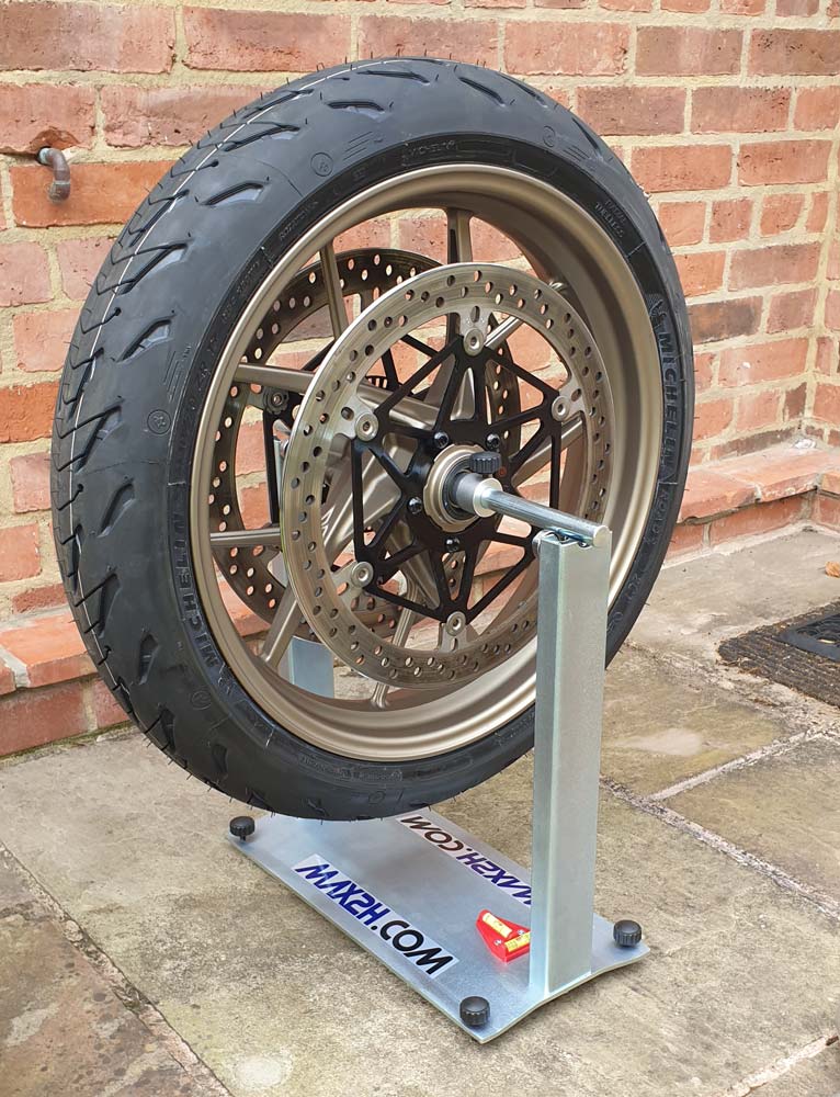

    Home made wheel balancer made from old paddock stand and 4 bearings, ( tyre is just stood alongside it for no reason really! )

    Don't assume the valve is the heaviest point of your bare wheel, check the balance of the wheel with the tyre off, I've had wheels where the heaviest point was about 8" away from the valve.
    Mark the actual heaviest point and align the dot on the tyre here, the more accurate you are matching these, the less balance weights you will use.

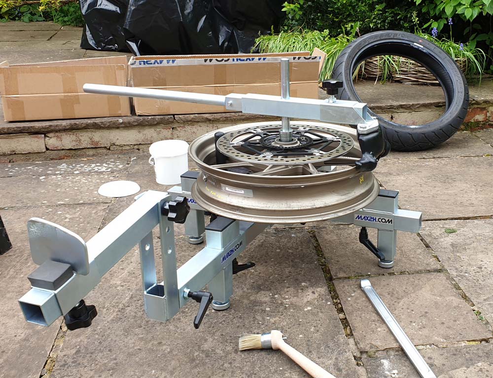

  4. Ahh,..right, my bad, I’ve just watched the video and if you get all that for £70 odd quid it’s a good deal!
    Only thing it’s missing is a centralising cone to take the main post diameter up from 19mm to whatever bore your axle is, if you watch the video you can see it flexing when he puts the tyre on.
    Might have a punt at one mesen for £74 quid or whatever it is,...good spot DS :upyeah:

  7. Heath Robinson?? you referring to my carpet lined timber frame?:p
  8. That’s the kiddie....;)

  12. If you have a look at the board in my post above CR when I drop the disc into the hole I can kneel on the rest of the board, it’s long enough to have the wheel and myself kneeling on it.
    Not only is it comfy on my old knees, but it allows me to shuffle up the board and the disc moves up to the top of the hole then stops when it touches the edge of the board, I can then exert a bit of pressure on the tyre with my knees to force the tyre into the wheel well and keep it there while I lever it onto the top edge of the wheel.
    You need loads of tyre soap on it, and on your rim protectors and levers, don’t be too greedy with trying to get too much on at once, work in about 4 or 5 inch lengths and it’ll go on okay.
    It also helps massively if the tyre is nice and warm, it’s a lot more flexible, I put mine in next to the hot water tank for at least an hour before I fit them, just be patient you’ll get there :upyeah:

  16. I've just ordered one of them fancy machines from 24mx.co.uk as it looks alright to me.
    They do charge shipping but no additional taxes to pay and delivery via RM.
    They sent me a discount code for 3 mates - 10% off your order. If you want one of the two I have left, PM me and I will send you the link. It will cover the additional postage.
  17. I have this kit, cost quite a bit but an investment in being self sufficient, solidly made, will see me out. Works well for my MV before and now the 1260 MT'S.
