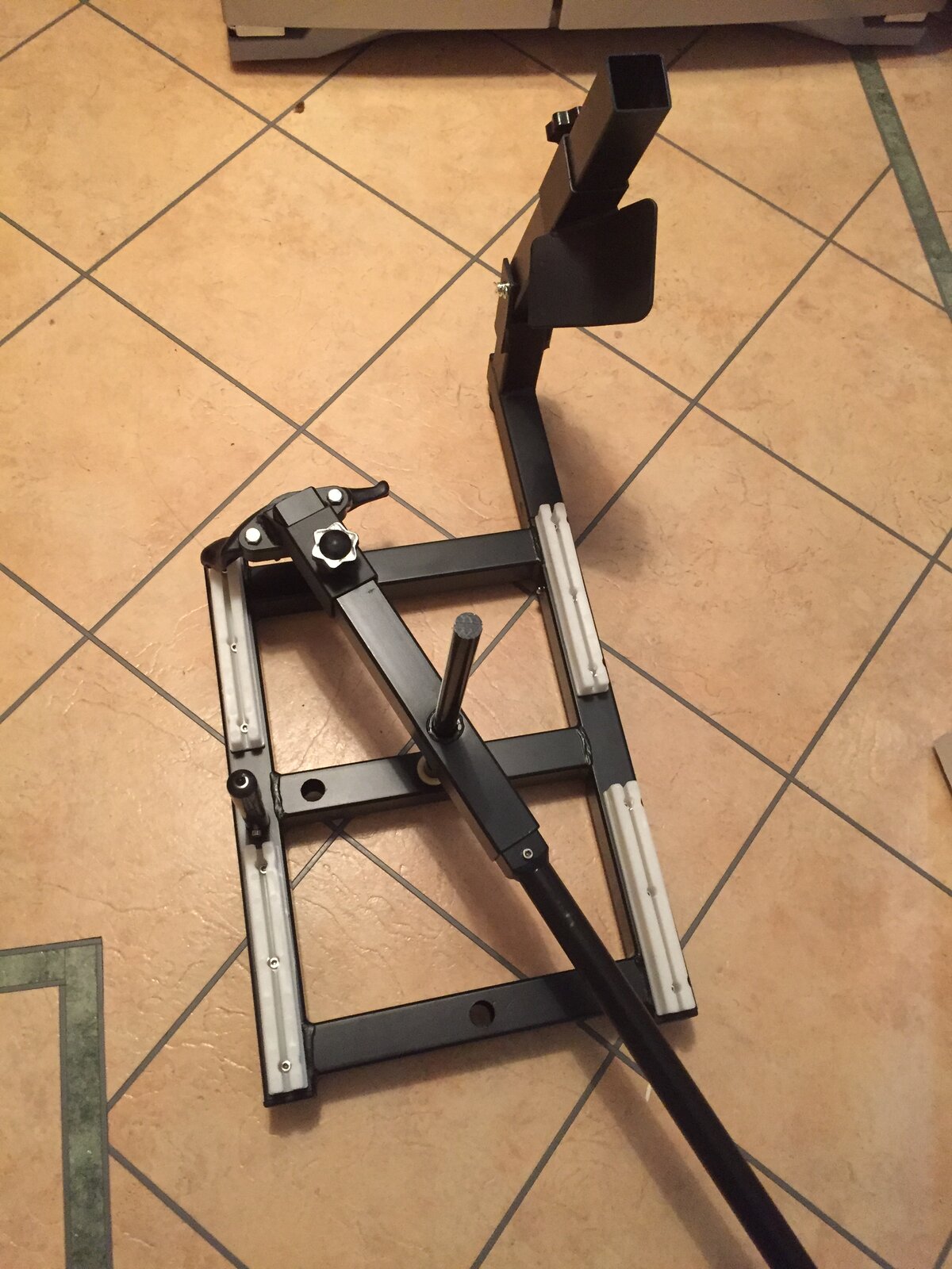

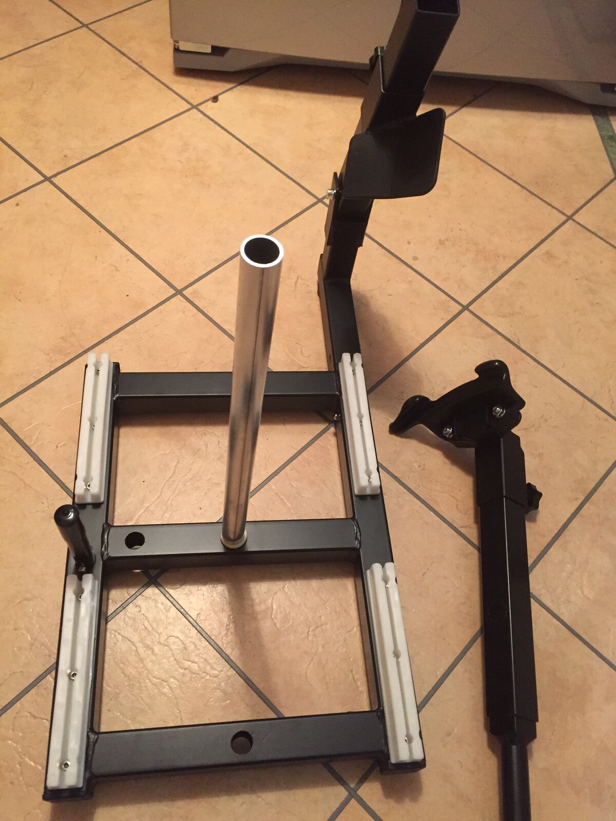

Look what arrived today... Quality looks.......okay, for what it has to do, pivot pin for bead breaker arm took a bit of persuasion to get through, but it all goes together easily enough. No assembly or operating instructions included, so I’m presuming that this aluminium tube is to take the axle diameter up from 18 MM diameter to 25 MM diameter if you need it? Trouble is, the bore of this tube is 21 MM internal diameter so you have 3 MM clearance on the 18 MM spigot so it’s a really sloppy fit, or to use an old technical term from my engineering days...” It fits like a prick in a bucket “ !! Only trouble is , it’s so long it stops you getting the tyre changing arm on the 18 MM spigot unless you hacksaw a bit off the length of it?? I’m going to add a rubber bumper under the bead breaker arm just in front of the blade, because if the bead breaks all of a sudden and your not ready for it, in theory you could clout your wheel with the underside of the arm. I’m sure it’ll do the job though, soon find out at the end of the month when I’ve got new tyres to mount when my new wheels arrive
Mine arrived today as well. Pretty impressed with that service to be honest. Better than many uk based companies. I had the same hacksaw thought ref the aluminium tube.
