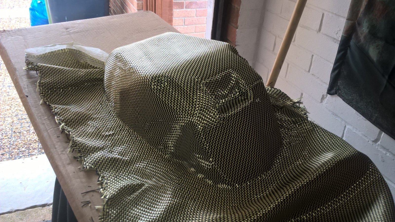

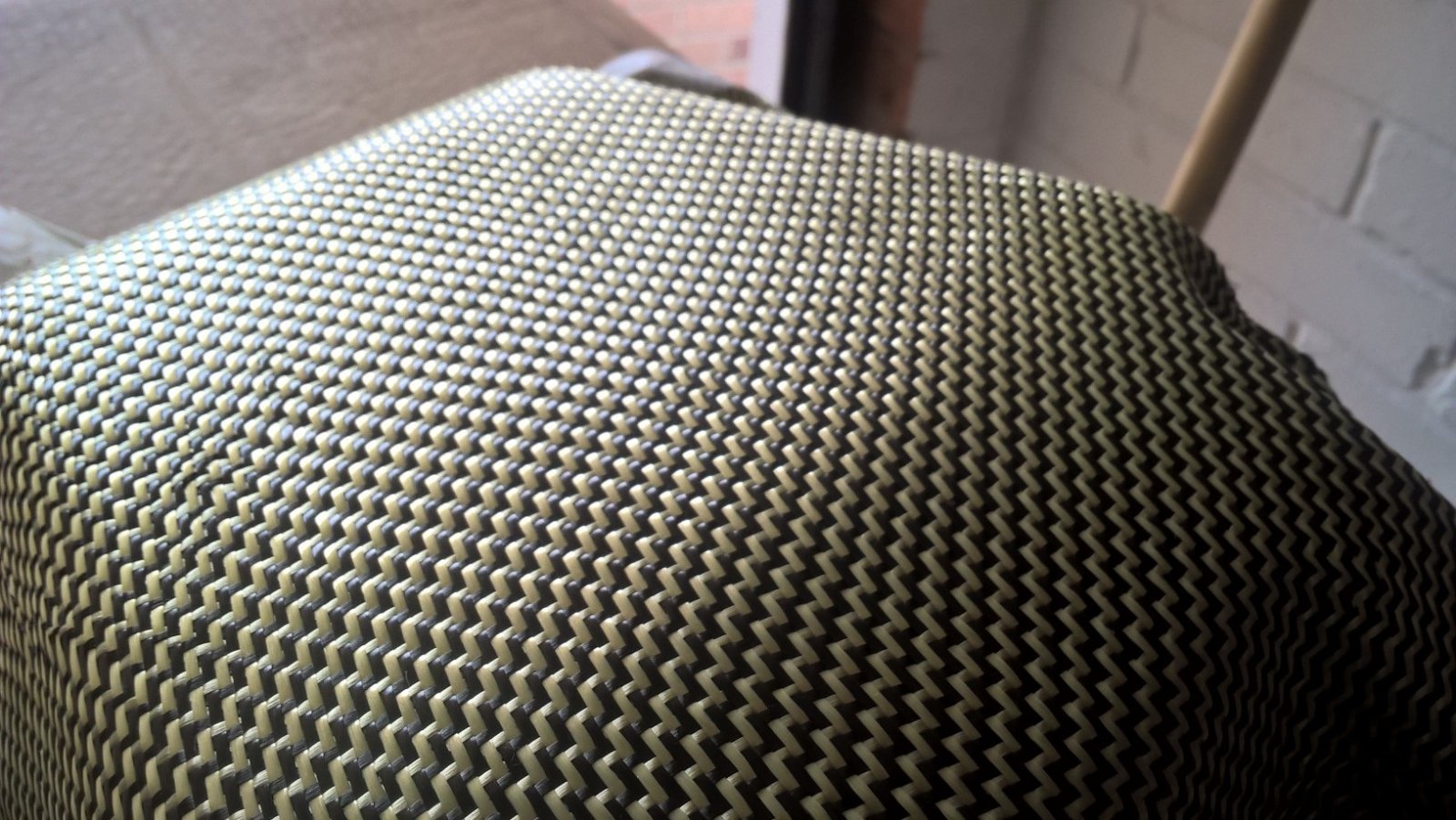

  1. I really should spend more time on this project. Anyway, finally laid the top half up and put on the aesthetic outer layer, in Kevlar, didn't want carbon. Now just a case of laminating and the joys of cutting kevlar. Its now strong enough to take a lump hammer to it and a fraction of the weight of OEM. Looks a bit uneven weave in the first picture, but thats just the light reflection. What a ball-ache though! airbox.1.jpg airbox.2.jpg

    In your 1st picture, have you used a mould release rubber, the green stuff? If so what is it?
    Then plaster of Paris over that?

  5. The green stuff is the Tooling Gel, which you paint over the OEM airbox, and then I used a Fibreglass mixture to put over the top of the tooling gel when it was tacky. So when you take your airbox out of the mould, the tooling gel is left with a nice smooth finish to lay the carbon/kevlar into.

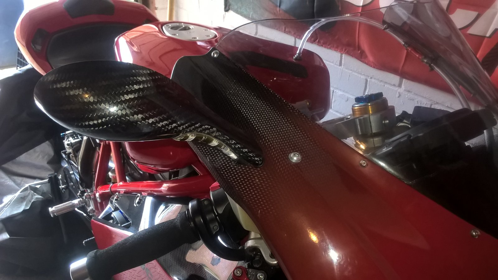

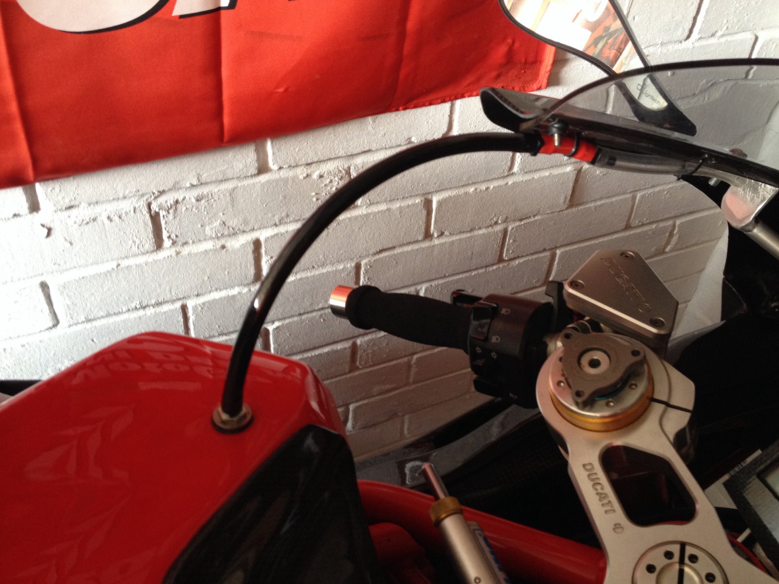

  12. WP_20160706_12_56_50_Pro.jpg Thanks. A better view of them...I think they stick out just that little bit further WP_20160705_11_19_57_Pro.jpg
  13. OK, is the fairing carbon fibre sprayed up to the mirrors and faded to expose the carbon. If you get what I mean.
    Looks like a lot of time and money spent on the bike.
    BTW, what's in the blue bag.
  14. Disappointed I didn't get the brown bin in. Yes, the nose is CF which the red fades out, doesn't make the mirrors too obvious. Or that was the idea.

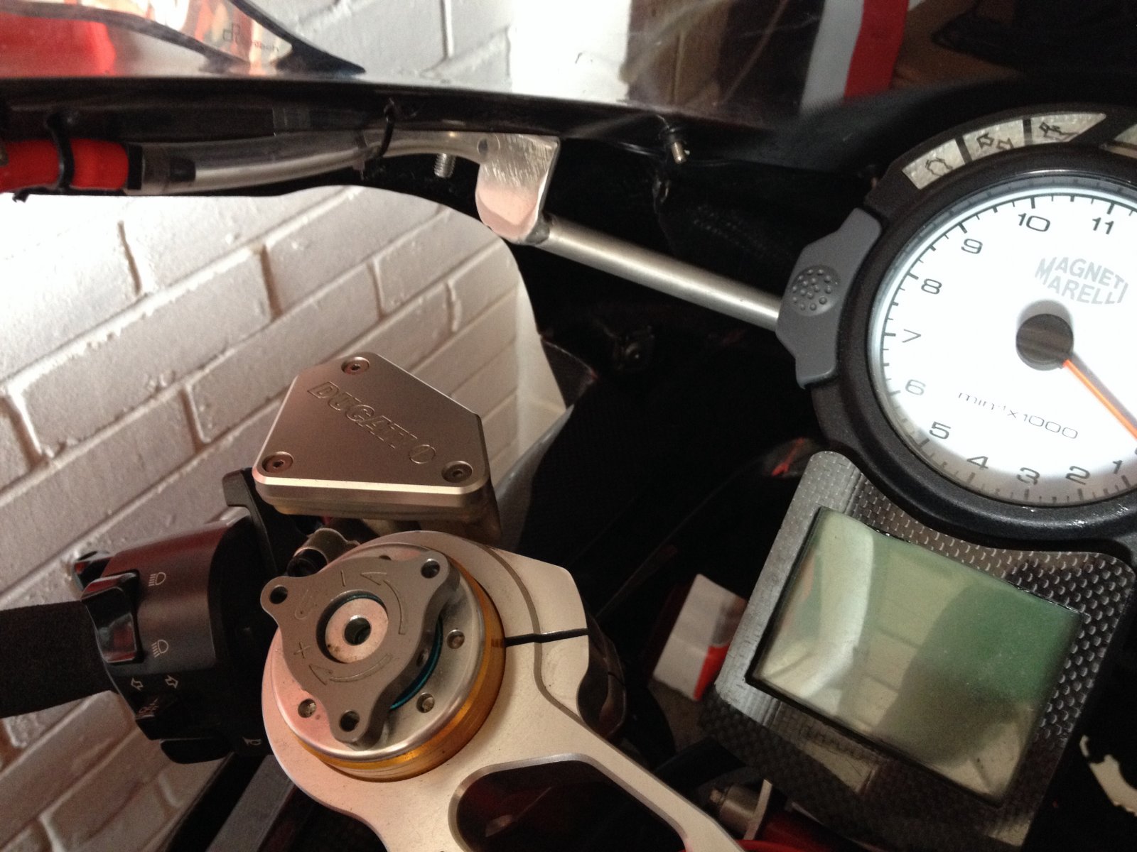

  17. Hi what headlight did you use?

  19. Just seen this, I no longer have my R...I cant remember where I got if from, but it was from Germany, had a shutter system on for hi/lo beam. Front end was very light, doing away with the instrumentation mount and stacked headlights. If I remember I will check back.
