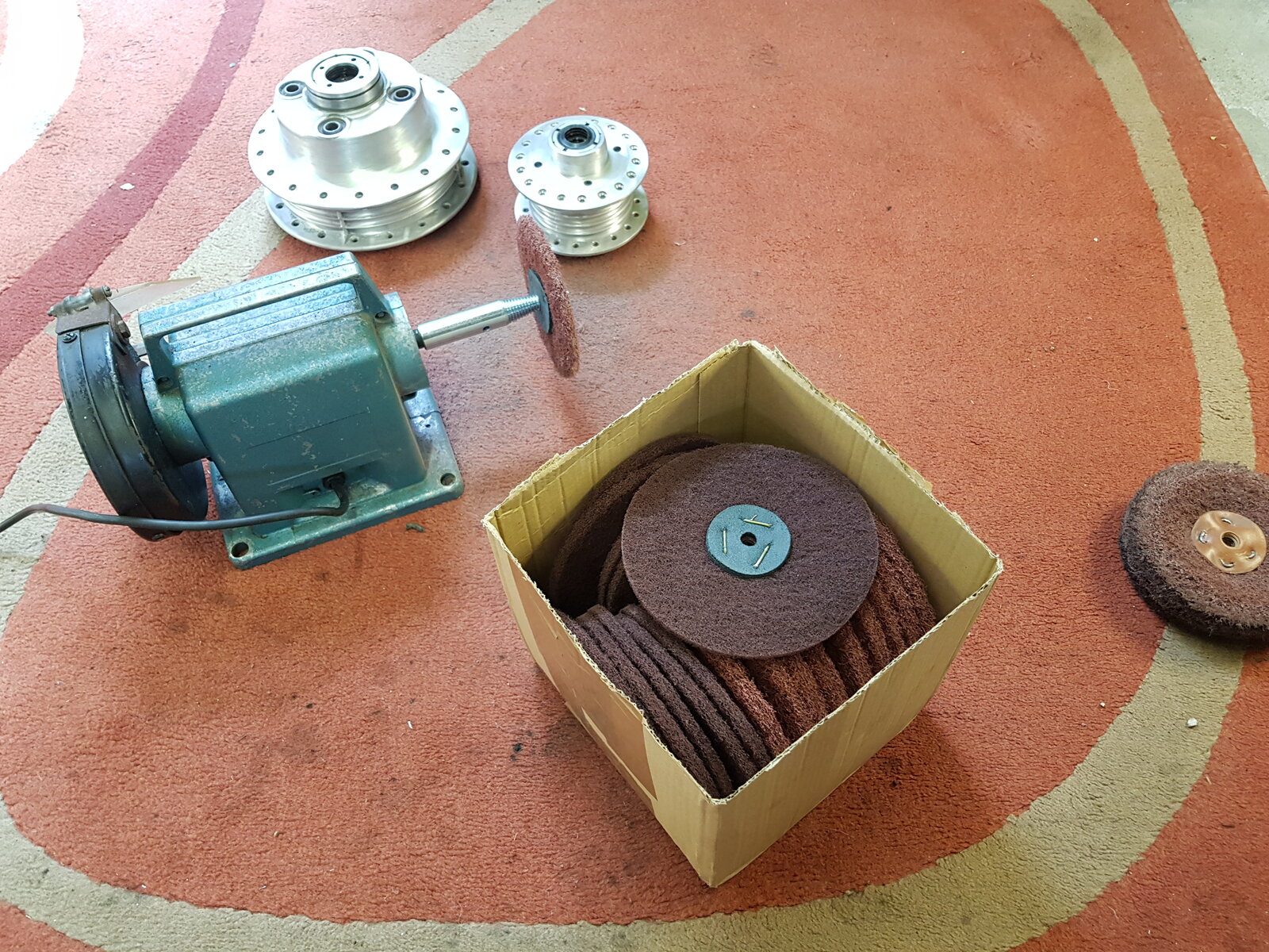

  1. Yeah - thats what ive got - (one with 4 pads stapled together) be nice to get some singles and doubles in both red and green (im told green is the finer one?)
  2. Wheels ordered from the polishing shop - thanks very much again...
  3. Wheels arrived last week...back to the polishing... 15938614117933758730536584501038.jpg
  4. You know about the little versions you can get for your dremmel right - if not have a look on eBay?

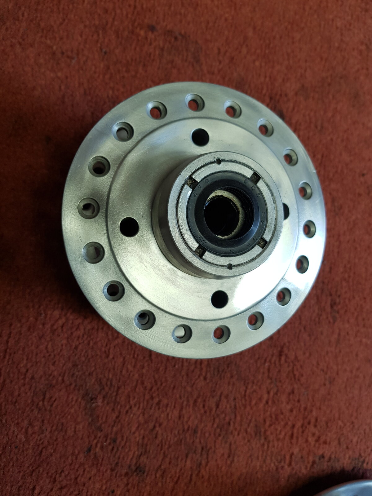

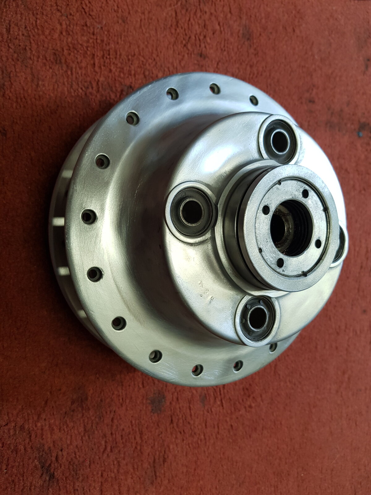

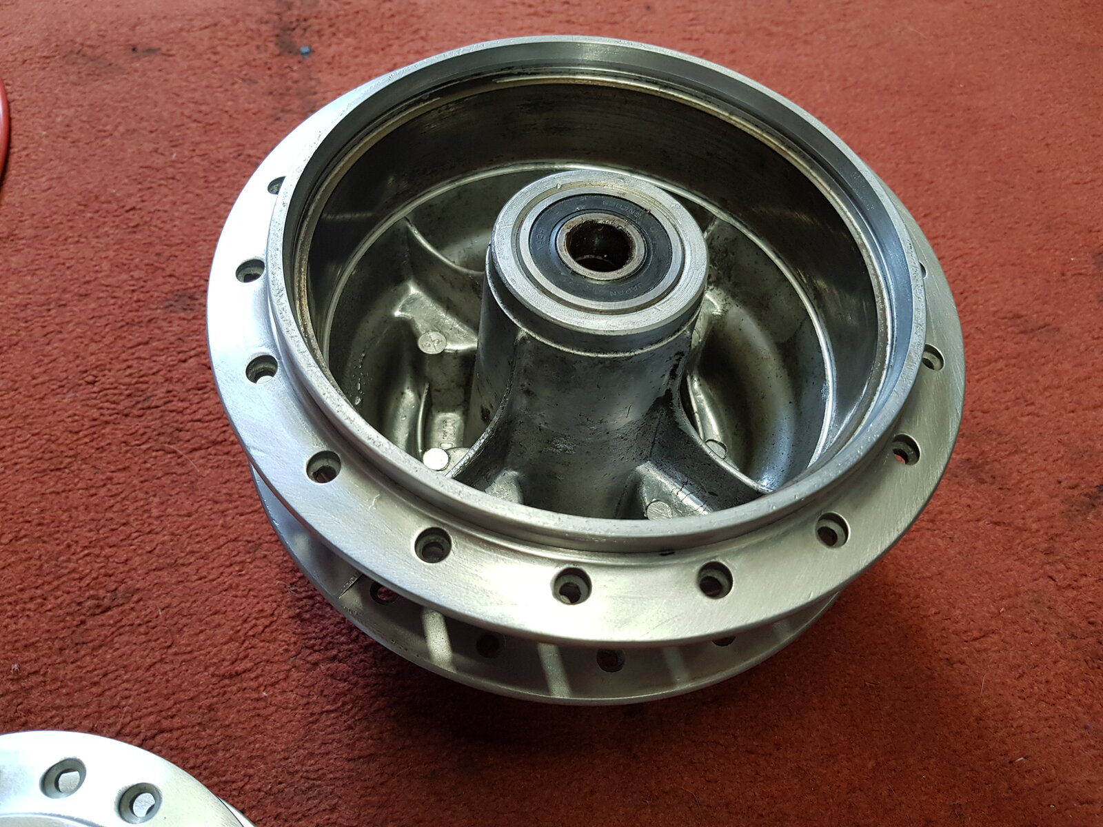

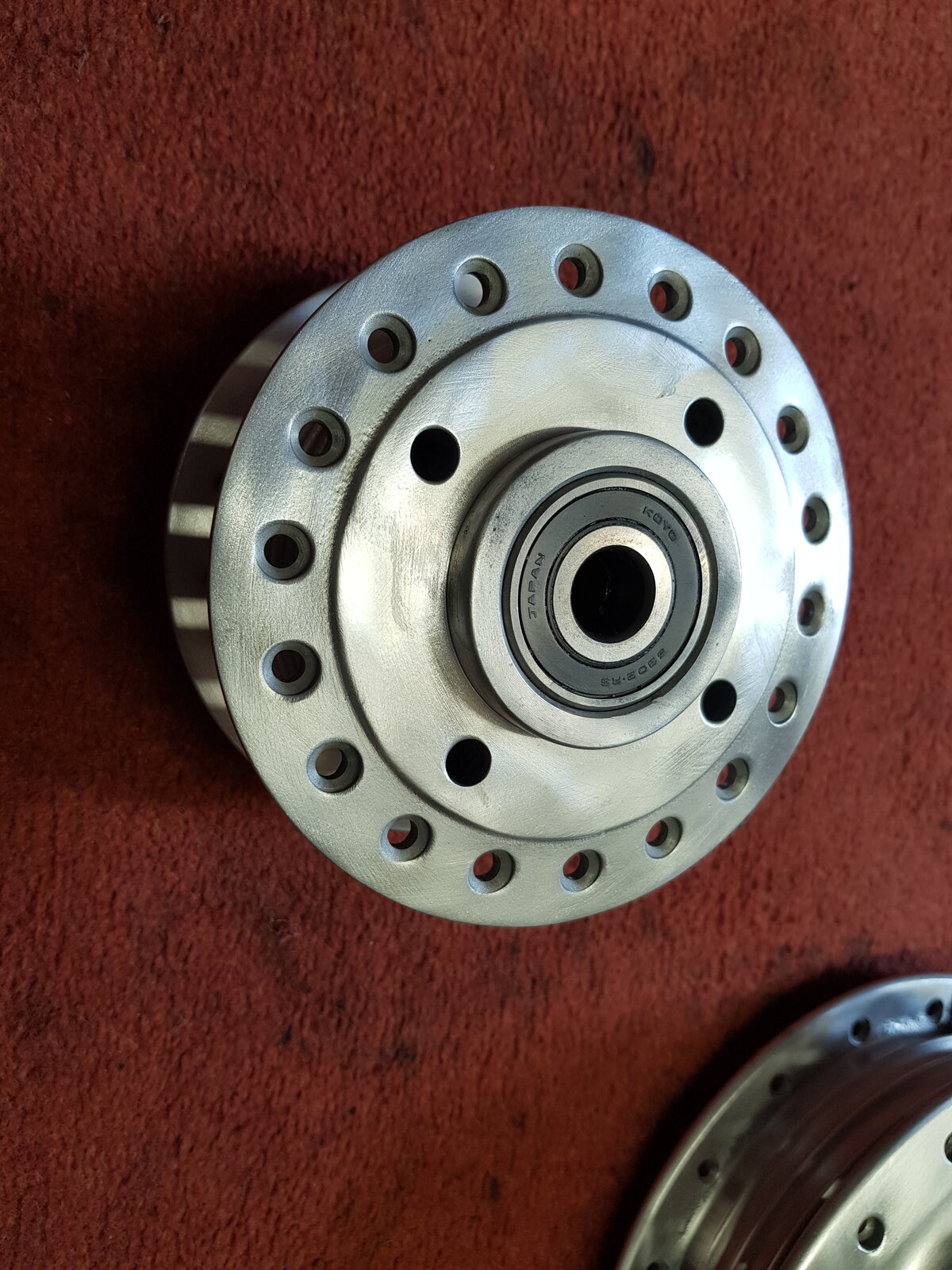

  5. Calling all scotchbrighting nerds....been over the hubs with a coarse and fine....can i get better? Im happy with the result....20 times better than they were.... 20200704_130516.jpg 20200704_130533.jpg 20200704_130522.jpg 20200704_130511.jpg
  6. Yep...got a bag but they dont seem to do much and seem to wear down instantly...
  7. They do wear quickly. But if you can stand the mess, using them with very light pressure and some Auto Sol (or evivalent) has made a few things I own mirror shiny! With the finish from a cotton mop of course.
  8. Ah - im not looking for mirror finish - id like a kind of brushed alloy finish to match the rims...
  9. Ah - cool - ive got one of those - which wheel to apply it with though??

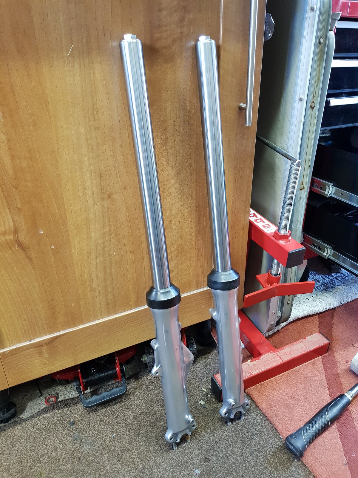

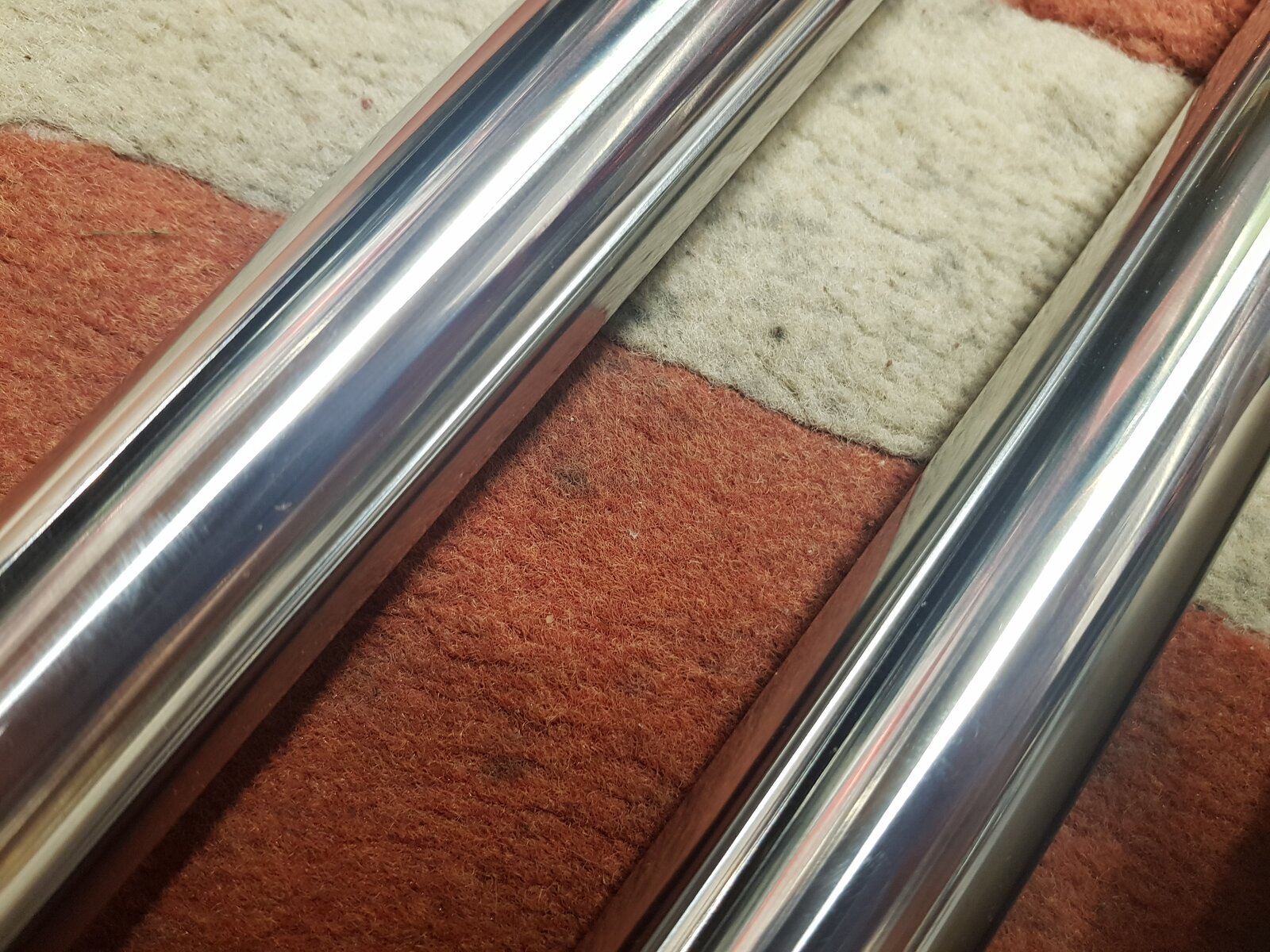

  10. Forks back from being reground....look like brand new....my old man would be pleased...

  11. Who did your forks?
    Not a nerd , but looks fine although doesn’t look like you’ve finished by hand ? I’d finish in one direction then wash prime followed by clear coat ( lacquer) unless you’re going to polish
    For the lap mops , grey is finest
  12. Im at work at the moment....i forget their name - they did them for 189 delivered back to me....ill post it up here when i get home....
    Hubs....im going to polish them up a little more and the company that i use for powdercoating do a clearcoat powder coat so once thats done on the weekend ill drop them off.....
    End of the month (when i get paid) will be getting started on the engine....getting it all blasted and recoated...
  13. Company is A.M. Philpotts - they do new stuff also....dlc coating also i think but youd have to check...
