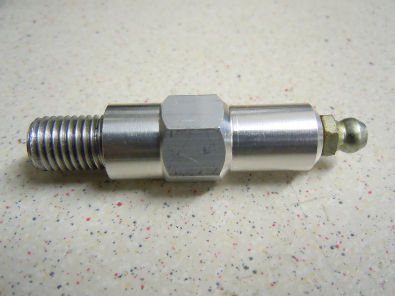

  3. A grease nipple with the same thread as the brake pipe union should do it. Only the one caliper half has a piston in it, so the only possible holes are the brake pipe connection, the bleed nipple and the piston seal.
    The other brake pad is brought into play by the caliper and its ally mount moving on the steel pivot where it’s attached to the fork leg. That needs to move freely, which is why I suggested you check it.
  4. Its the grease nipple bit.....that i dont have....and even if i did im not sure how it would connect together and, if it would stand the pressure...
  5. This is what you need. Screw this, or one similar, into the caliper, ensure the bleed nipple is fitted & tight. Connect a grease gun to the grease nipple & pump. Easy, never fails & unlike using compressed air, won't kill you as the piston flies out or trap you hand !!
  6. Ah - right - ok....yeah not got one of those...where do i get one from??

  7. Cats suggestion is the way to go but if you can’t do that for any reason in the past I have grafted a Schrader valve from an old mountain bike inner tube onto a brake union and used a foot pump , it gets the piston out great but as CAT3 said is likely to kill you in the process.
  8. To be honest id rather get one of those bits...looks like a handy tool to have...

  12. You'd need to know the thread size in your caliper, that's diameter & pitch, then ask a friendly local machine shop to make one for you. Alternatively, some kind person on here with access to a lathe may be willing to help ! You'd then have to buy a grease gun.

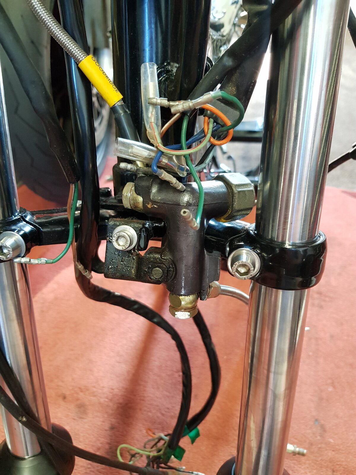

  17. Ive got another brake related question...half way down on the bottom yoke there looks to be a servo...(ill get a pic in a min). Its only a single caliper...do i need the server/mid part. Itd be nice to get a single line from Hel if i could but if its gotta be there then so be it...
    I know the switch is in there but i could get a banjo bolt/switch to do that job...
  18. Servo?? I can only see a rather large (& ugly) brake-light switch manifold:thinkingface:
  19. Well, im calling it that...wasnt sure if it was some sort of cylinder....if its literally for a brake light switch then ill remove it...rather keep it simple....i can just have one line down to the caliper then...
  20. That’s the brake light switch I believe.
