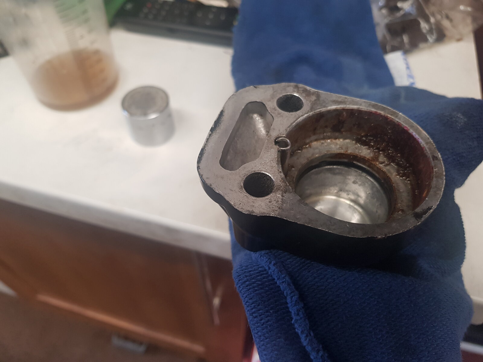

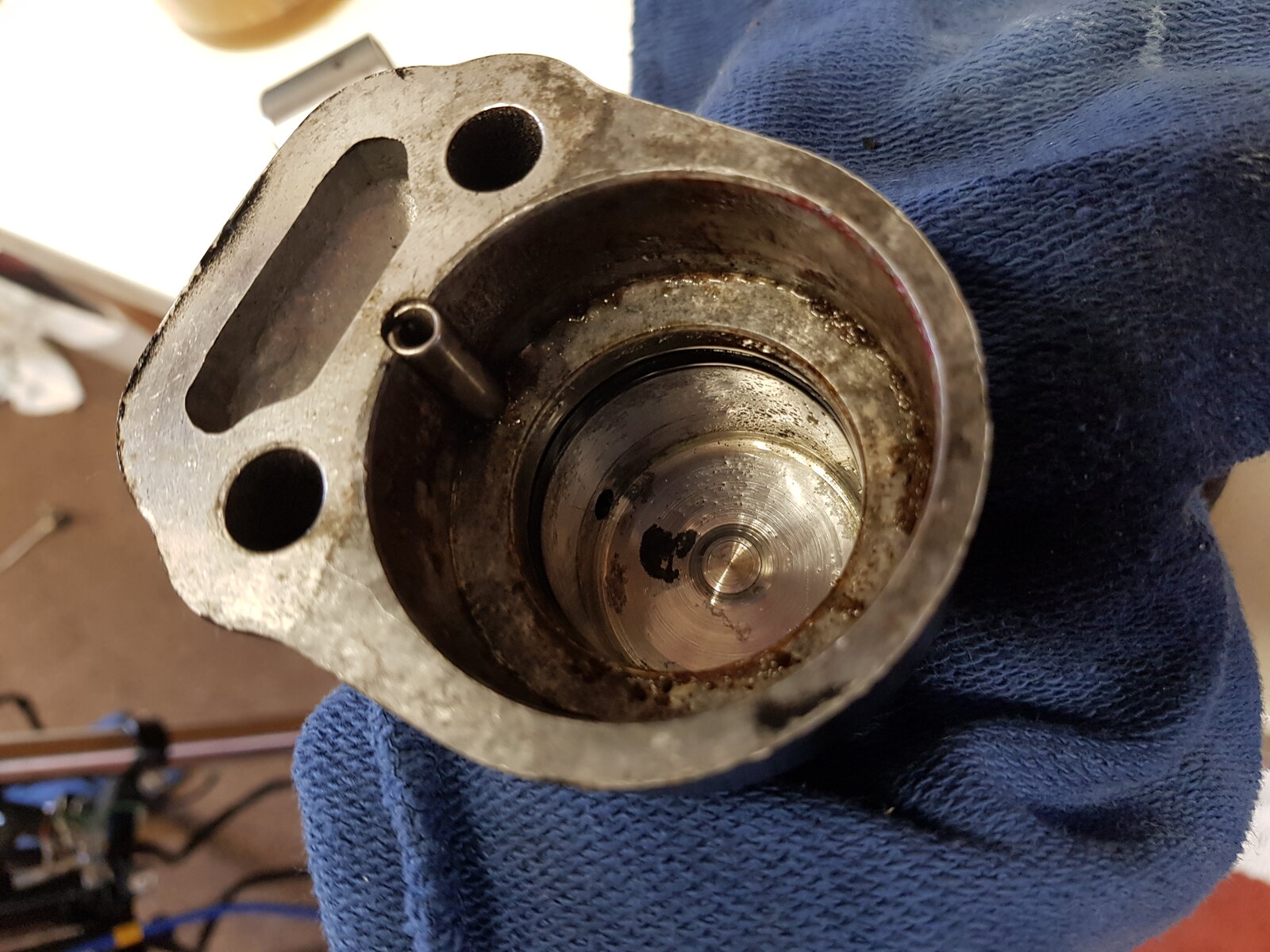

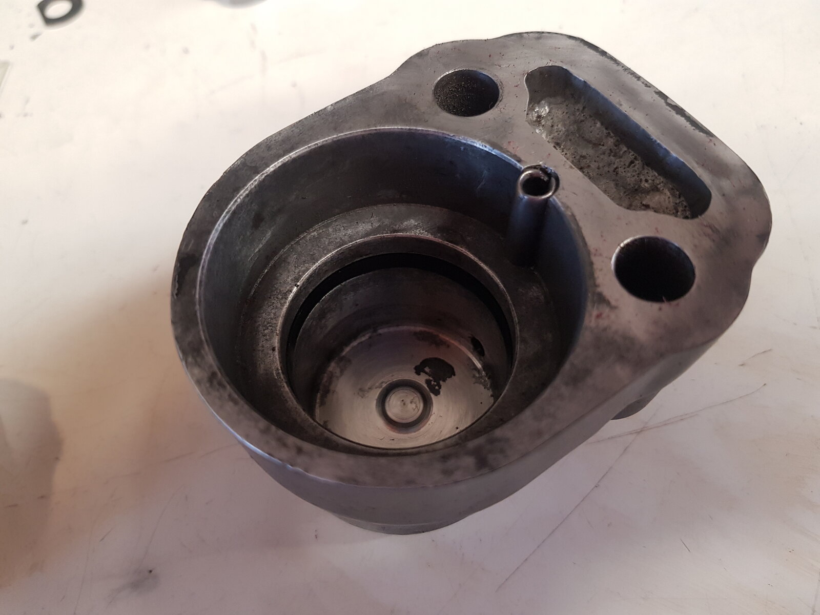

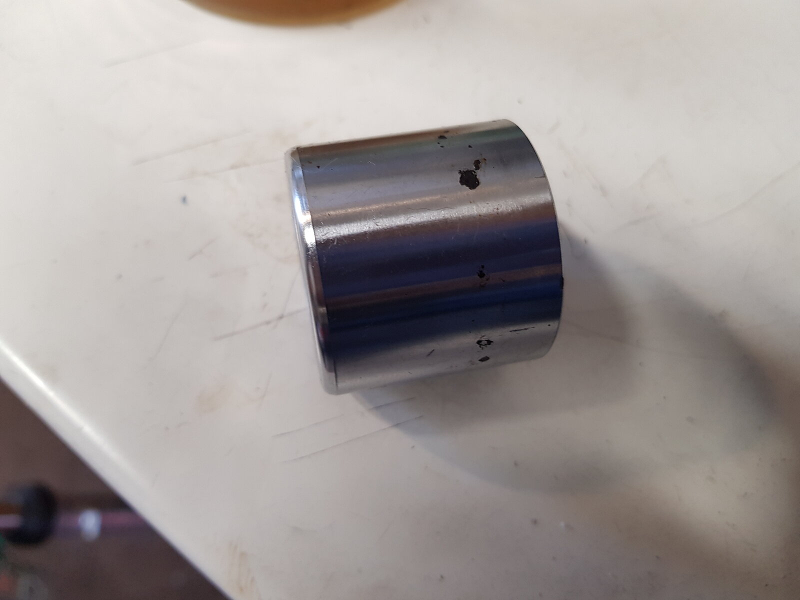

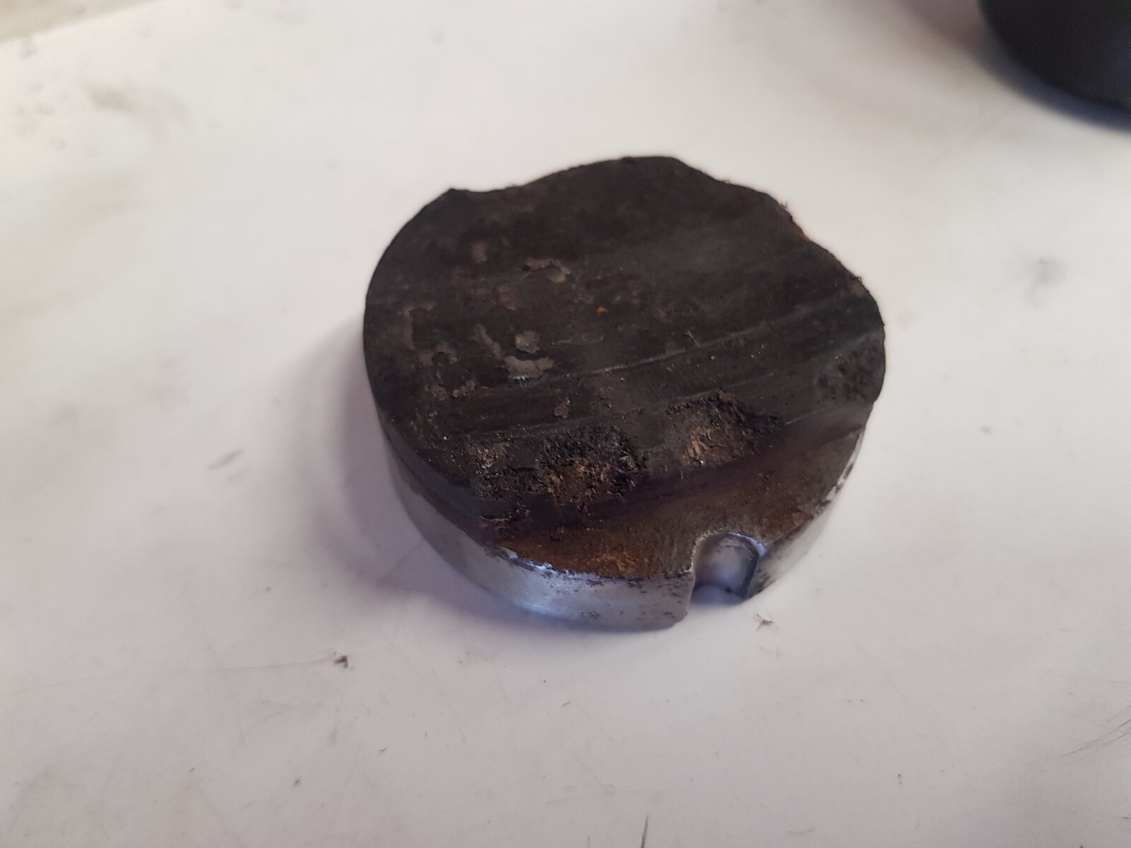

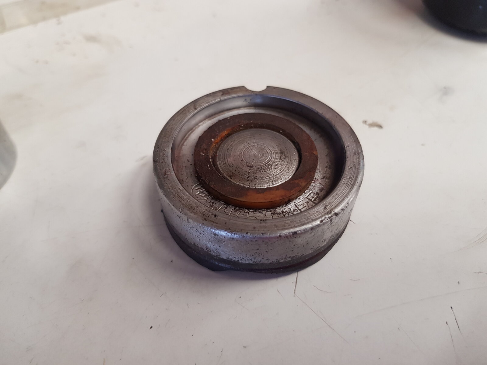

  11. Couple of hours in the garage today....had a spare brake like from the hyper which looks like itll fit the front of the 400/4....built the system back up and bled it. Once bled it was easy to push the pad out....
    1. Once the pad was out, i gave the whole lot a bit of scotchbrite treatment. The pad has got a fair bit of meat left on it so, once i gave it a going over with the wheel it dropped back in nice and easy so, im just going to reuse that. Theres a bit of corrosion around the piston so if i can find one i will replace but if i cant it should be ok as the corrosion is up around the top where it wont go back over the seal....all in all satisfied.

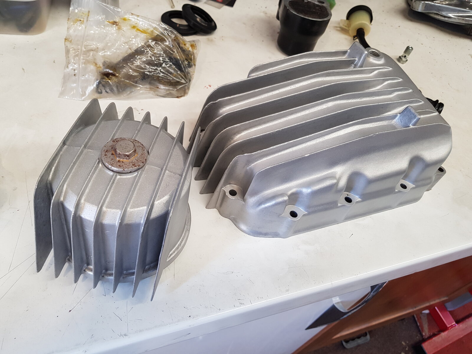

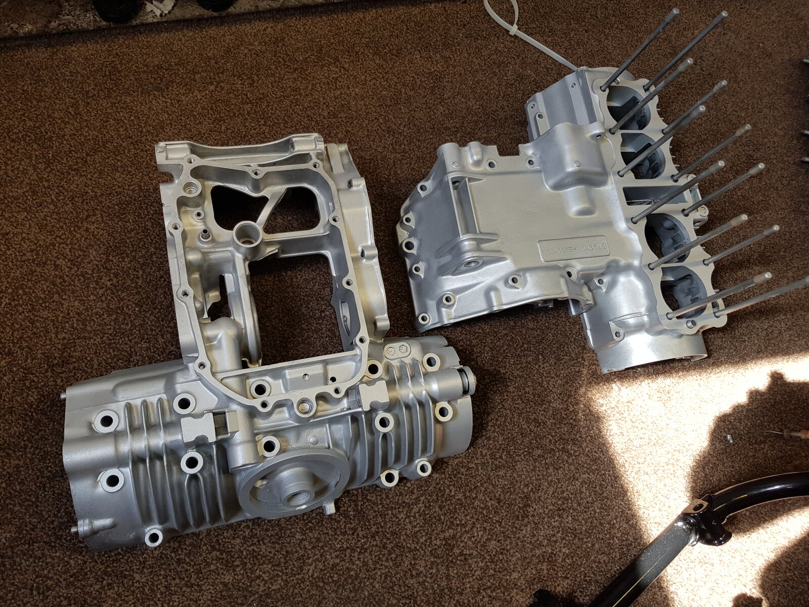

  13. Managed to find a piston and seal on ebay so just ordered. Ill be collecting the crankcases this week (been off at vapour blasting).
  14. Cases collected. Dropping more stuff up there today...
  15. Yeah and the guy said - "you wont need to cerakote them" the peened finish means that dirt wont stick to them...which was a first for me....i never knew that.!
