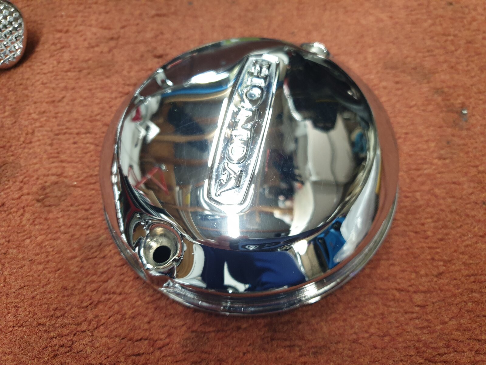

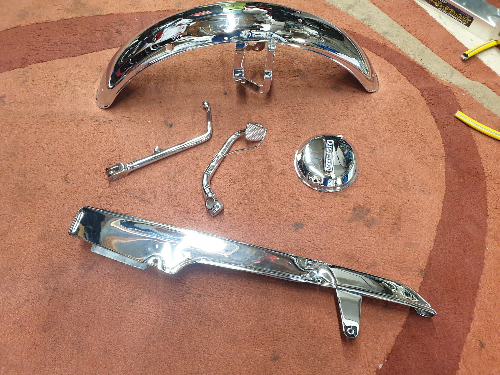

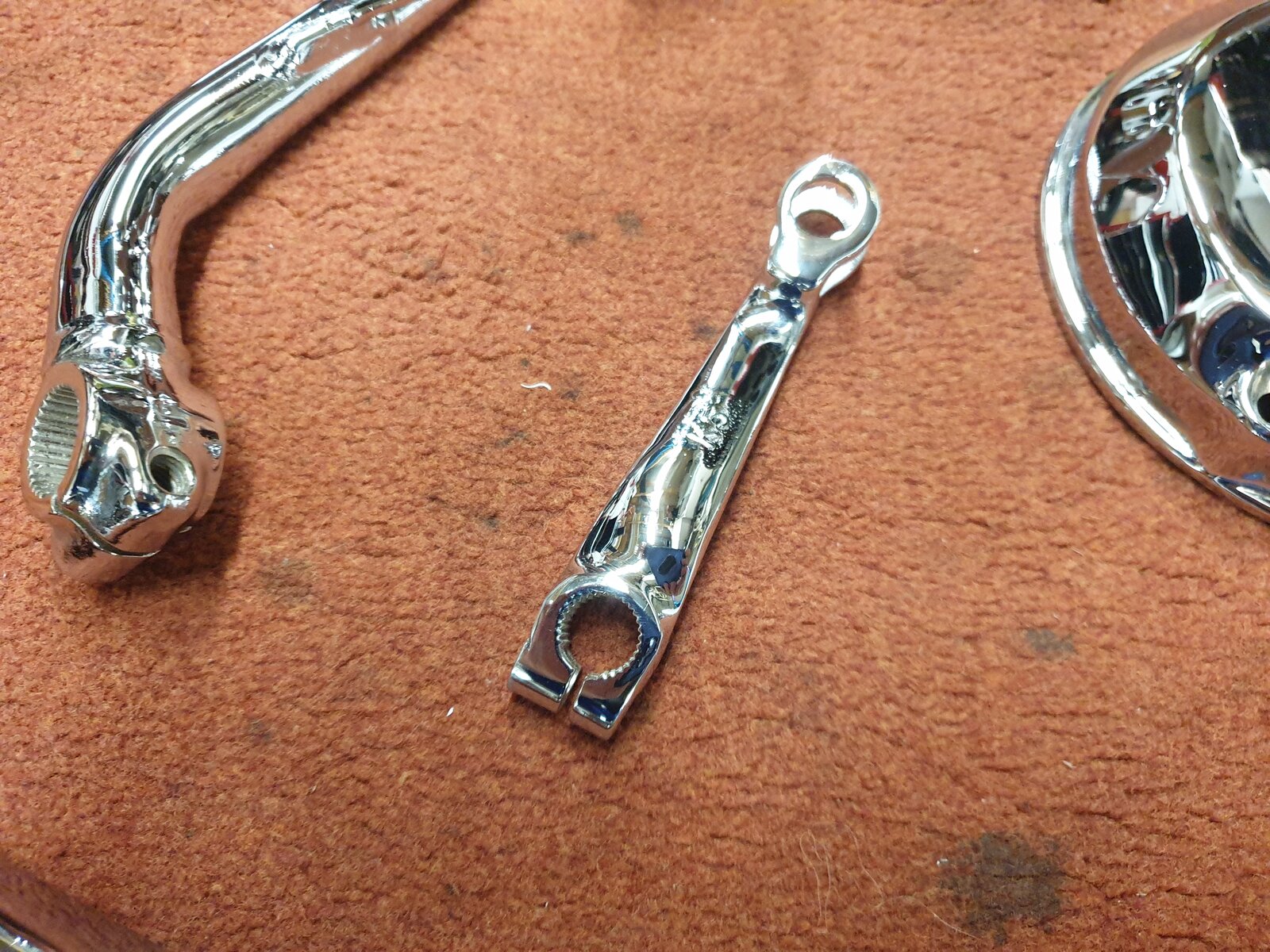

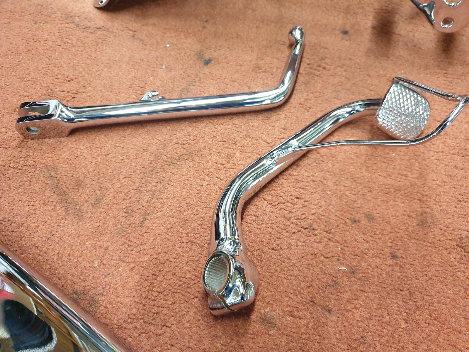

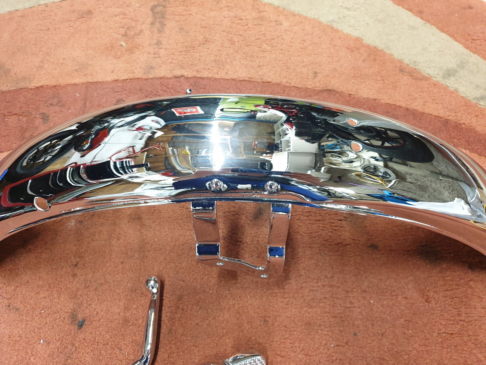

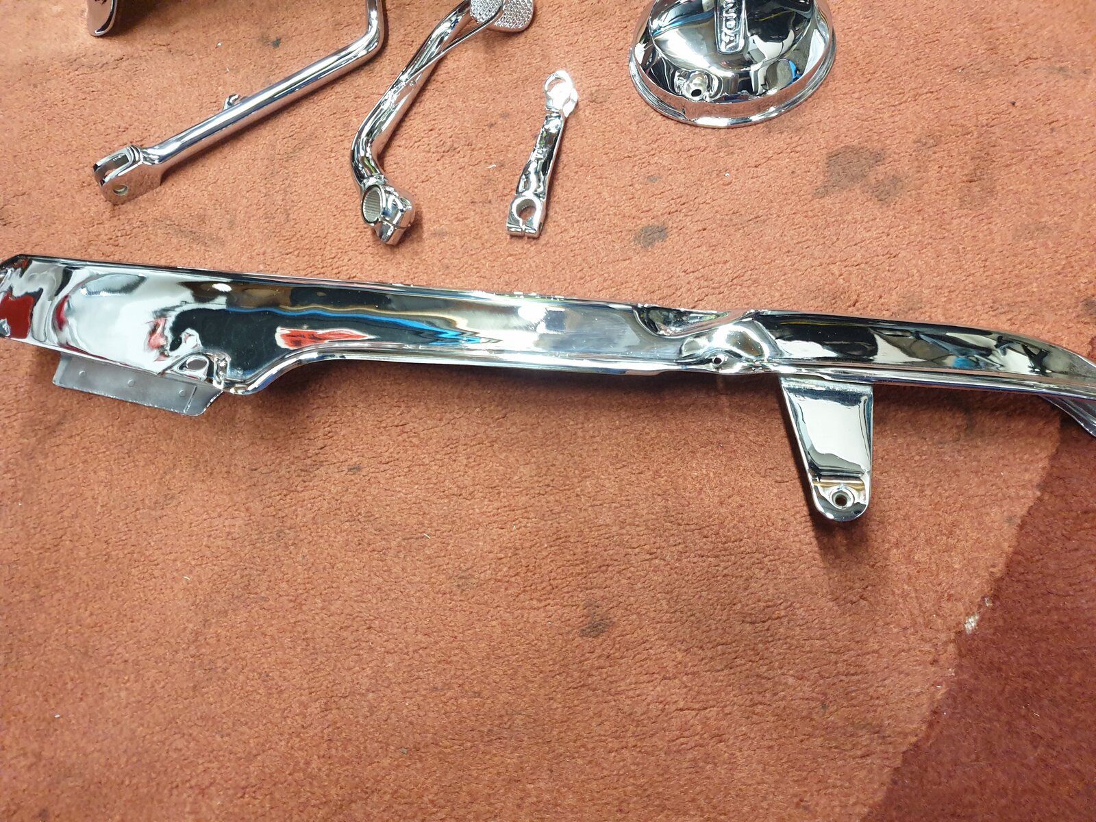

    First and foremost I've finally paid for the chrome plating 6 months later....
    20210105_175344.jpg 20210105_175338.jpg 20210105_175332.jpg 20210105_175317.jpg 20210105_175314.jpg 20210105_175309.jpg
    • Like Like x 11

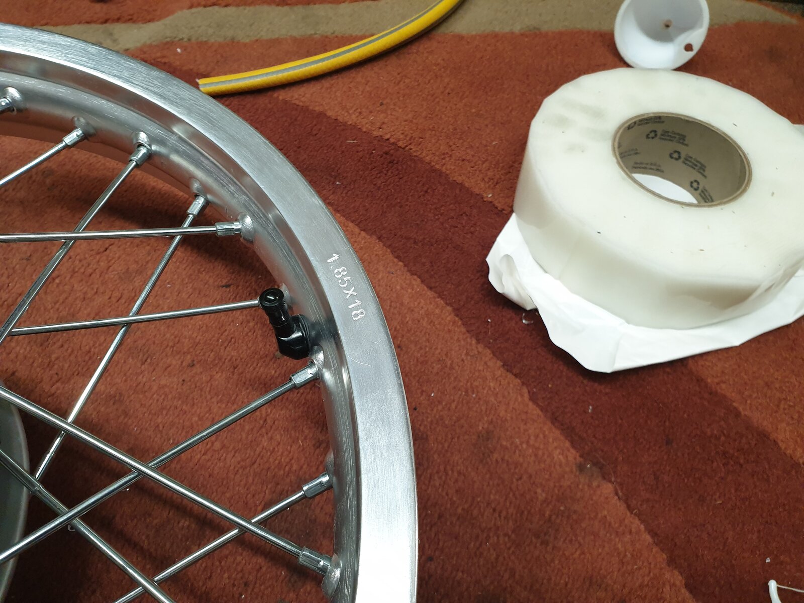

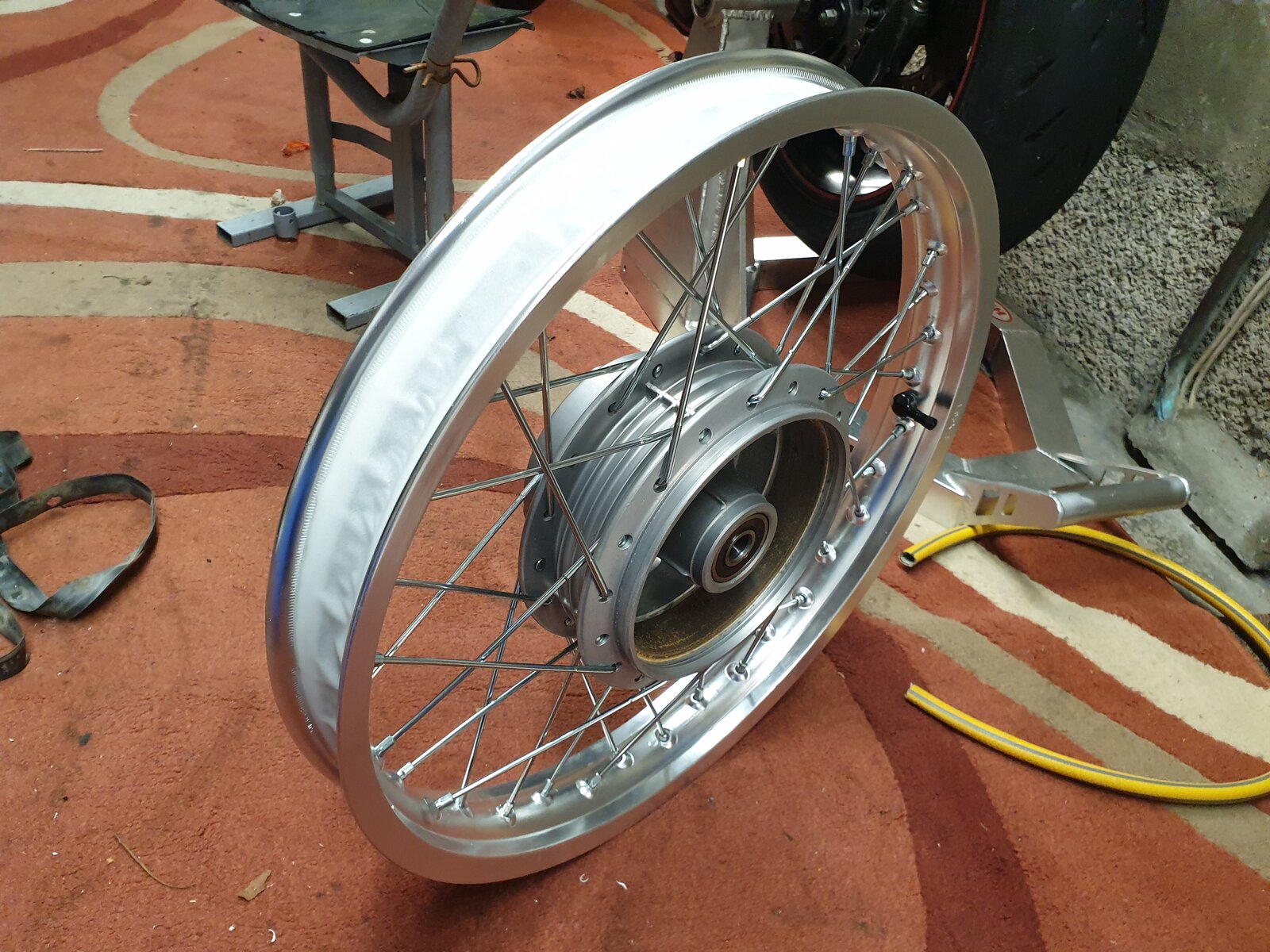

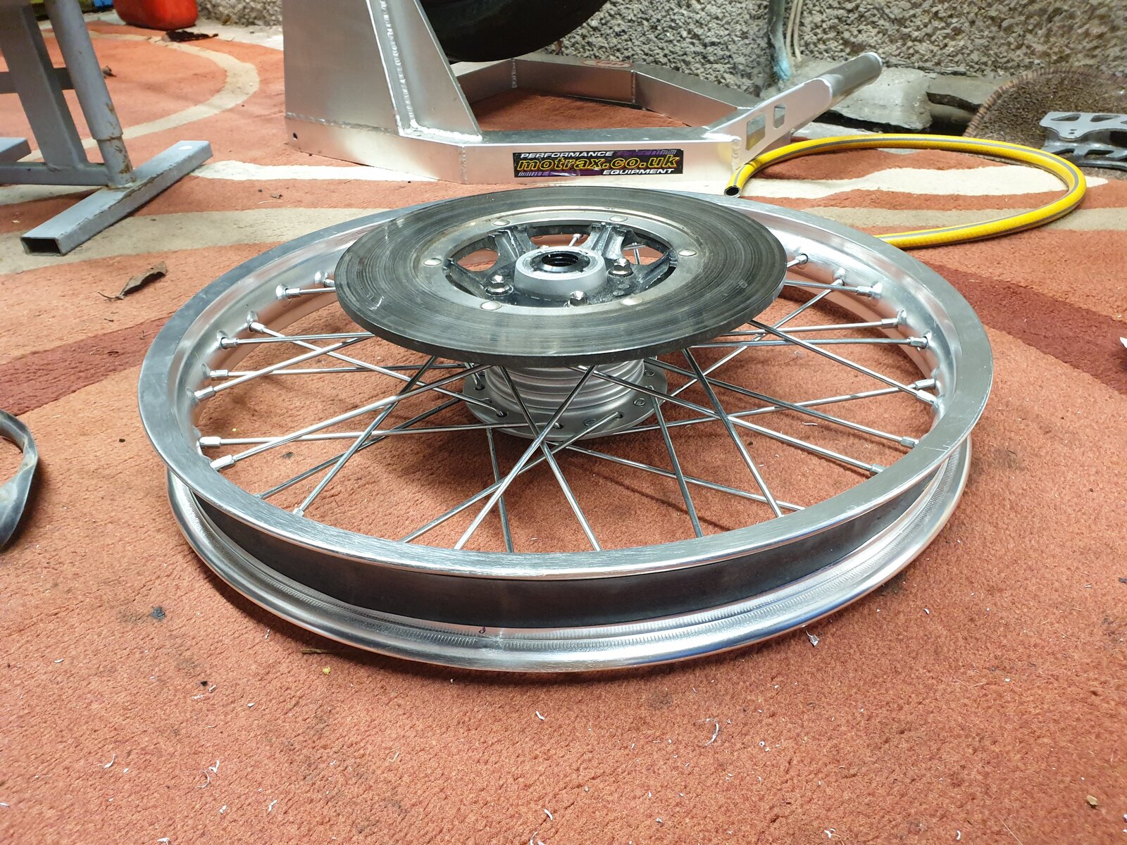

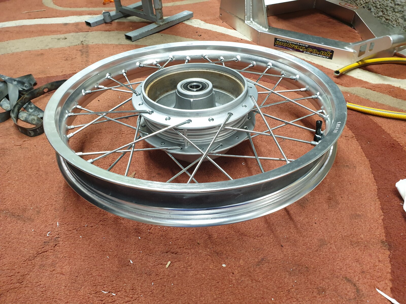

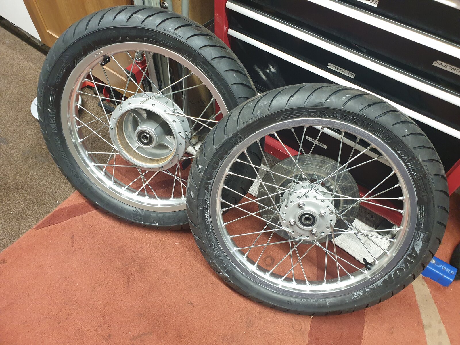

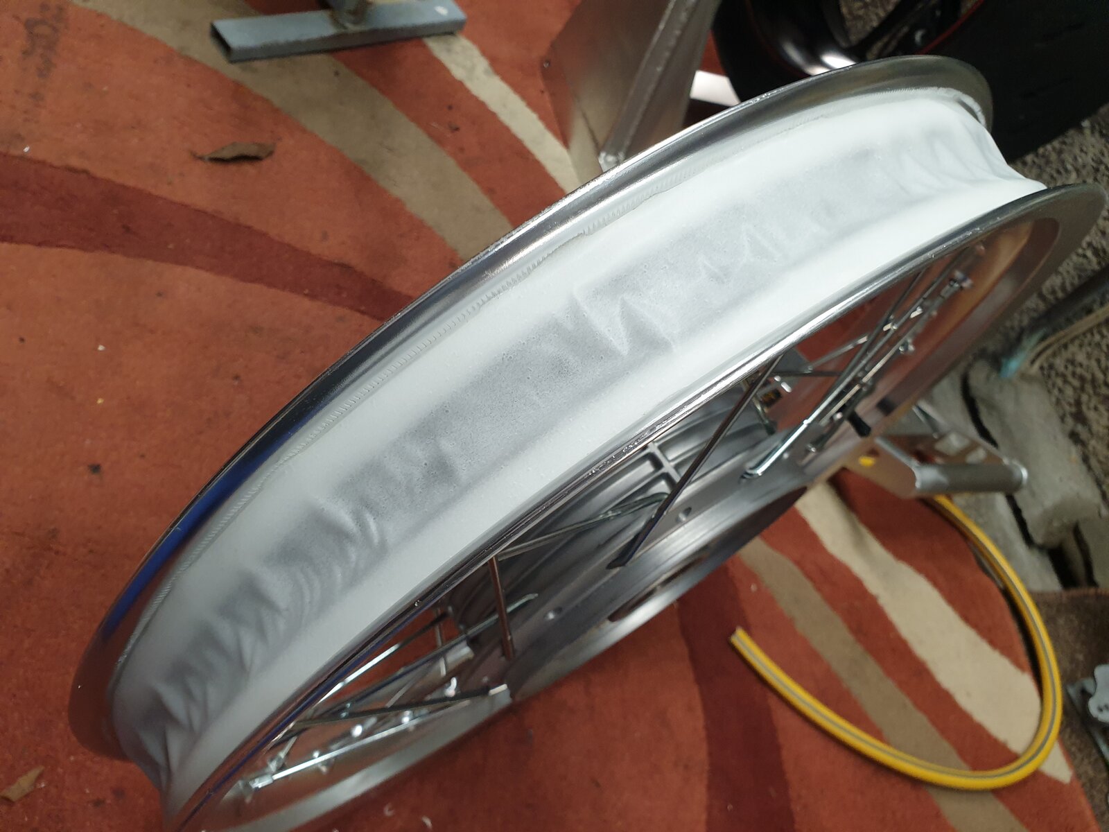

  5. Wheels taped up (hopefully should be able to convert to tubeless tyres). Thought I could get the tyres on with levers but... I'm not going to take the chance.... So taking them down tomorrow to get them fitted...
    20210105_174605.jpg 20210105_172925.jpg 20210105_172601.jpg 20210105_172552.jpg 20210105_172136.jpg 20210105_172128.jpg
    Hopefully I'll be able to, at last, get the wheels on, at the weekend...
    • Like Like x 8
  6. Might be worth putting something like the latex gloop or similar in the tyre to seal a small leak or two...
  7. I shouldnt need to - i sealed up the wheels on my 525 supermoto the same way (and i didnt use a rim band that time). Im not joking, it didnt leak any air whatsoever....The roll of tape is the stickiest stuff ever - wasnt cheap either (about 70 quid) - only way to see if it works is to try it....

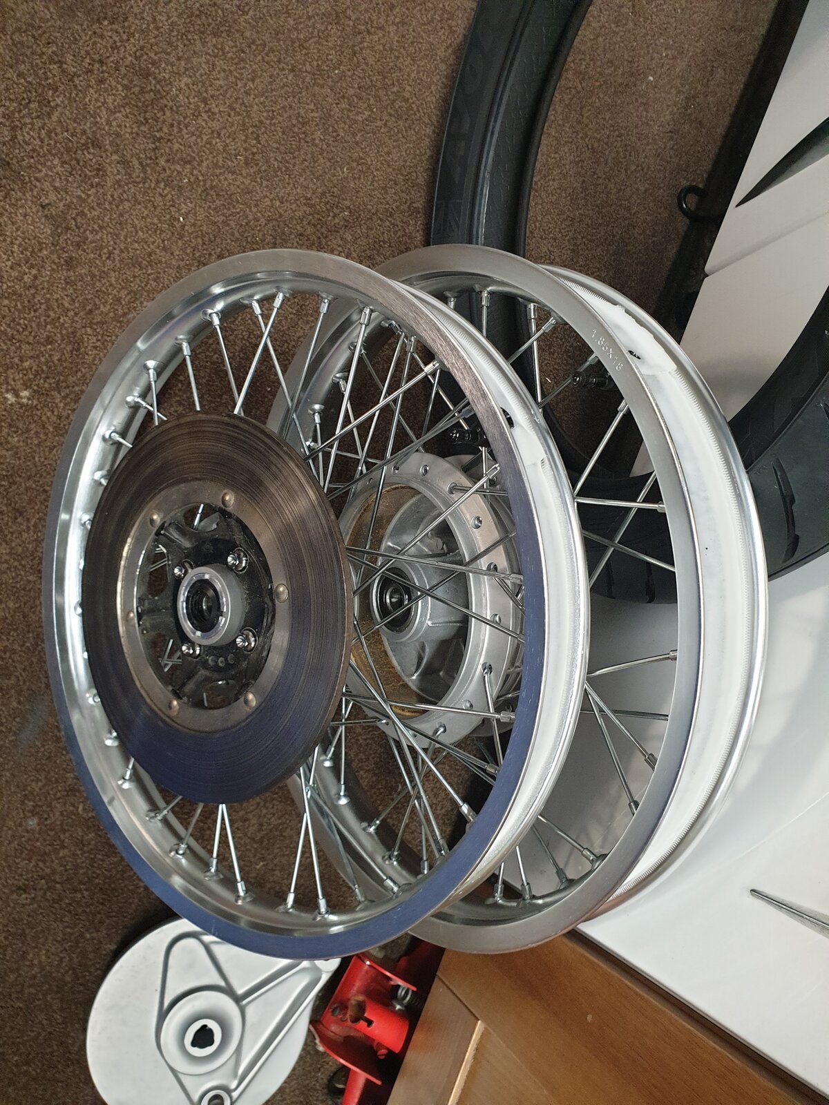

  8. Well... That was almost a project in its own right... Tyres on. Wheels finished... Will try to fit the weekend but I've got incoming DIY work coming in...
    Tape worked a treat again. Tyres are now tubeless...

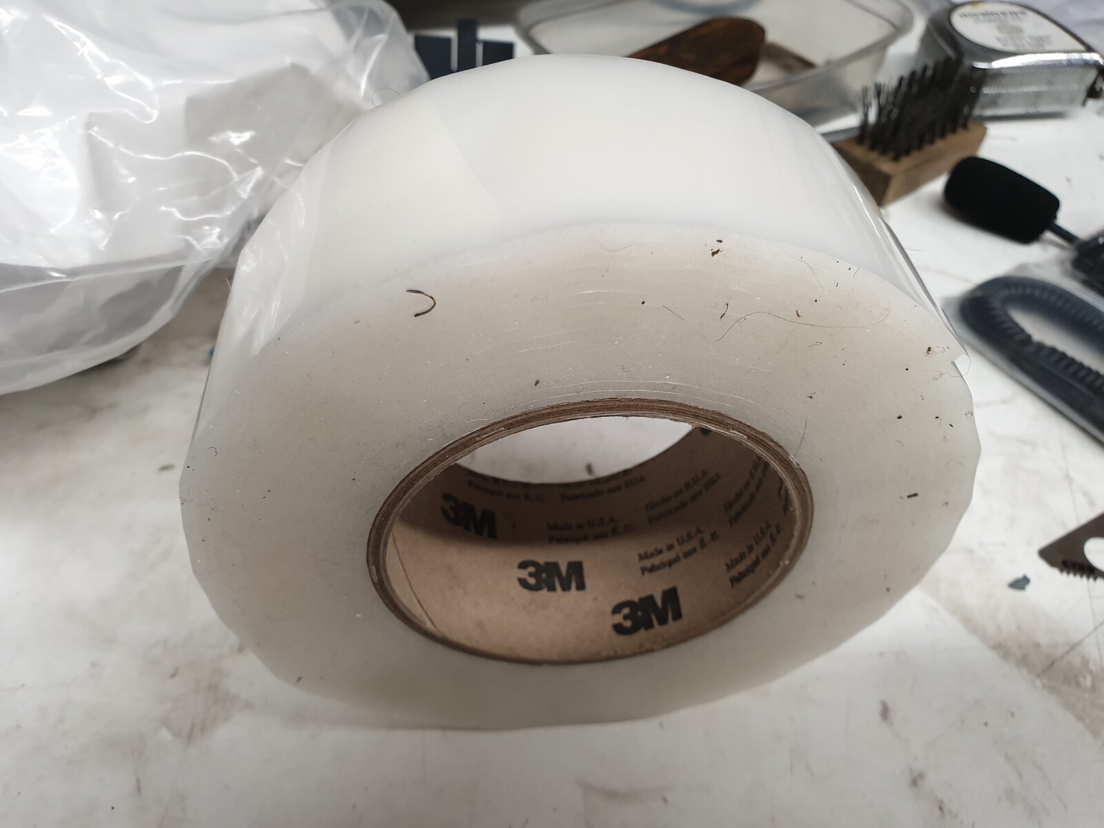

  9. What tape is it ?
  10. 3m stuff.... Its literally like a roll of glue... I'll see if I can find it... Bought on ebay... You can get different widths...
  11. Looking but can't see the exact stuff but here's a better pic...
  12. #313 Borgo Panigale, Jan 6, 2021
  13. Cool! - anyone used it?
  14. At only 33mms wide that'll surely be only suitable for mountain bike wheels?? Stan's is the system I used on my MTB wheels, so yes, used it and it's the business.
  15. my roll is 50mm wide, having said that to get the front wheel to seal i had to shave about 10mm off to get the tyre to seat....
  16. I looked into this subject in a fair amount of detail when I bought a pair of Sport Classic wheels for a project bike and only then discovered, to my great disappointment, that the SC spoked wheels are tubed. There are lots of approaches to doing this such as overlapping narrower tapes, as seen in the YouTube link below. This tape, however, is 65mm wide by 26 inches
    https://www.wiggle.co.uk/schwalbe-fat-bike-rim-tape
  17. I have also seen the conversions done with nothing more than bathroom silicone, albeit with extensive prep and cleaning! Each to their own....
  18. Well, my roll has done 4 bikes so far (Motorbikes) and its not failed yet....id say these wheels would be the same type of setup as your sport classic...

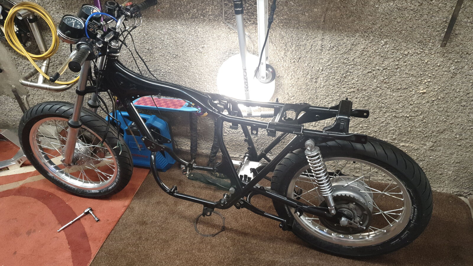

  19. Some movement at last... Literally in that it's on its wheels at last....
