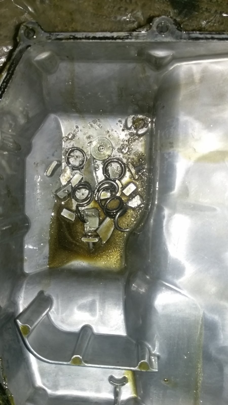

  1. Proper job then, but still ali bits to contend with ?
  3. Just seen the photos now and see what you mean, looks nasty.
  4. Not sure how the oil pumps on the Honda but I would be cutting the oil filer to see how far the bits have traveled , guessing it's a canister filter.
  5. i think it goes up from the sump through a oil strainer then through the oil filter cartridge. Strainer coming out over the weekend. Had a look inside the filter (didn't cut it open) and can't see anything.
