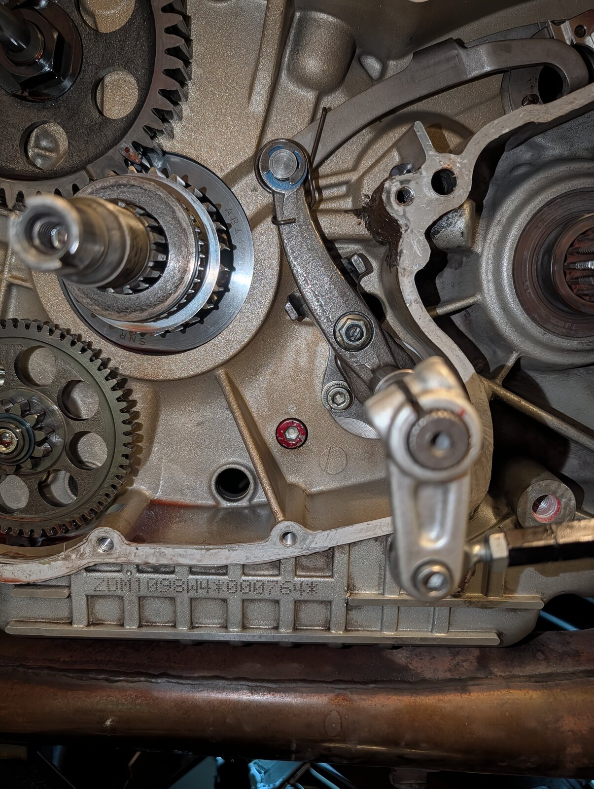

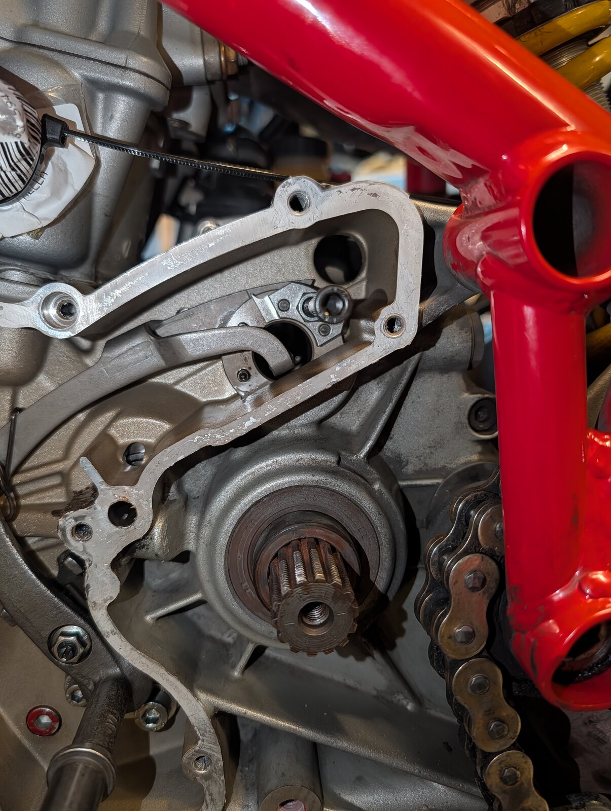

    I have refreshed all the part except the back plate. New springs, fork arm etc.
    I used a micrometer to get the arm in the middle lik in desmo werx video. Got them really close, like 9.55mm and 9.50mm on the other side. If I trust my micrometer that is.
    As seen in picture I have aligned the selector fork with the arm and tighten it.
    Still got the same issue. Unless I really push the gear leaver really hard and some times even then I end up between gears. I can see how the drum some times stops between gears and sometimes in falls into the right position, other times not.

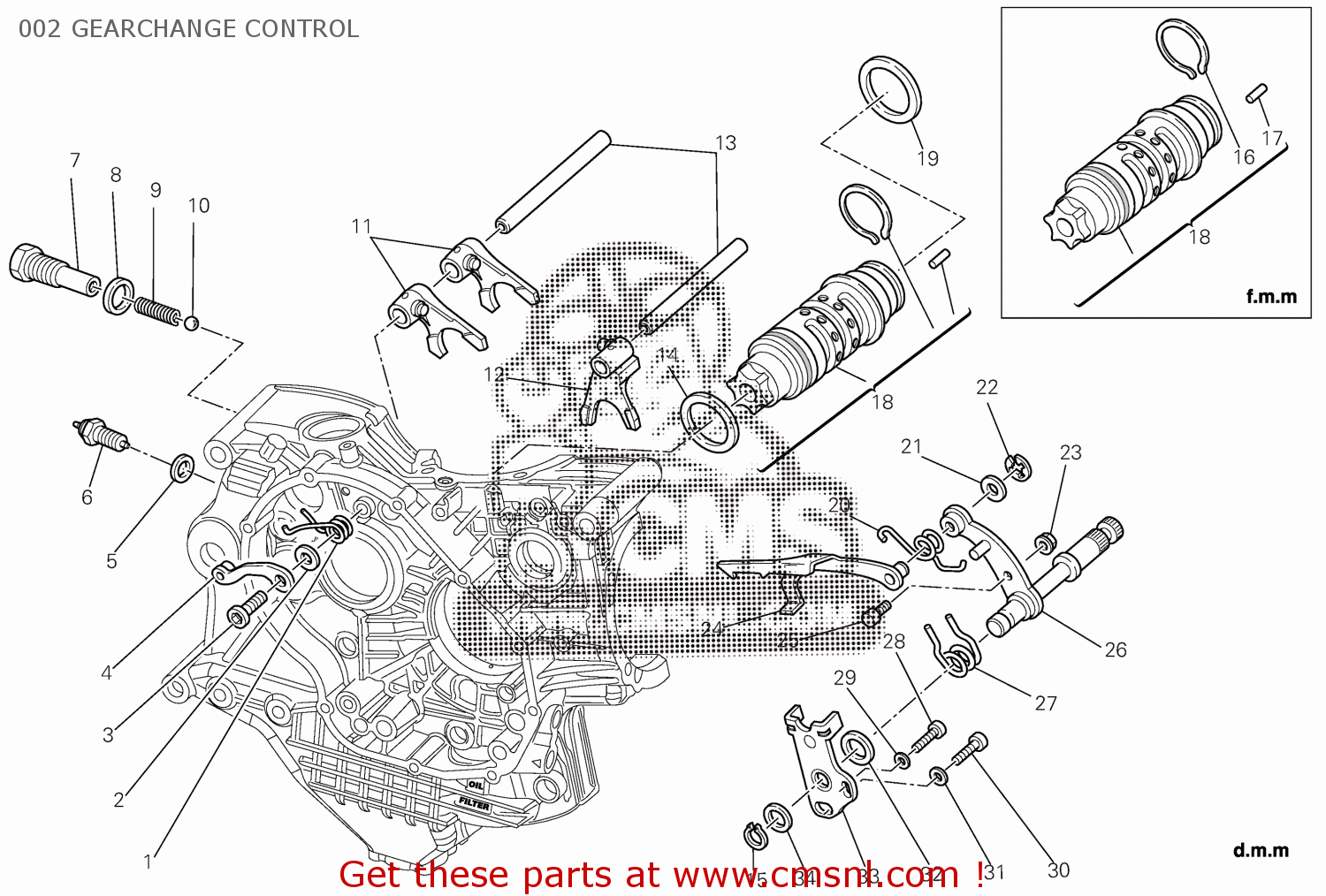

    What would be the next step? Could it have something to do with part 1 - 4 and 7-10 in parts diagram?

  8. The ending up between gears is a new thing. The bike have never done that before. That's why I disassemble it in the first place. So the work on the selector claw did nothing.

    Tried that as well. The fork is in the center. Even though i roll the rear wheel same issue occurs. It's like something inside is slipping or not grabbing so the drum ends up in between gears.
    I've started to remove panels, gas tank etc.
    Question, does anyone now I I need to remove the throttle body or can it stay in position and I just lower the engine?
