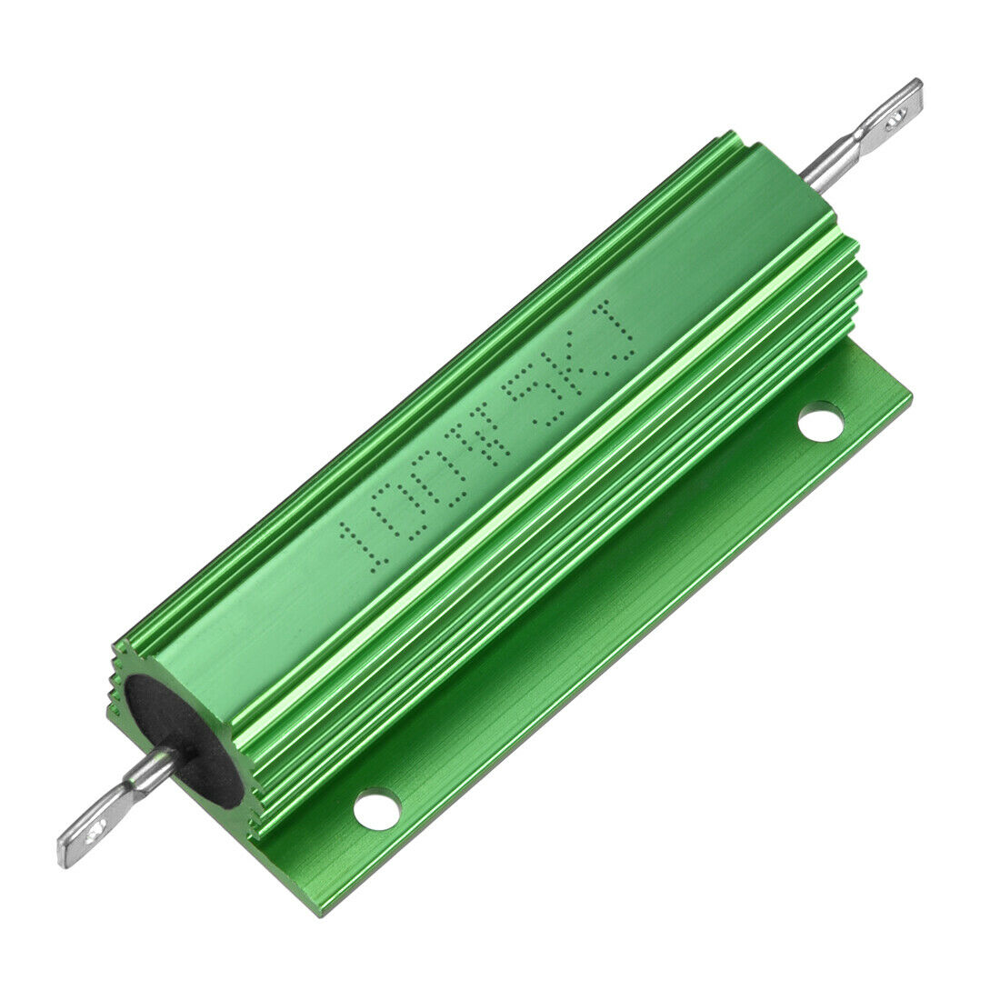

    A better way would be to use a high wattage, low Ohms resistor...
    I've got a switchable 0.2 to 8 Ohm load board.....
    Can dissipate 500W with a fan.... more for short durations.
    Put that in series and measure the volts drop across it..
