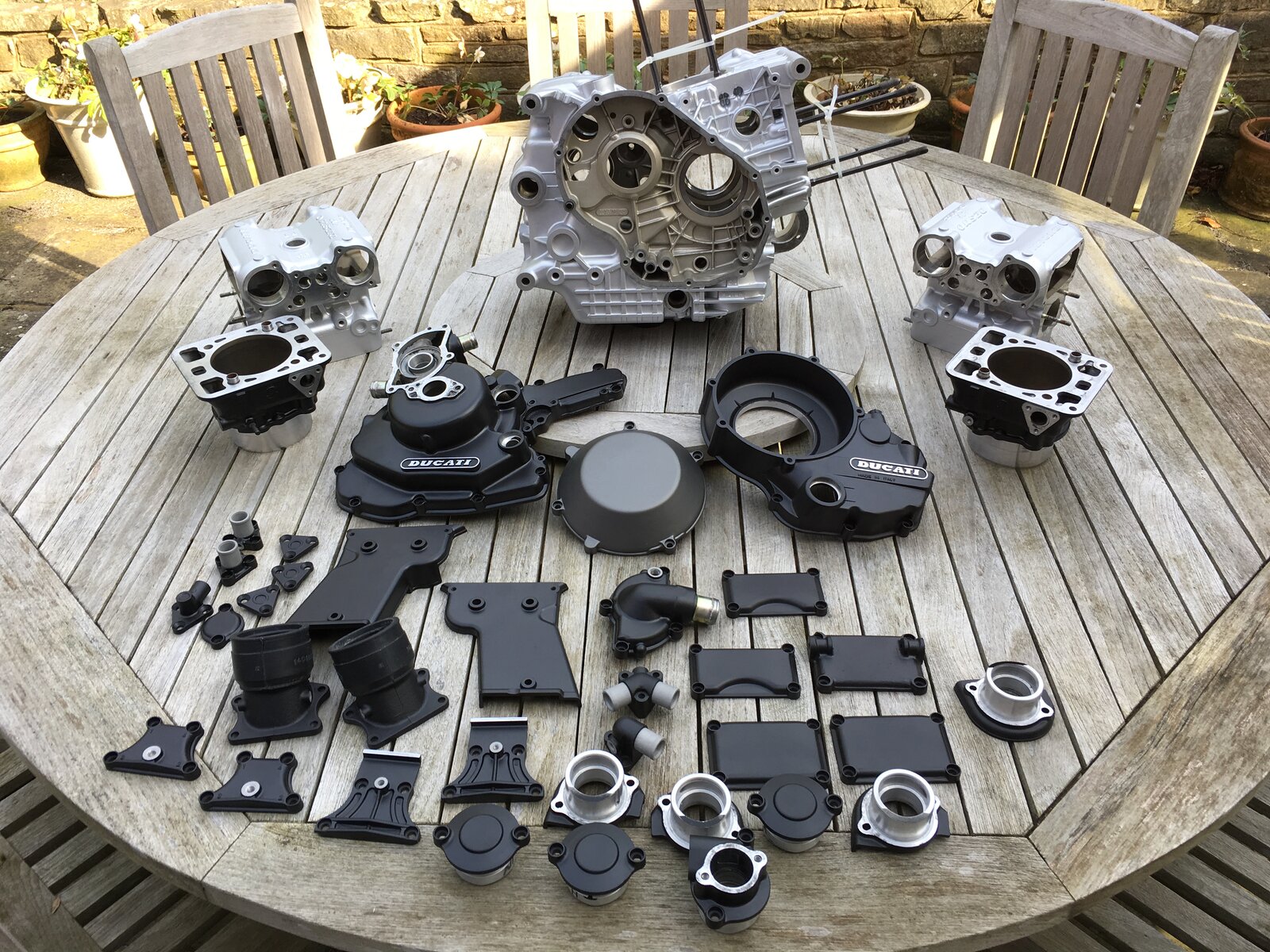

  1. Here are my 888 cases Cerakoted......lovely job and super hard wearing.
  2. It does on the left hand (I am a righty) I cant explain everywhere the right hand goes...
    Badumpbump! Tsssscchh!!
    Rex
  3. Great share, at what cost & who through please.
  4. Looks good.
  5. Speak with Wesley who runs the place. Last time I was there, he was pretty busy with commercial work, but has done multiple bike engines and pipes. Last time it was around £600 cash, but that was a couple of years back.
