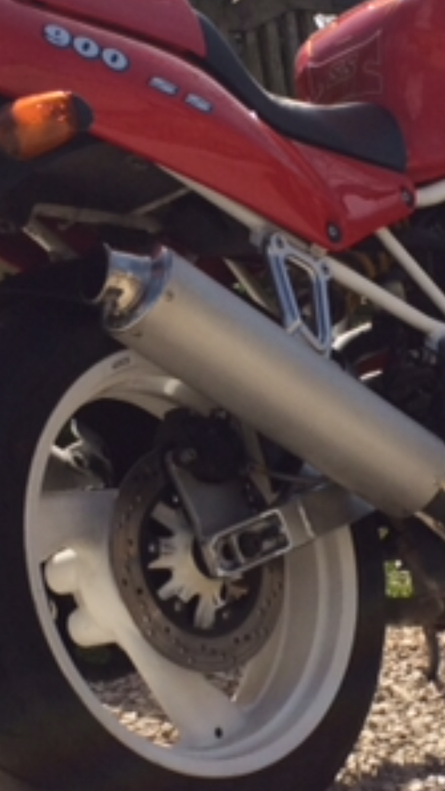

  1. My 900ss rear brake is pathetic, a Ducati specialist said they are not very good so I’ve never really bothered with trying to improve it other than bleeding it when I first got the bike, but I’m thinking it may need a bit more attention, it’s so poor I doubt it would lock the back wheel at 10mph, how good is yours?.
