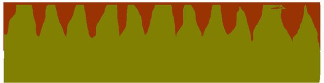

    Above are cross sections of a cylinder bore.
    What you want is the second image. The bore has been 'plateaued' either by the factory or by the rider correctly seating in the piston rings. The oil sits in the troughs to lubricate the piston rings.
    The third and fourth images are bore glazing and bore polishing respectively. Both are caused by excessive light loading of an engine during running in.
    As can be seen there's nowhere for the oil to sit. With a glazed bore a varnished layer covers the troughs and with a polished bore the troughs are worn away.
    Neither is good and both will lead to excessive oil consumption.
