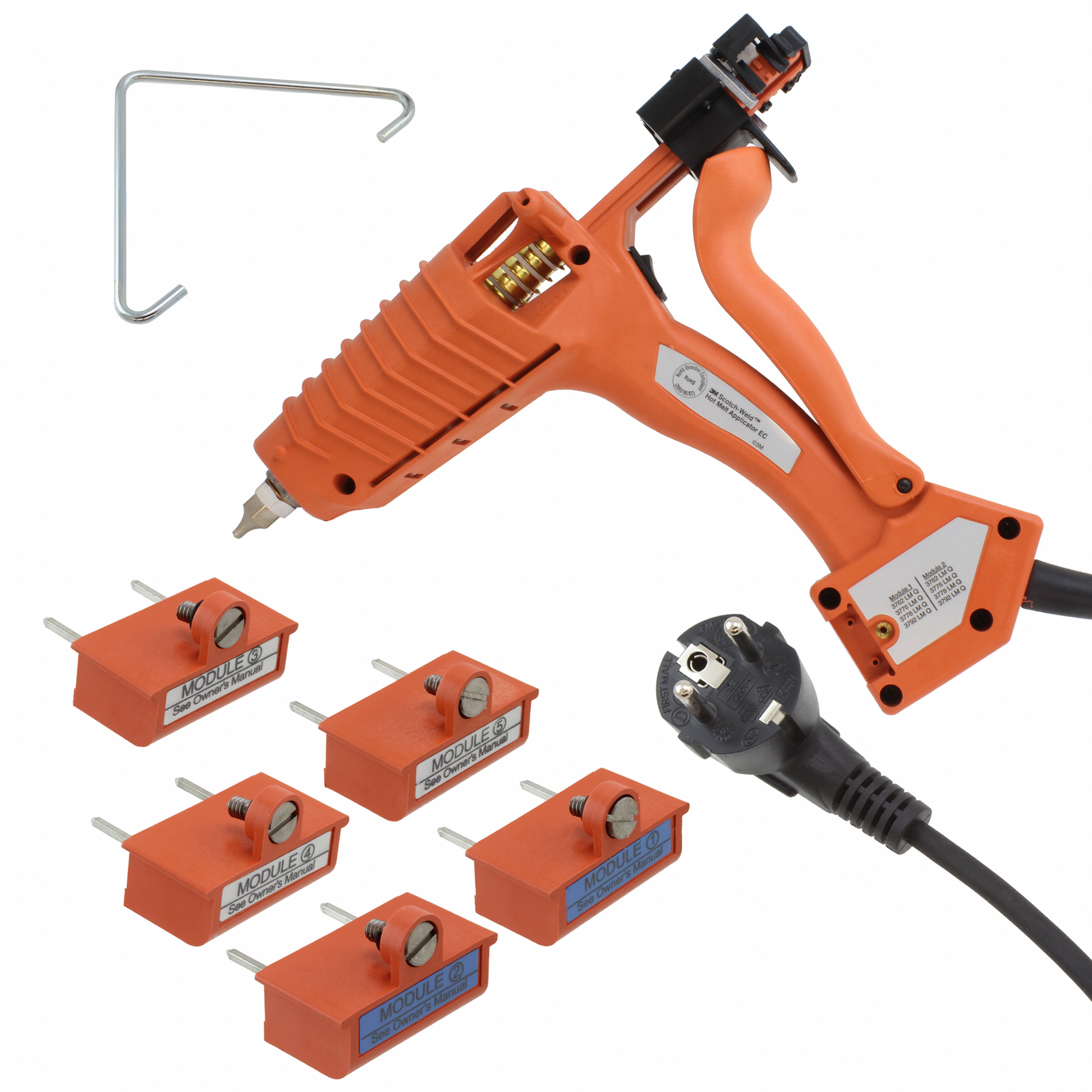

An industrial heat gun, 3M Scottish-weld hot melt applicator EC. I used 3748Q glue sticks & module 4 for that job...so yes I do remember Got it from vikingtapes its wince type money including value-added-theft. @oldtech Could be done with a number of simple epoxy glues frankly. My next version of that will tilt & have ability to raise & decend because my two bikes have chains on opposite sides.
@GunZenBomZ Thank you for the info Some of those specialized 3M adhesive products are incredible . I'm going to try Sikaflex . Motorhomers love it .... eg. for attaching solar panel brackets to the vehicle roof . I want something that has high strength but doesn't go brittle with age , so epoxy is less suitable ... ... I think ...
Thanks ..... yeah , not cheap ! What do the modules do ? I looked at the data sheet on the website but still none-the-wiser .... ..... different heaters for different sticks ?
