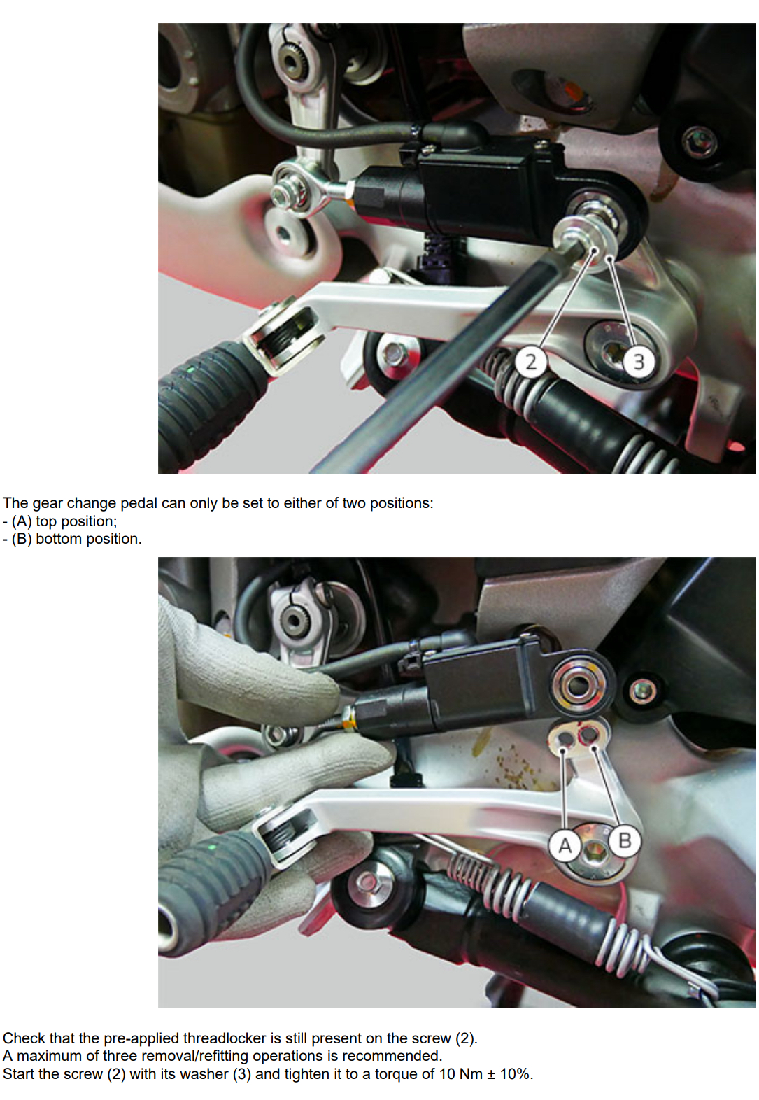

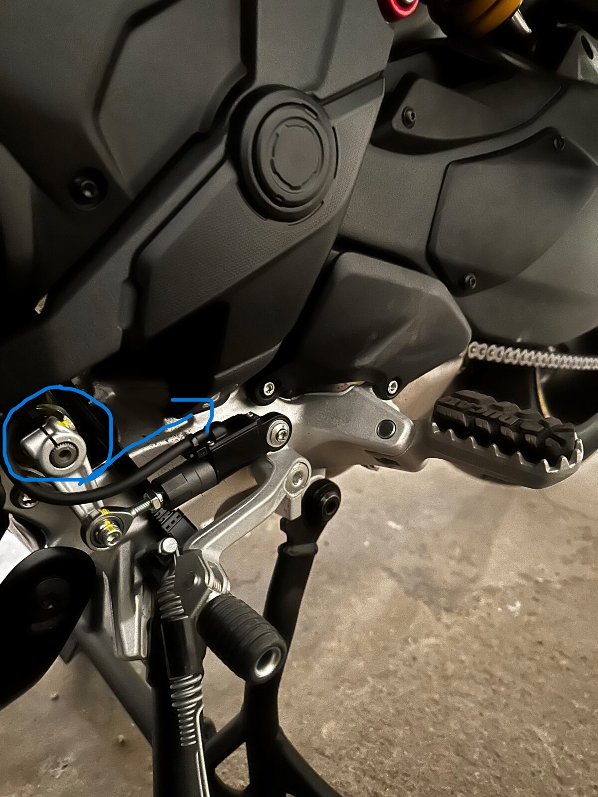

  6. Do you mean like in the picture?
    It would be fantastic if it works without damaging anything or affecting other settings. Are you sure about it?
  7. Exactly that.
    See the punch marks? If you do adjust it and it doesn’t work, you can easily revert back to the factory setting.
  8. If the lever needs to move up, the arm should go anti-clockwise.
  9. As @gc6269 said, moving the arm on the splines is the simplest way and I also did this on all my Multi's. Even just a single spline either side of where it's currently set now is a big difference.

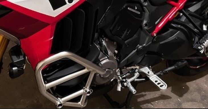

  17. I fitted the Vario ones, very similar. It’s worth fitting the extend gear lever as well

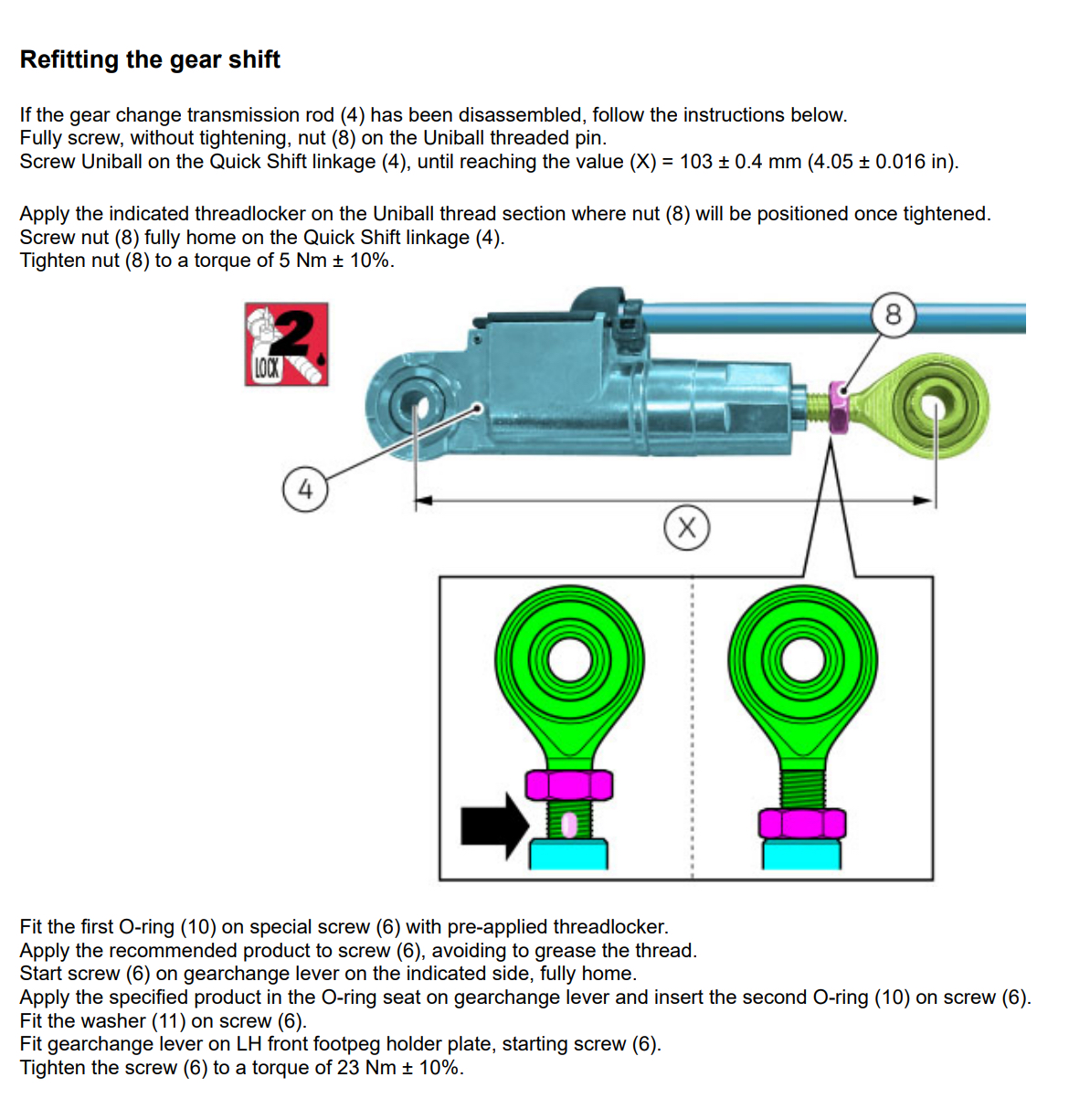

  18. I took a look at the Service Manual.
    Take a look here:
  19. By service manual, positions can be very critical. Take a look at the spec below, it is about +/- 0,4 mm
