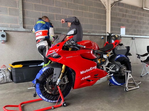

    Above ridden by Micheal Neeves for a MCN article, This particular bike is the brainchild of a friend of mine for his dissertation project based around measuring steering (torque) input for a bike.
    So I have quite alot of data on the bike and what a Panigale does around a racetrack, not just dynamically but also electronically. Which leads me onto the next part of the project, I'd really like to have advanced rider aids on this project. Partly because I'm not Dovi and partly as its something I haven't really jumped into too much. Ideally Motec M130 if I can find one with a package for a Ducati, I contacted them and they currently don't! Or the highest level of standard stuff I can find, the standard bike as you are probably aware is already very sophisticated. Its just not easy to modify.

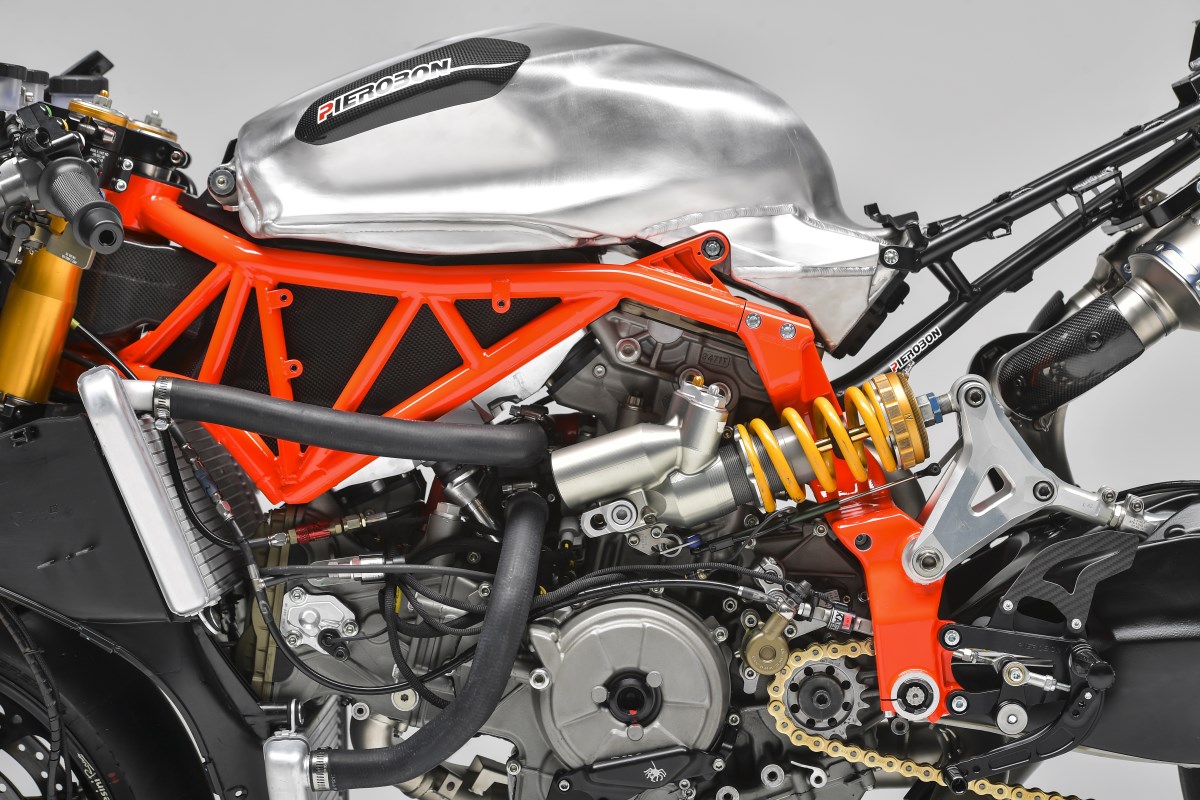

    1 - a steel alternative similar to that of Pierobons X85R
    2 - Similar to above, except using silicon bronze brazing rather than 'regular' tig
    3 - An aluminium
    4 - A Titanium one, This will really depend on how cheaply I can get the headstock machined. I'm not holding my breath.
    MC7_3343-1.jpg (Pierobon X85R - https://www.pierobonframes.com/en/product/panigale-v2-899-959-1199-1299-trellis-frame/)

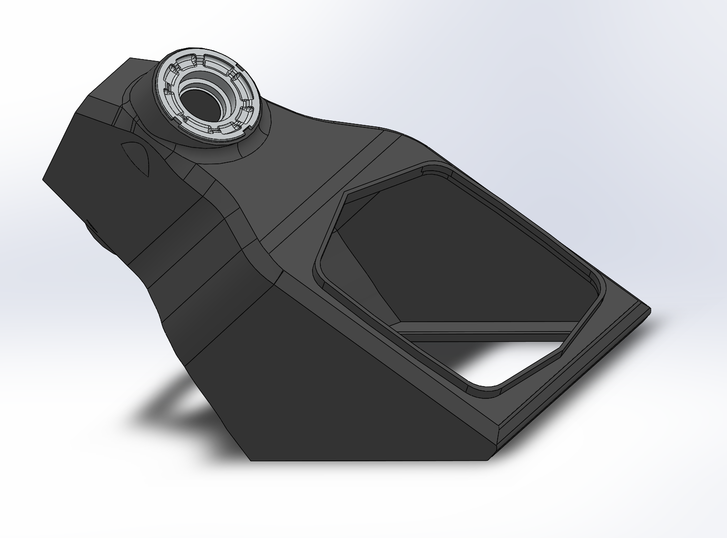

    I started with making a very basic cad model of the chassis that isn't very accurate;

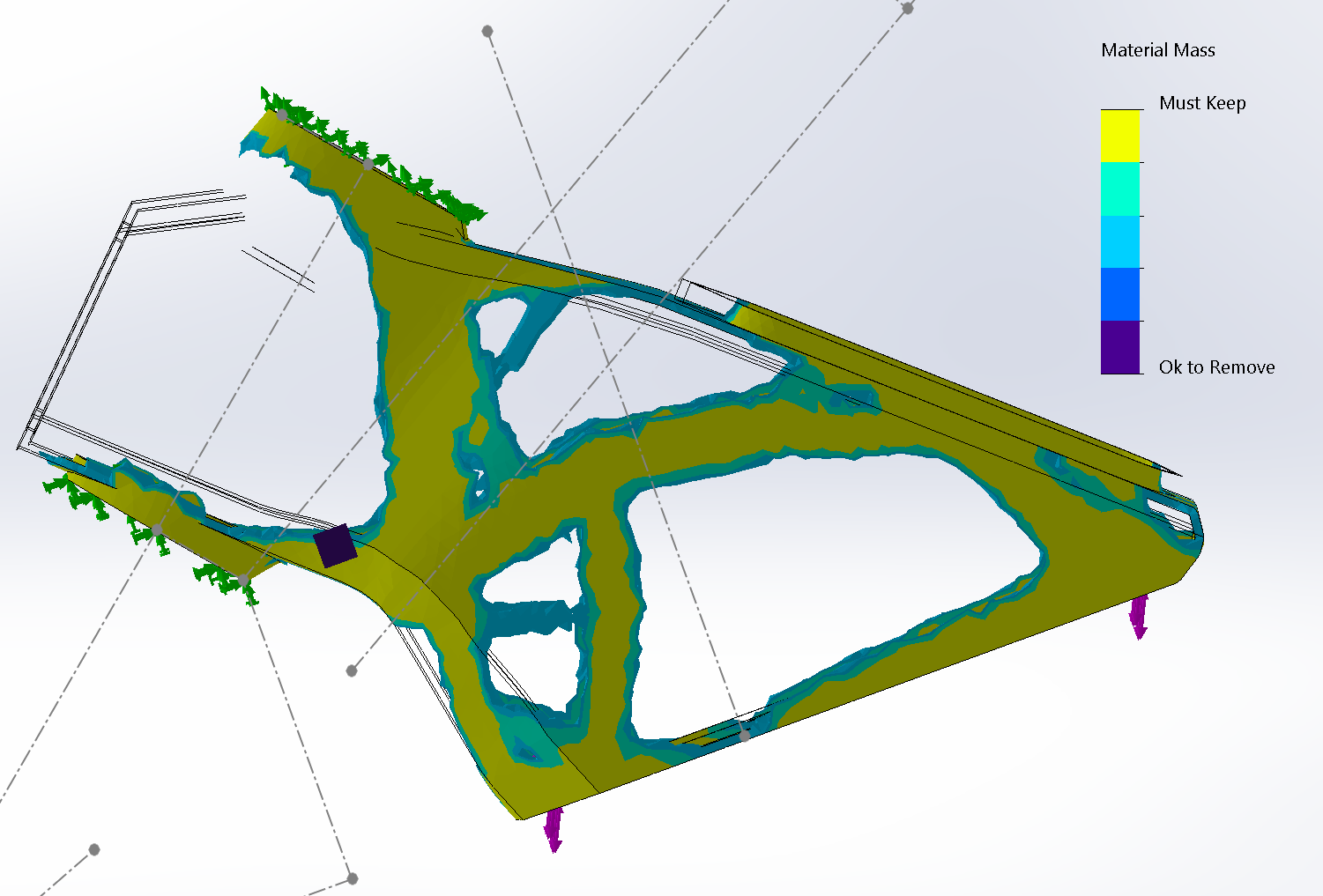

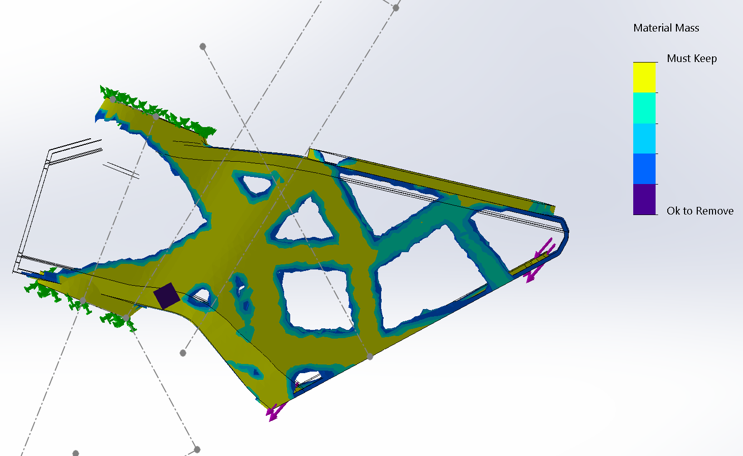

    I would need a 3D scanner to make an accurate enough model to get decent results from FEA simulations, but I knew i was going to be able to get one of those so, and I wasn't planning any FEA on this model. I needed it for topology optimization, for those that get scared by those words.. its quite simple. You essentially tell the software to make the model able to withstand a certain load (forces involved with braking for instance), You then tell it to remove all under stressed matierial to save weight. You end up with a model that looks like this; brake test 1.PNG
    The above shows a rough estimate of the matierial needed to support a 1199s under maximum braking load, and the below model shows the same however supporting torsional loads; torsion 1.PNG
    You're probably wondering the same as me, absolutely no chance willl the frame survive anything with all that matierial removed from the headstock. My mind was completely changed after I seen one of Suzuki's published papers on the redesign of their motoGP bike frame, which is exactly that! (i don't really want to post pictures as im not sure if its allowed, heres the link (https://www.sae.org/publications/technical-papers/content/2015-32-0839/)).

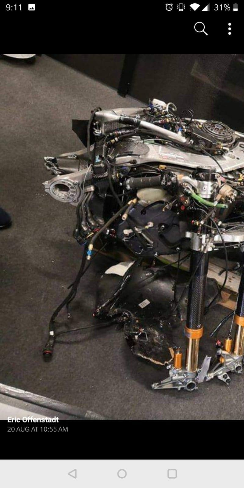

    But I can show you this crashed GP19!;
    And you can clearly see the lack of matierial in that area.... Topology optimization proved correct! So my plan is the use those 'load paths' from the topologically optimized chassis (look at me with the big words!) to design a trellis chassis, Thats my plan for the next couple weeks, not really started yet!

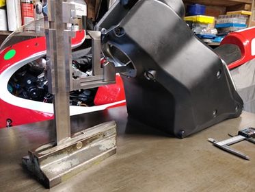

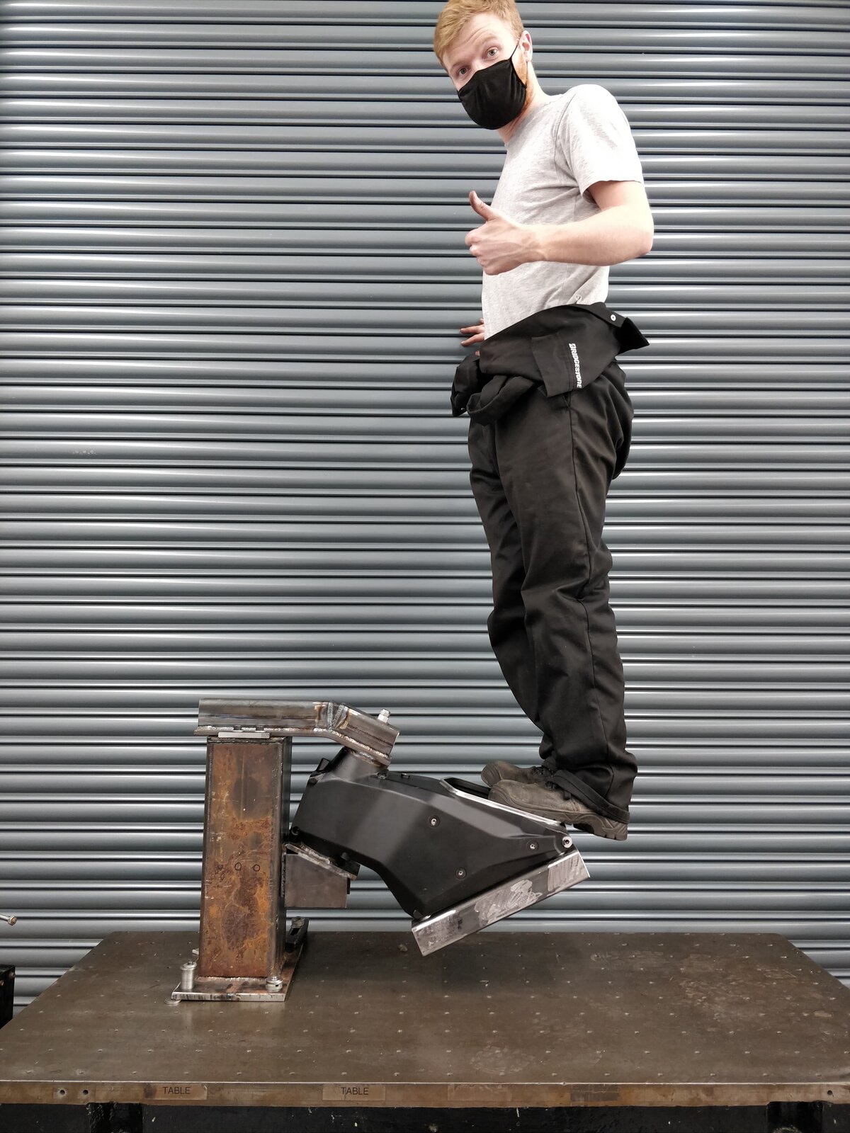

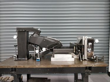

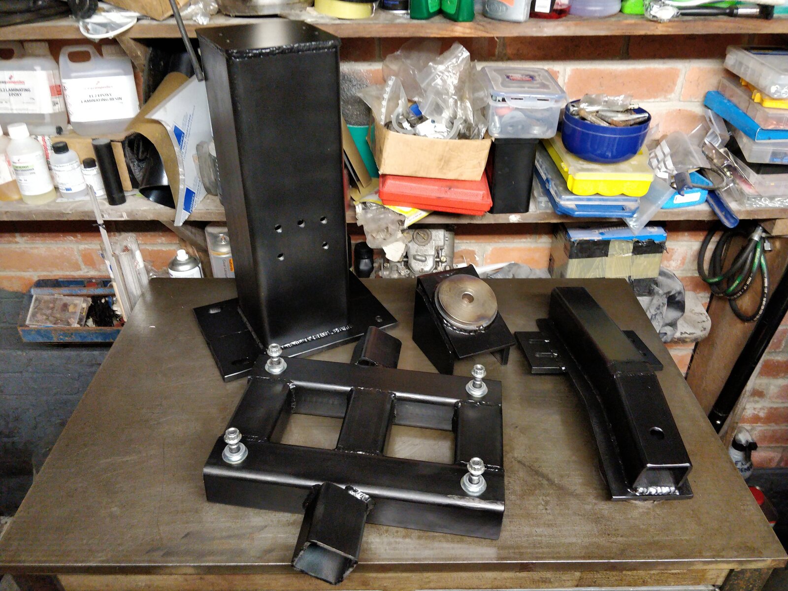

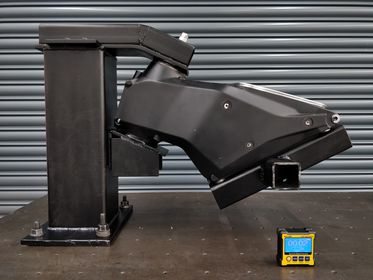

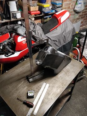

    What I have started is measuring the stiffness of the frame. I started by making a jig to lock the headstock completely; 126346166_834173437371945_7591683919355754880_n.jpg 125896576_744801932802442_768340726871557550_n.jpg
    Its probably difficult to see, but I'm essencially using a sissor jack with a scale under it and about a million DTI's to compress the chassis to determine how much force it takes to displace the chassis a certain amount, that will give me what is essencially a spring rate. Its important at this stage to realize that the chassis is exactly that, a spring.
    I assumed the way the world is I wouldn't have much access to the workshop in Uni so I bough a surface plate and cracked on at home in the garage.
    126042827_163868978779245_3461426037346998712_n.jpg 125989031_2820400324883485_7873274864782275854_n.jpg
    Without a CMM I had to find things out the black and white way

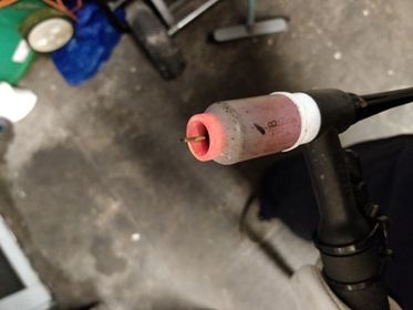

    I also learned why water cooled tig torches are a thing, my lil' machine struggles at constant 200amps welding 10mm plate.

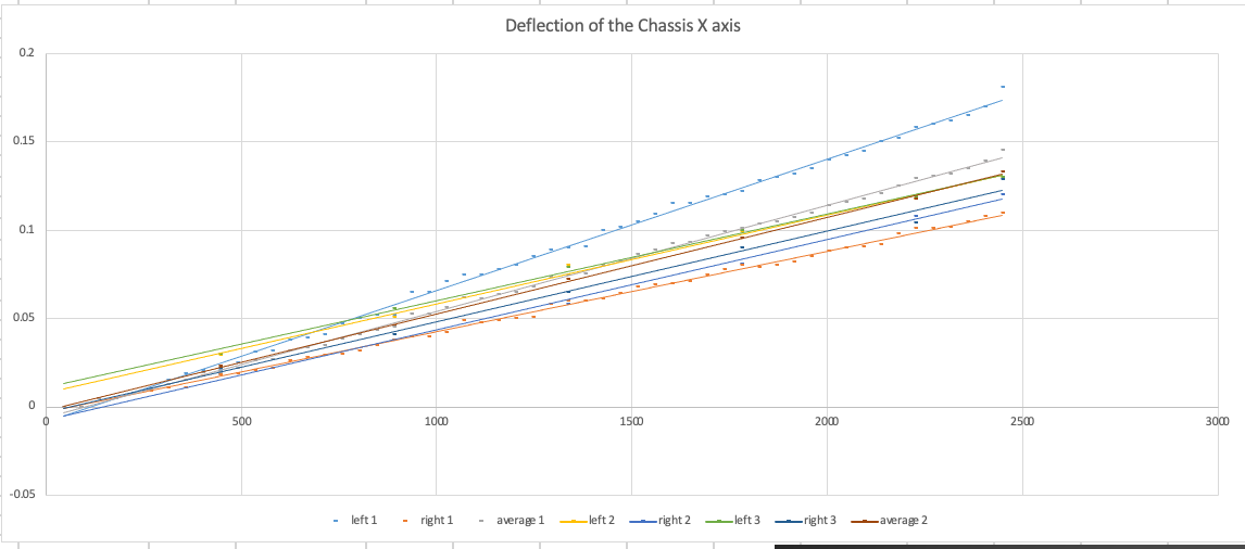

    Above is the deflection of the chassis in the longitudinal direction (think of braking.. the front wheel is trying to bend the chassis back towards the bike). The gradient of that line is essencially the spring rate of the chassis in that axis, 'What line' will be the next question. Each line represents either the left or right side of the chassis at the measured point, and which test it was, above shows three tests with some averages thrown in, they appear to be all over the place! This is when you realise how little chassis's actually move, the Y axis (up and down) shows the movement in milimeters, which is why its so difficult to measure this accurately, It barely moves. With an equivalent weight of around 250Kg up its arse, it only moves about 0.12mm, thats 12 hundredths of a milimeter! The frame will see more force than that with shock loads, slamming down wheelies..etc. I estimate that the chassis is around 120 to 200% stiffer than a mid 00's sports bike, don't quote me, I don't have a clue what the hell im doing... just playing at it!
    Thats only one measurement, there isn't a standarised method of measuring motorcycle frames but its fairly well documented. I'll be doing a torsional test and lateral test also, I'll use the stiffness values from those to design my chassis with the same amount of deflection as the real chassis. Normally you apply forces around the swingarm pivot, but im trying to directly compare chassis, the flex of the engine is not of any importance to me just yet.

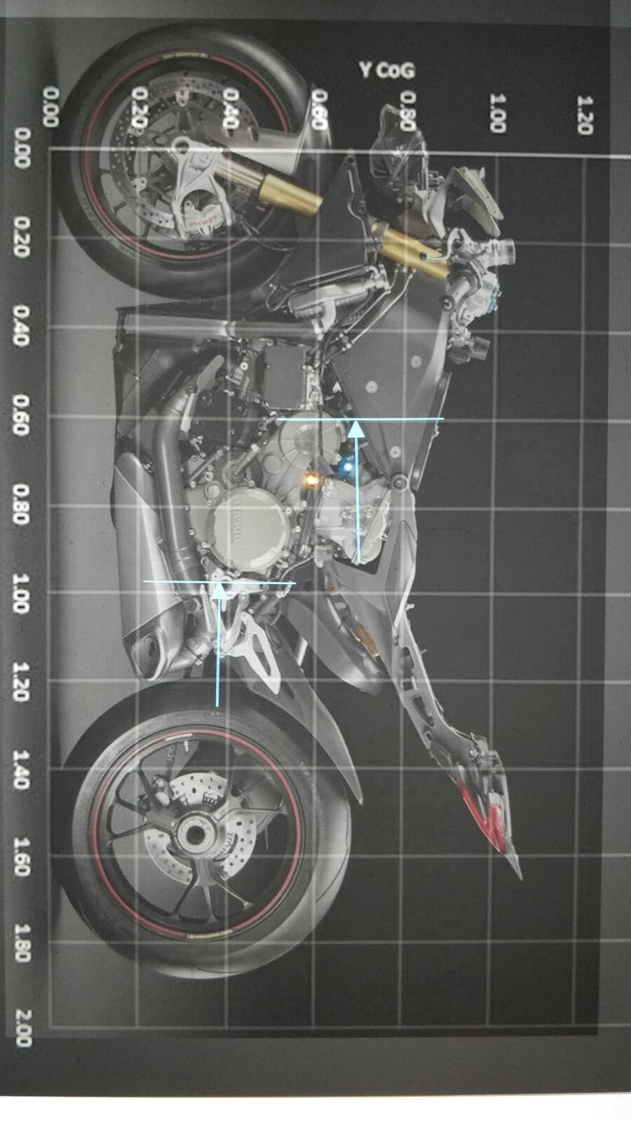

    Can't figure out how to delete the photo above, its not letting me rotate it either.. if you're interested its the center of gravity compared to a rs250 aprillia.

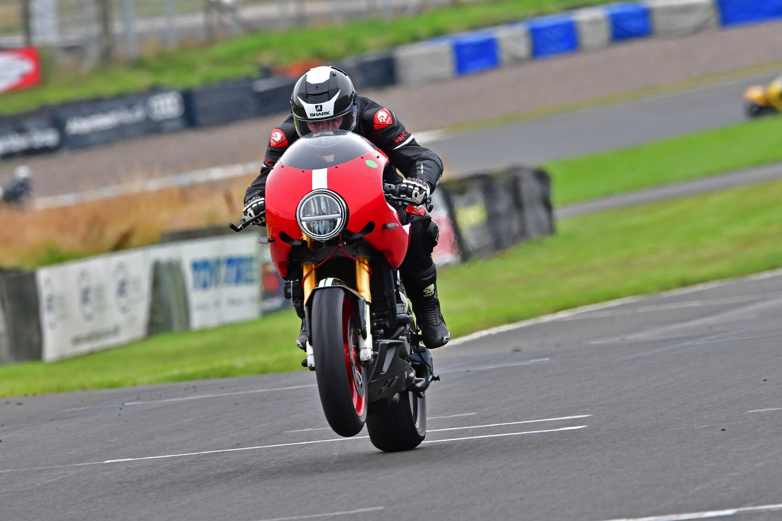

  17. Just noticed that that post was far to boring for a forum, here's a wheelie at knockhill on the 999 to spice it up IPS_7303-(ZF-6642-20692-1-001).jpg

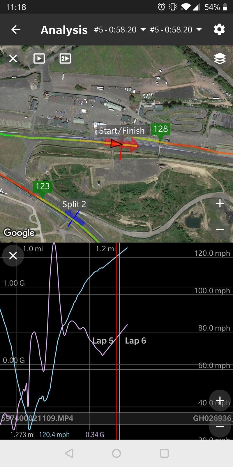

  18. Screenshot_20201028-231849.jpg at 120mph... That's enough for me! Aha
