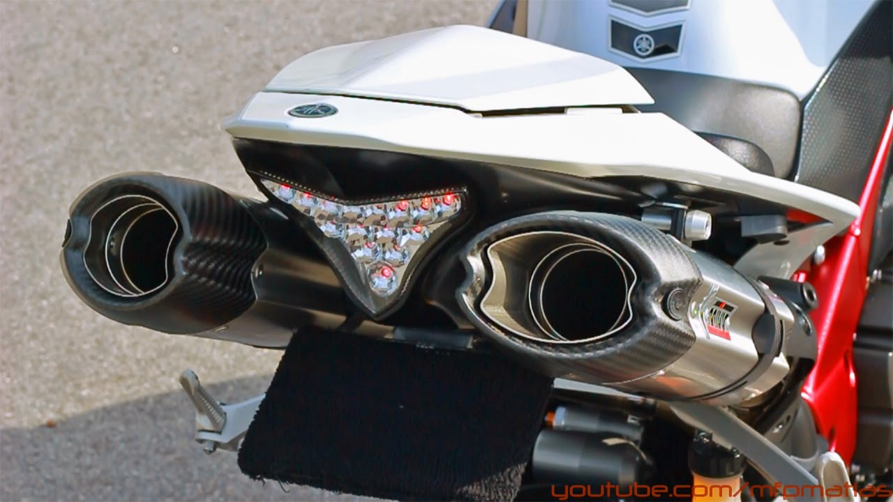

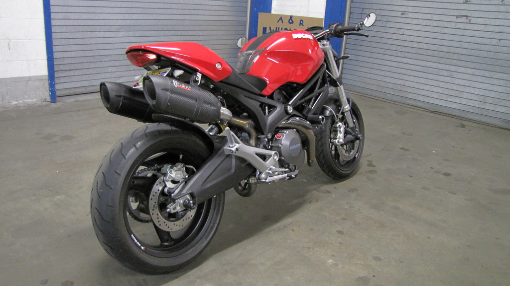

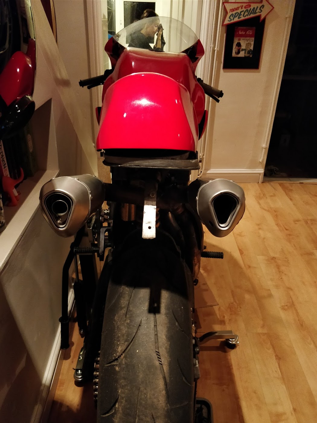

    Either the way I have mine currently spaced out either side of the seat or like the below image sideways under the seat and closer together, Thoughts?
    The main problem is I can't see any specs for the amount of noise reduction, they do a set for the 1100 monster which is the closest cc twin I can find after a quick search. The whole point is to get by track noise limits, If the slip ons won't do it then its a complete waste of time and money. The alternative is to have two 1098 slip ons, this way I can get a set of stock ones that will really shut it up if its still to loud with termi or similar! Probably the smarter option..

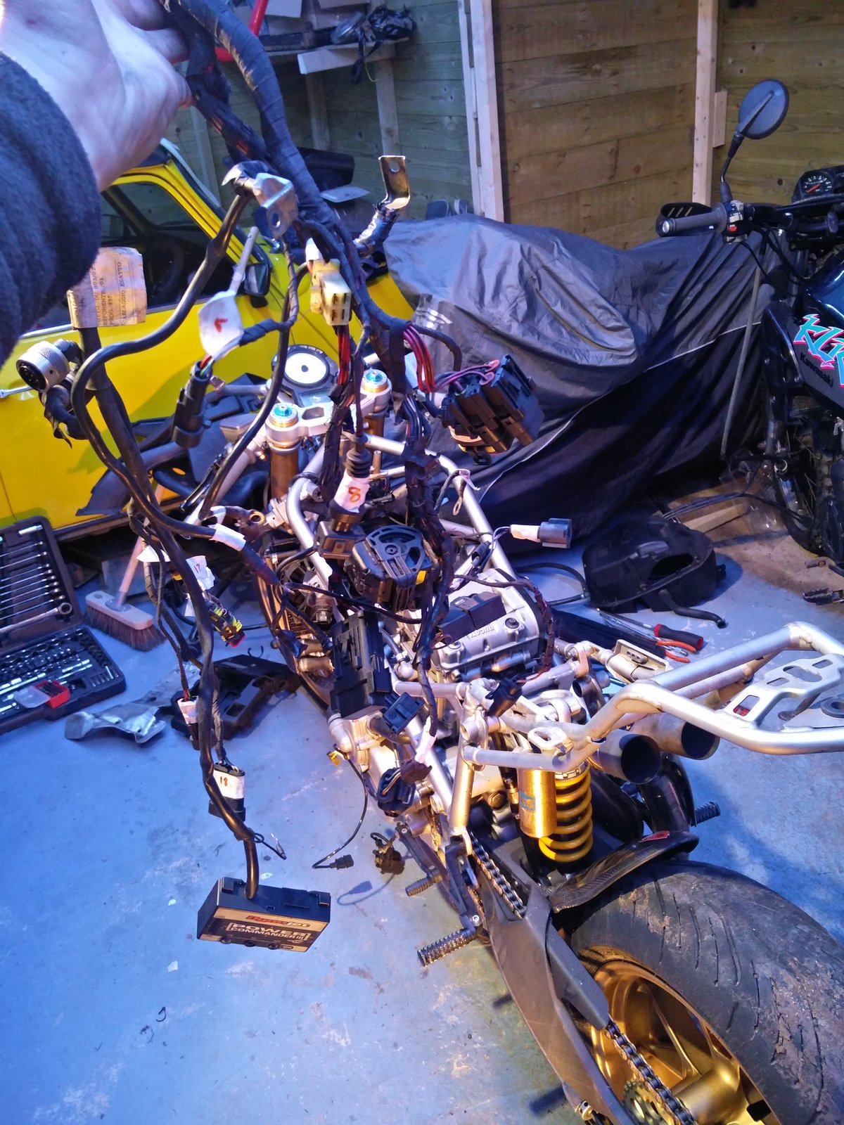

    The bike came with a PC3 and a DP ECU, Soon after getting it the immo shat itself so after a trip to Avanti raceparts (Highly recommend, Took alot of time to answer my questions about how he does it and what he does) he also told me that it was a standard ECU with a performance sticker on it! which I though was quite funny.. he Kindly upgraded it for me. Its basically just a different Ign and fuel map.

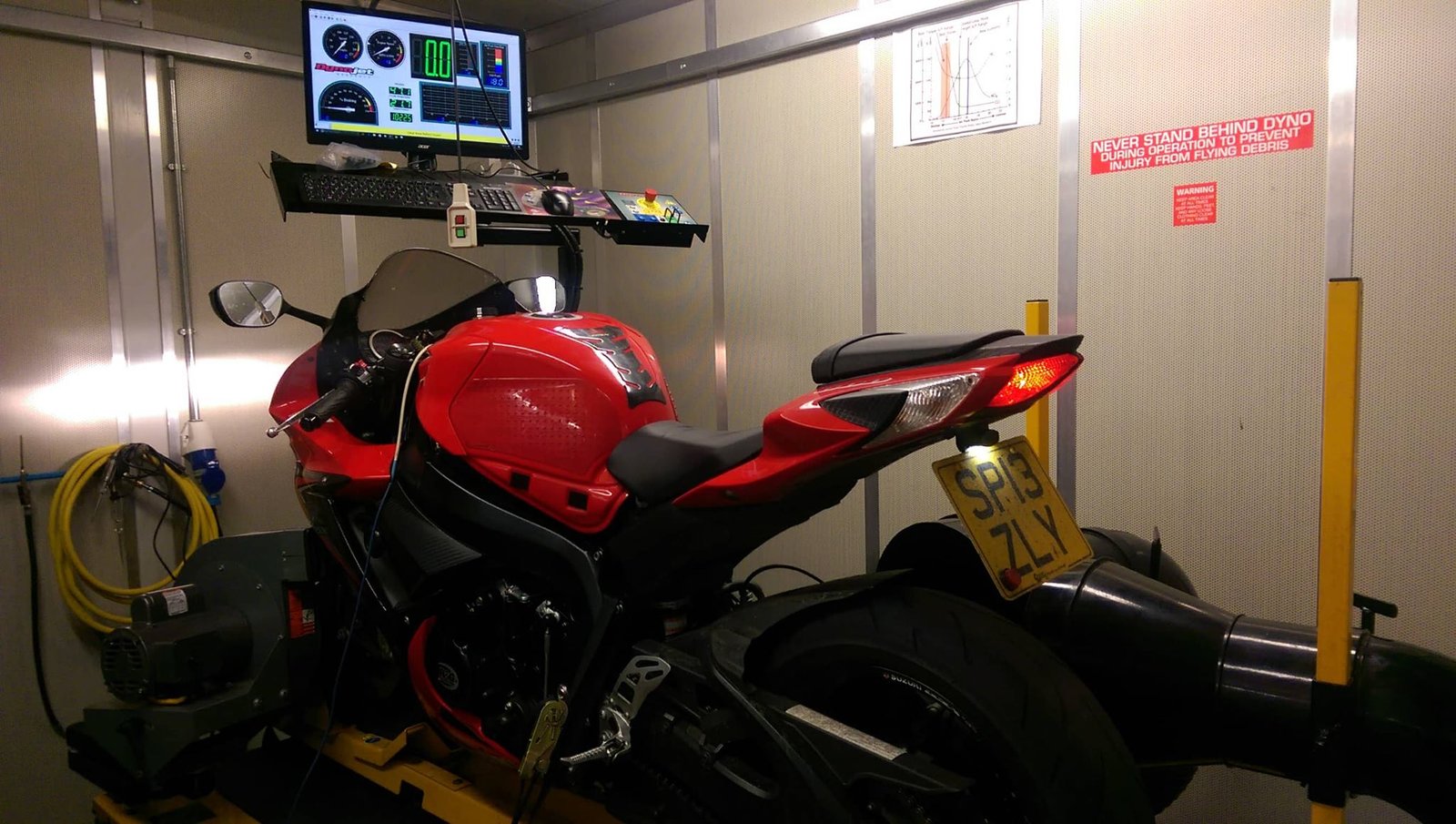

    I had adjusted the fuel on the PC3 on the Dyno roughly just to smooth it out after the suspected fuel pump issue. 22047266_1484256038290946_423355463_o.jpg (a mates bike..not mine!)
    But..... I really can't stand piggyback systems. After the ECU got the REAL DP Map I took the PC3 off as it wasn't suited for it anymore, and getting a generic map off the internet, unless its a showroom fresh bike is a waste of time in my eyes.

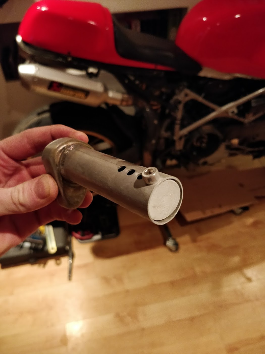

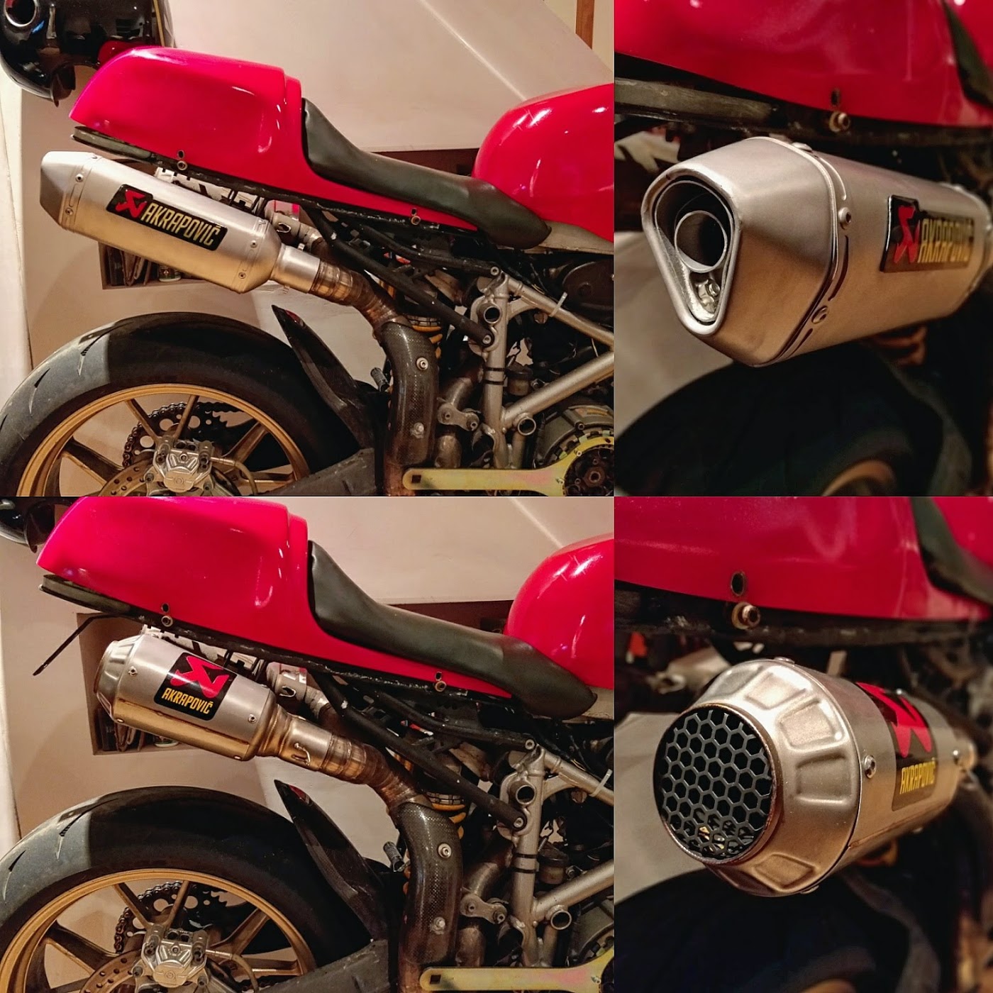

    I don't even want to think about how much power that little 'coin' in the baffle would rob 140hp through a few drilled holes.. hmm..

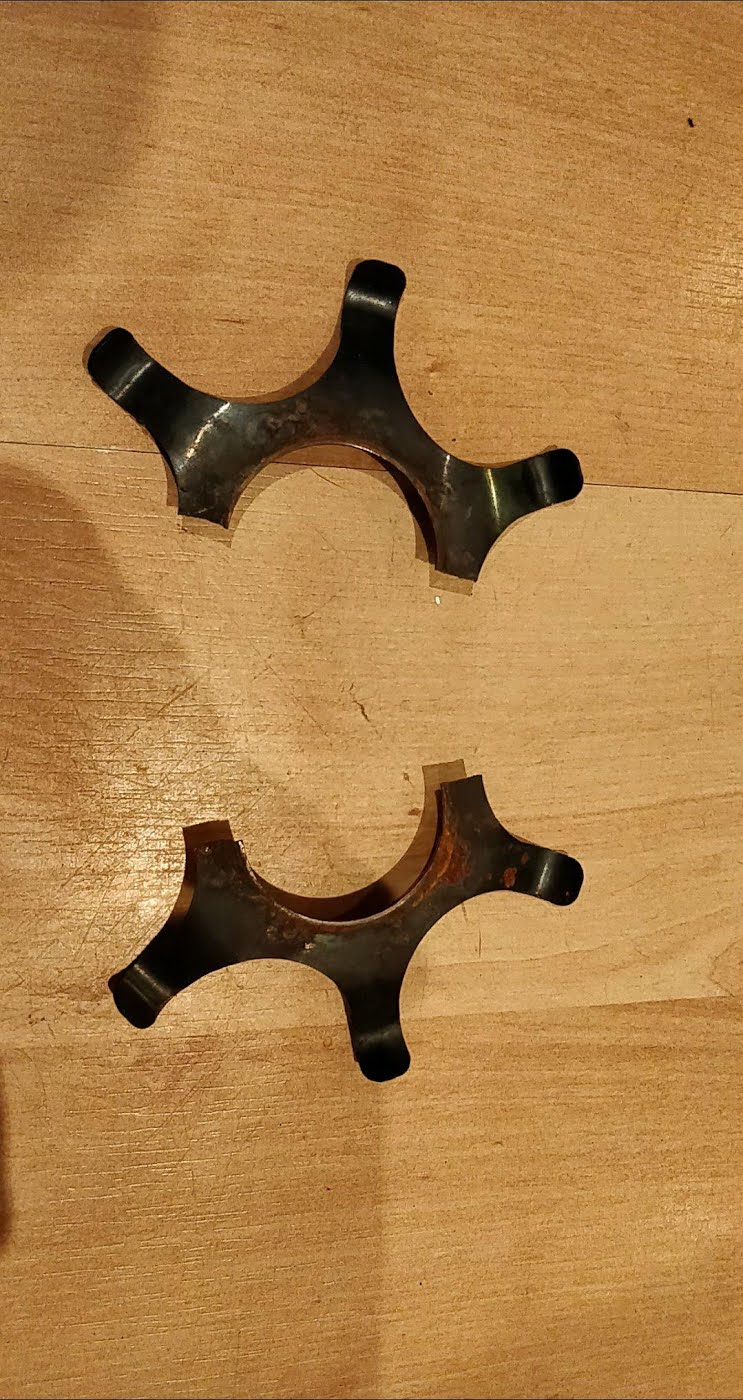

    Stripping the clutch for a clean new fresh plates to find this; received_1743935608985547.jpg
    That may explain the bizarre clutch action!

    - of course the exhaust
