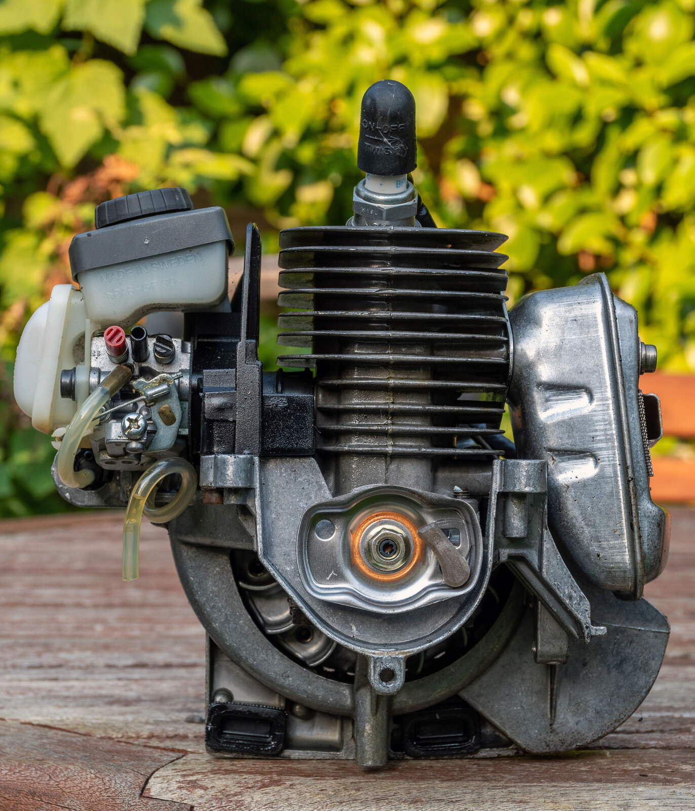

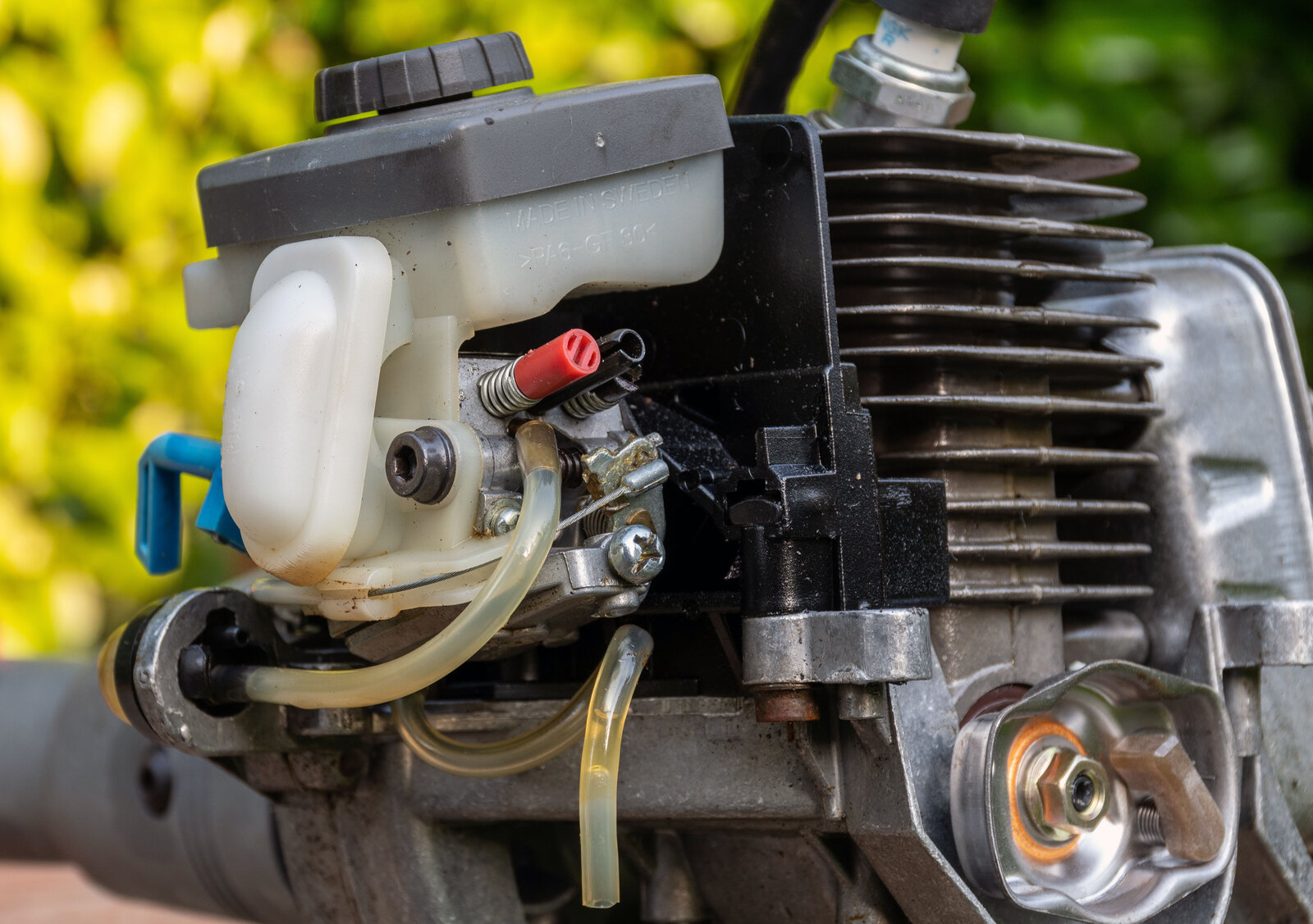

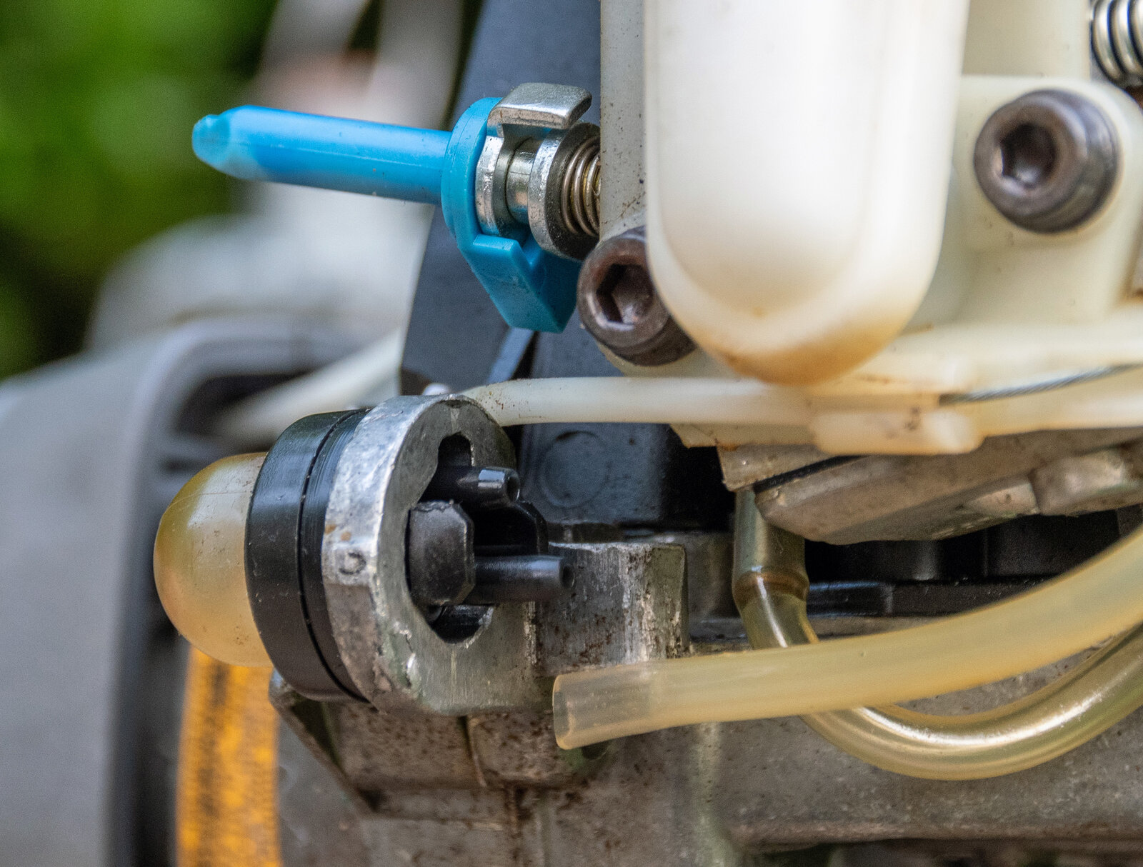

    I inherited this strimmer from a neighbour (she didn't die but moved house and it was her late husband's). Anyway the primer bulb and fuel tubes had perished so I've got some new ones but I'm not entirely sure how to fit them!
    As this forum seems to have lots of very knowledgeable folk I thought I'd ask you!
    1. fitting the fuel lines to the primer bulb is it obvious from the length of the nipples which is the inlet (from fuel tank) and outlet to the carb?
    2. I assume the tube coming out of the bottom of the carb is a return pipe and therefore goes back into the fuel tank through the highest grommet, with the fuel pick up going into the one which is at the bottom of the tank (when in the operating position)
    It does seem in very good condition and I love the little slencer!
    Thanks in advance.

  2. Thanks, It doesn't quite answer the question but I think a bit of trial and error should provide the answer to the which pipe fits where. Need to buy some petrol to mix with a bit of 2 stroke oil.

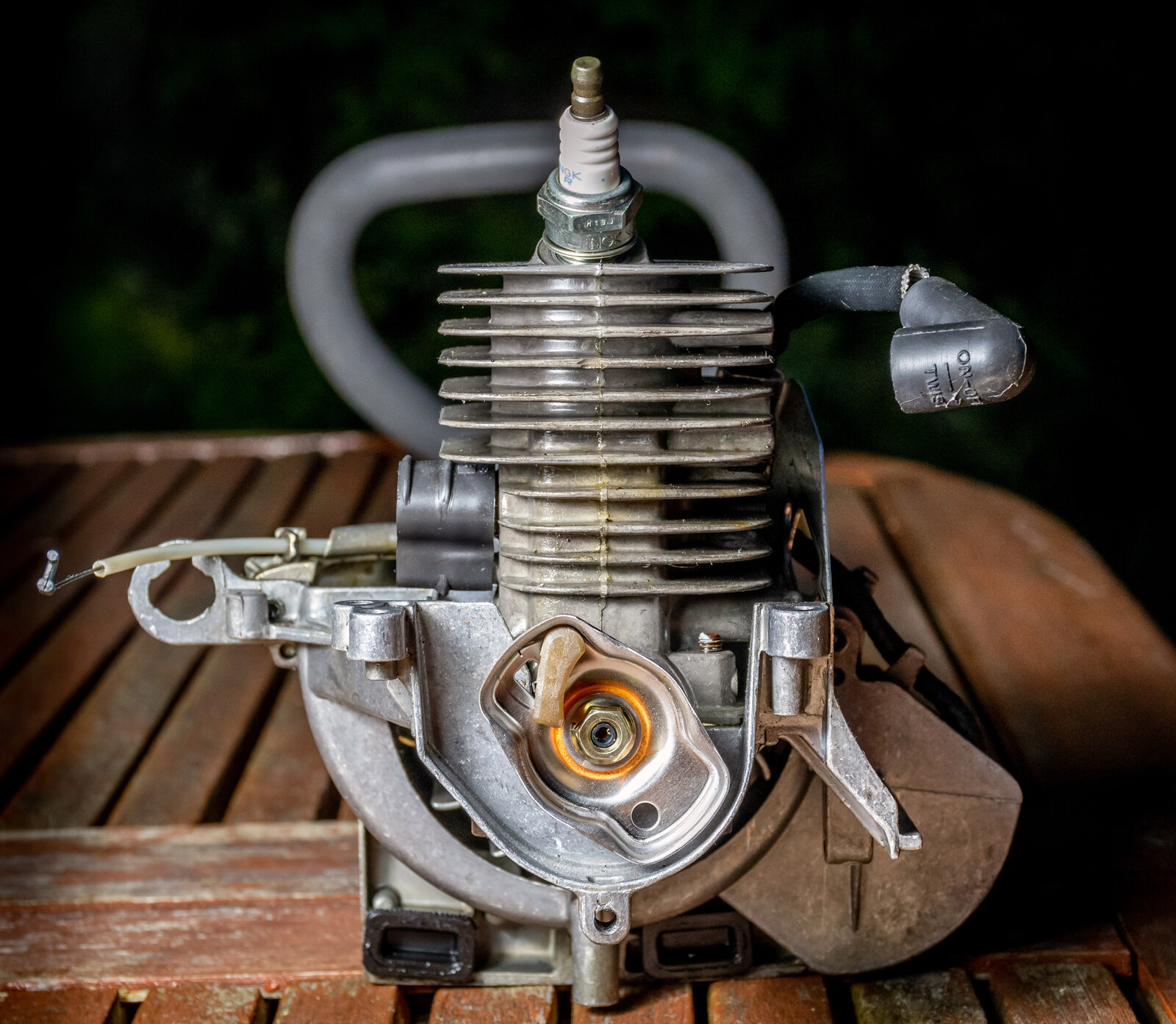

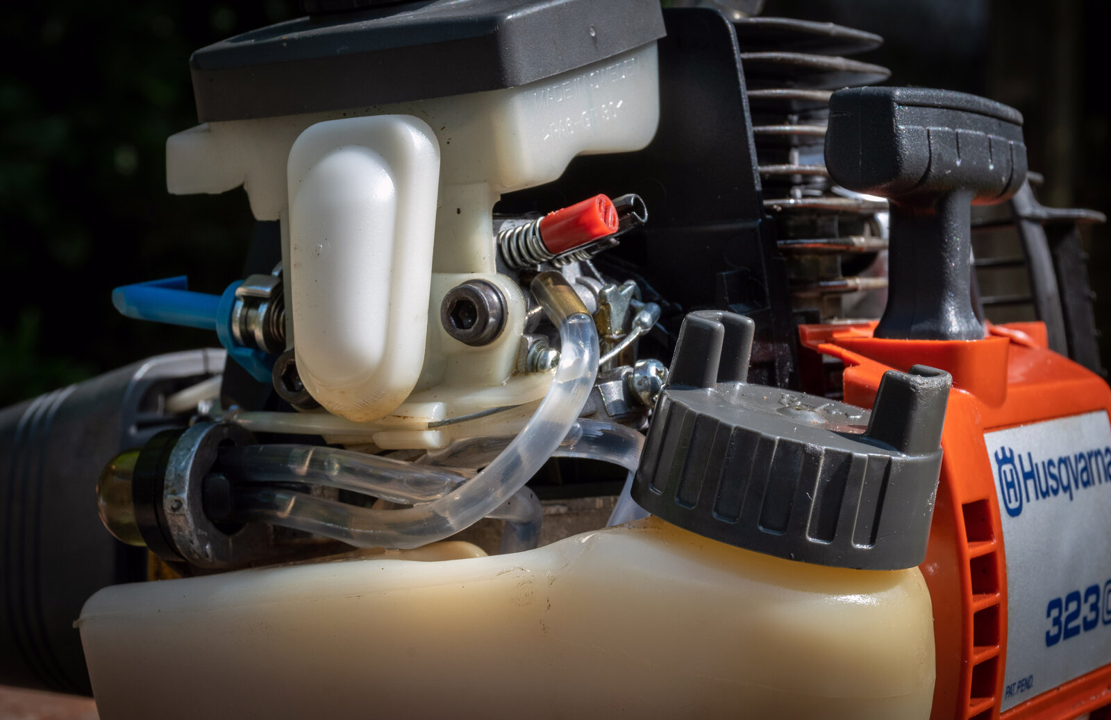

  5. I've ordered some more fuel pipe as the new one from last year has already gone stiff. Pretty sure it will start. I've taken it apart more than necessary just for the hell of it!
    25cc apparently :)

  9. Fuel pipe arrived and fitted. Took a bit of fiddling with choke and throttle but it started. I can certainly see the logic of using benzene free fuel if you were working with these all day as you are pretty close to the exhaust :confused:
