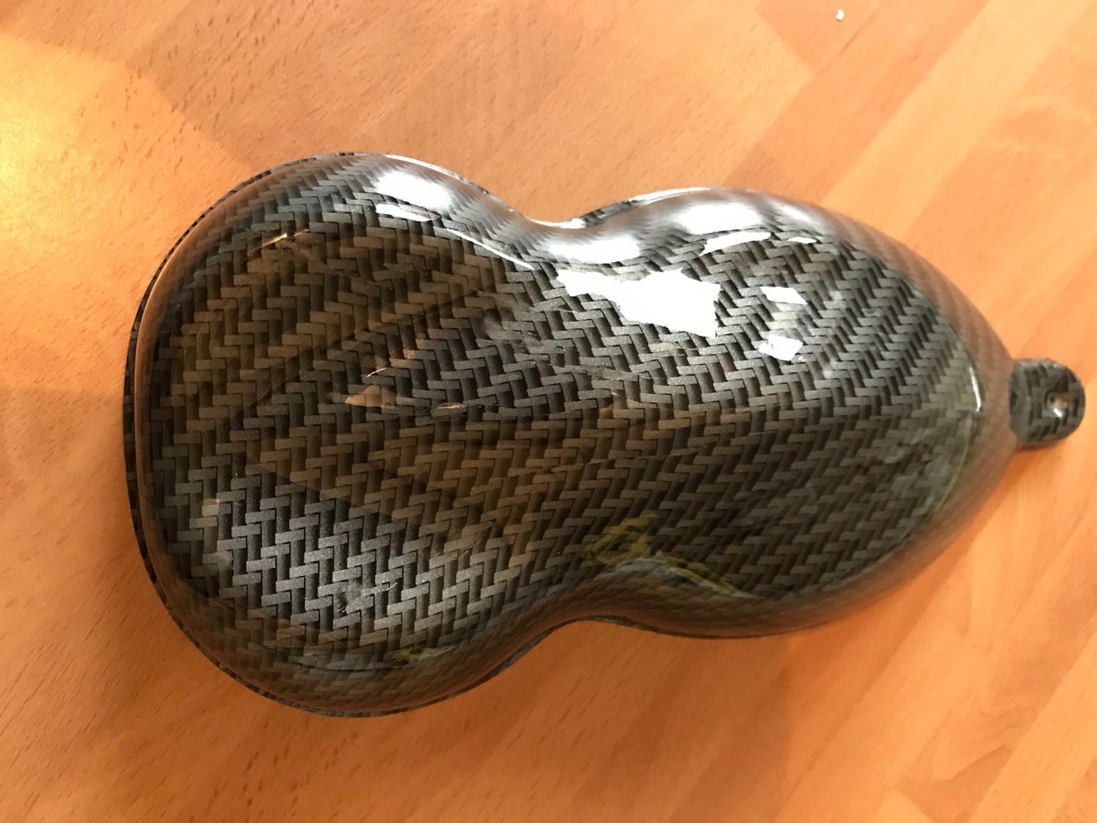

  15. EEFFAACB-0E9D-47C1-A81C-6363F974EE1E.jpeg So this dipping lark is not as easy as the videos indicate, I can prepare the part easy enough, lay the film on the water easy enough but getting the activator and time for the film to hydrate is a pain.
    So I have had three goes and worked out I have a mild activator so need more, practic makes perfect, the attached picture is my third go, it’s not perfect and I would not offer this service to anybody yet. I intend to practice more next week.

  19. Keep at it, looks like a good third try.
    Interesting to see how you get on
