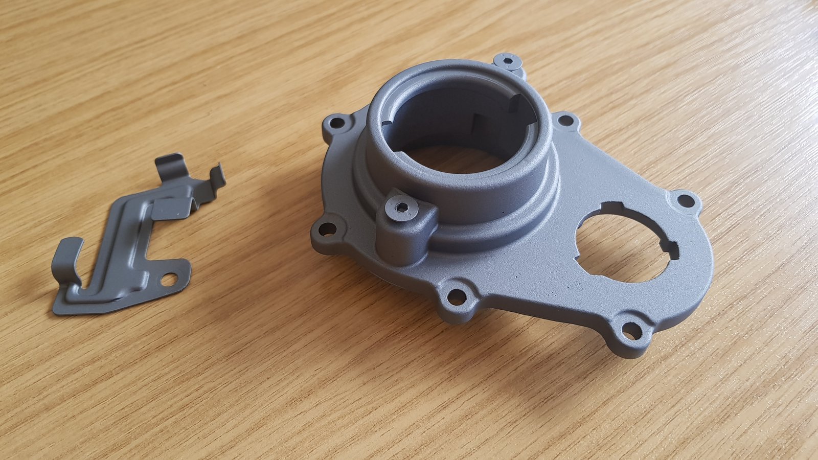

  6. Couple more bits returned from Mr Cerakote ...tank collar and that bit at the back which holds some of the electrics...

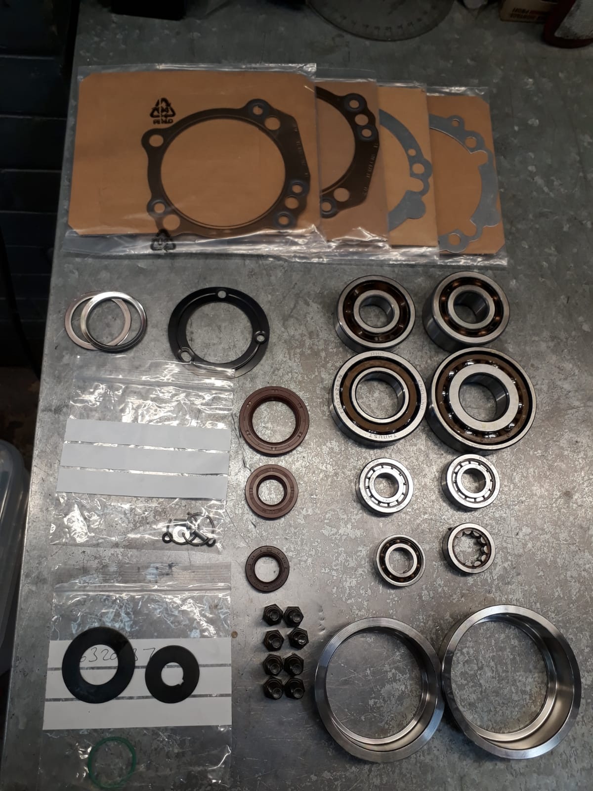

  7. Quick update: Just got off the phone with Ducati John. Final build cost is, give or take 2.2k. Ouch. But, ive kinda taken it to the extreme in that, i can if i want to re-use all the bearings that came out, but, while ive got this chance then thought better of it, coupled with the upgraded shell main bearings is what adds a sizable chunk to the cost. Work will begin on re-assembly mid june...ish.

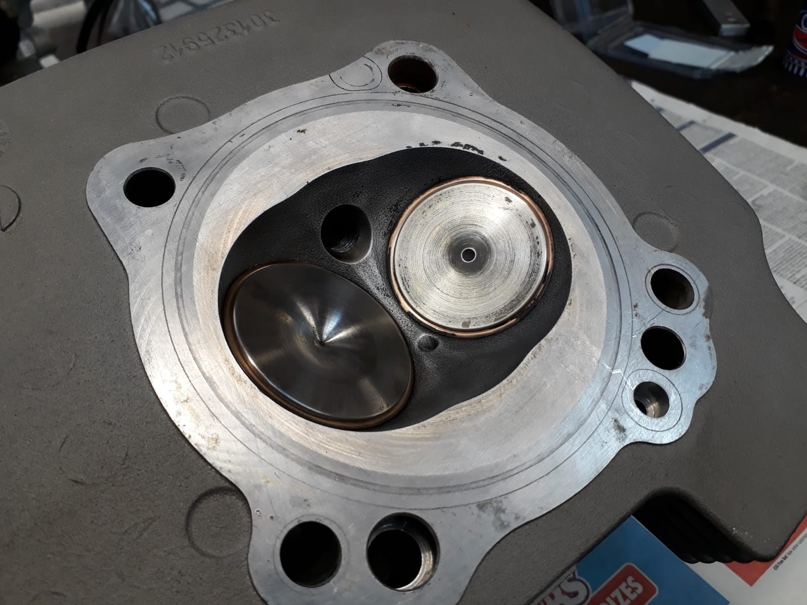

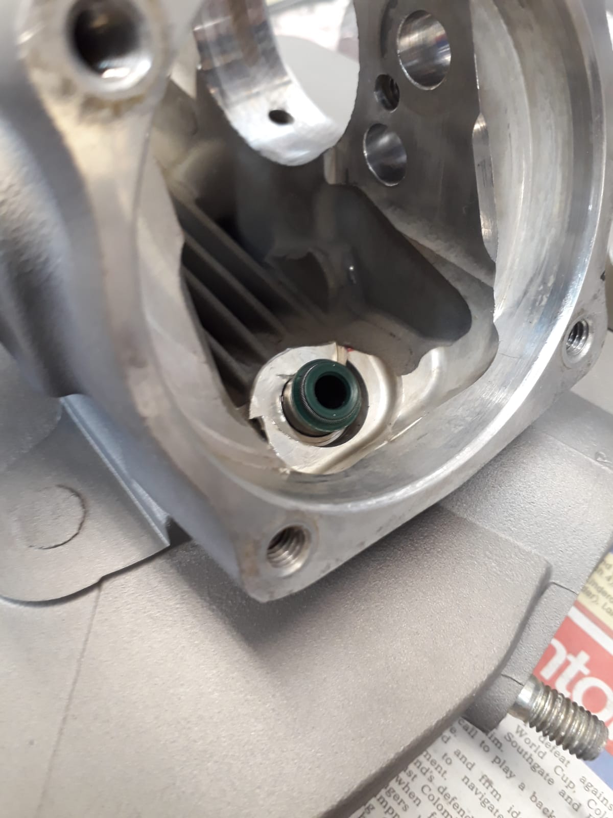

  8. Andy, are you having any special head work done?
  9. Already done it. Took some of the valve guide away on both cylinders.

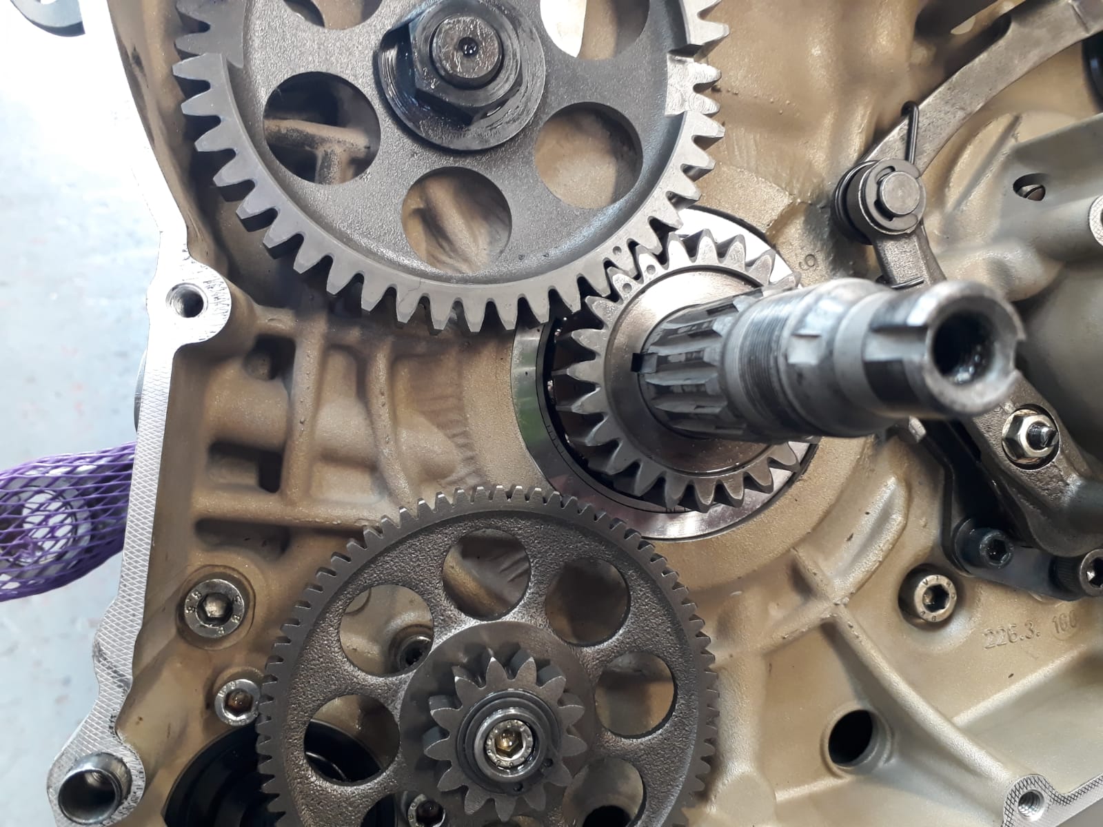

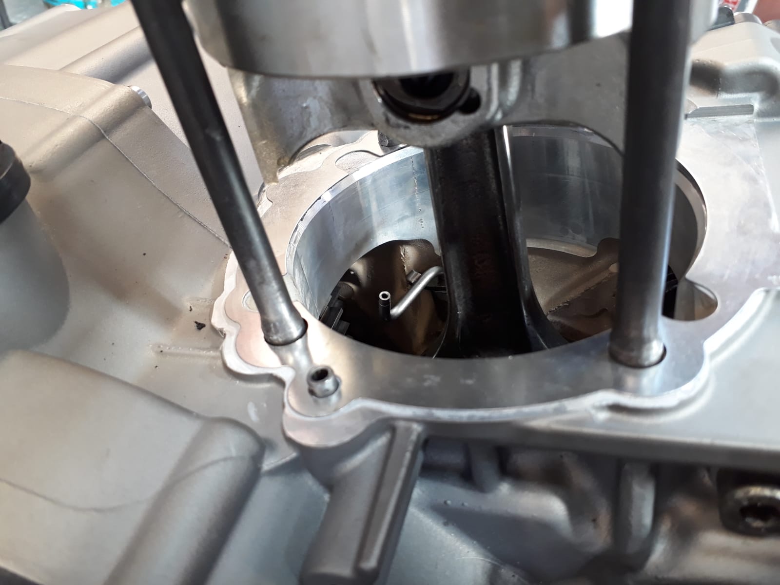

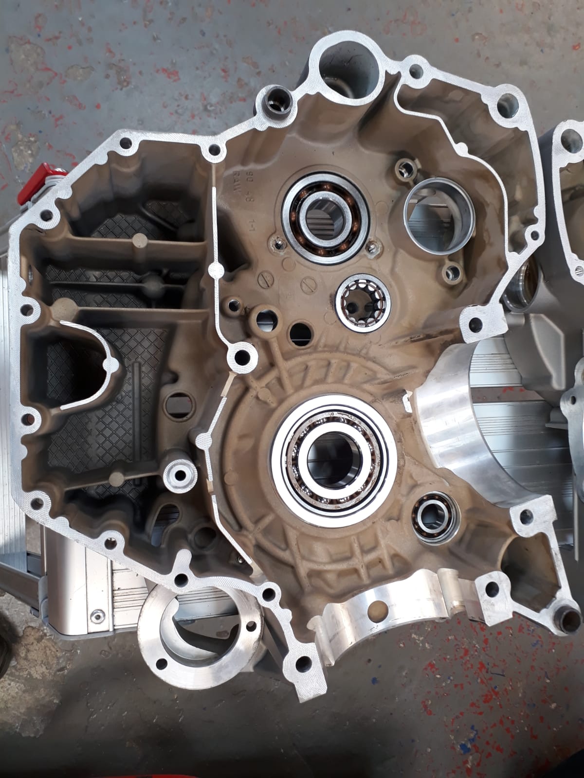

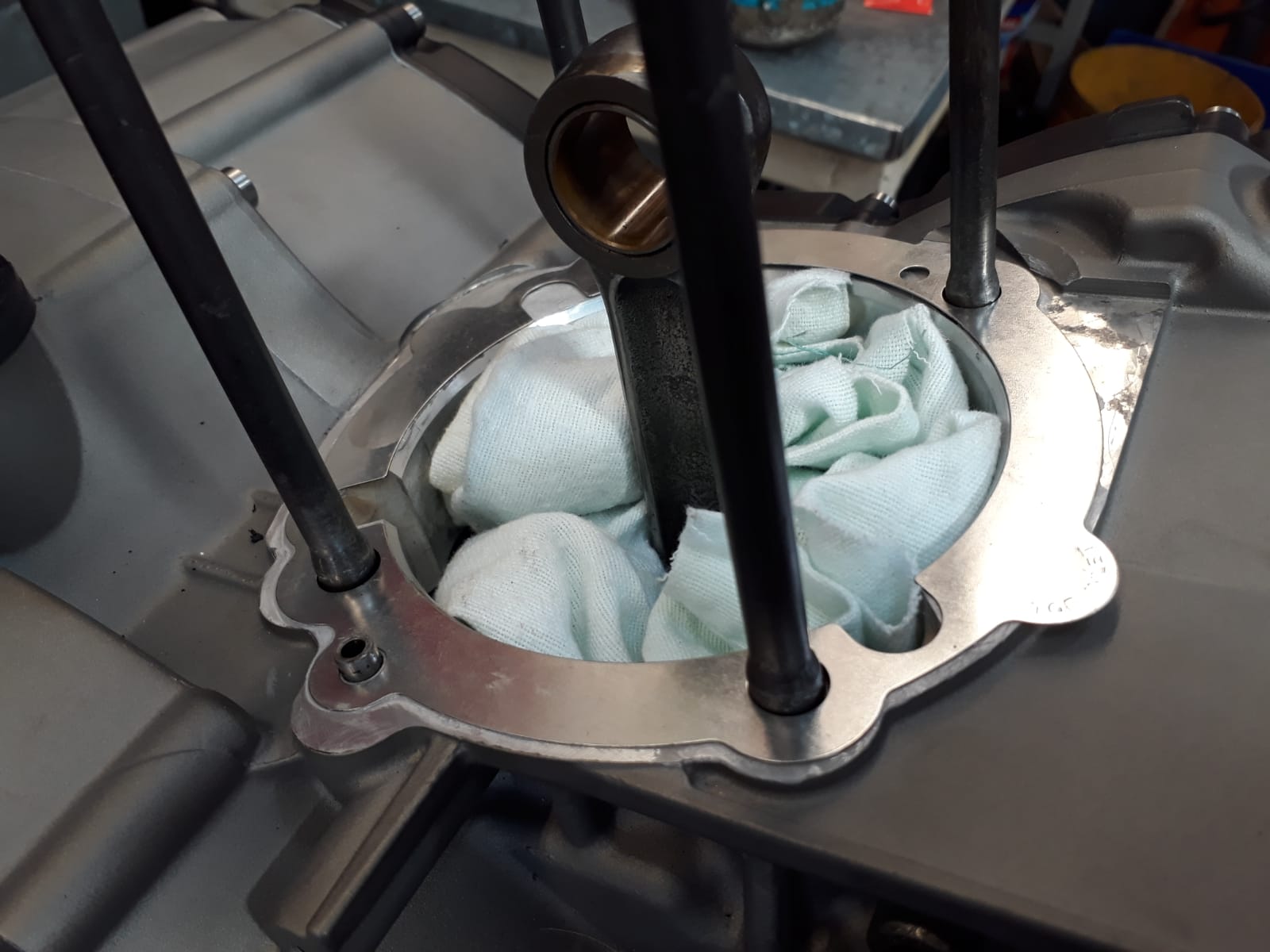

  10. Just in case anyone thought it had all gone quiet....well, it has, Ducati John is on hols (cheeky sod eh! :)) engine rebuild "should" be starting next week....

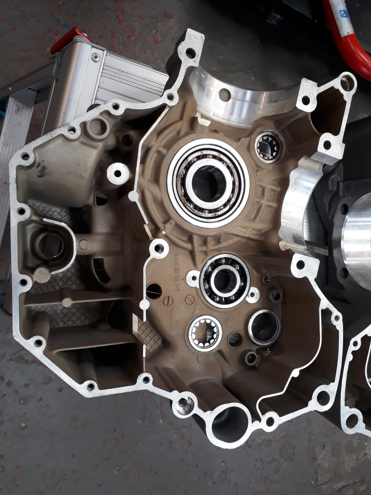

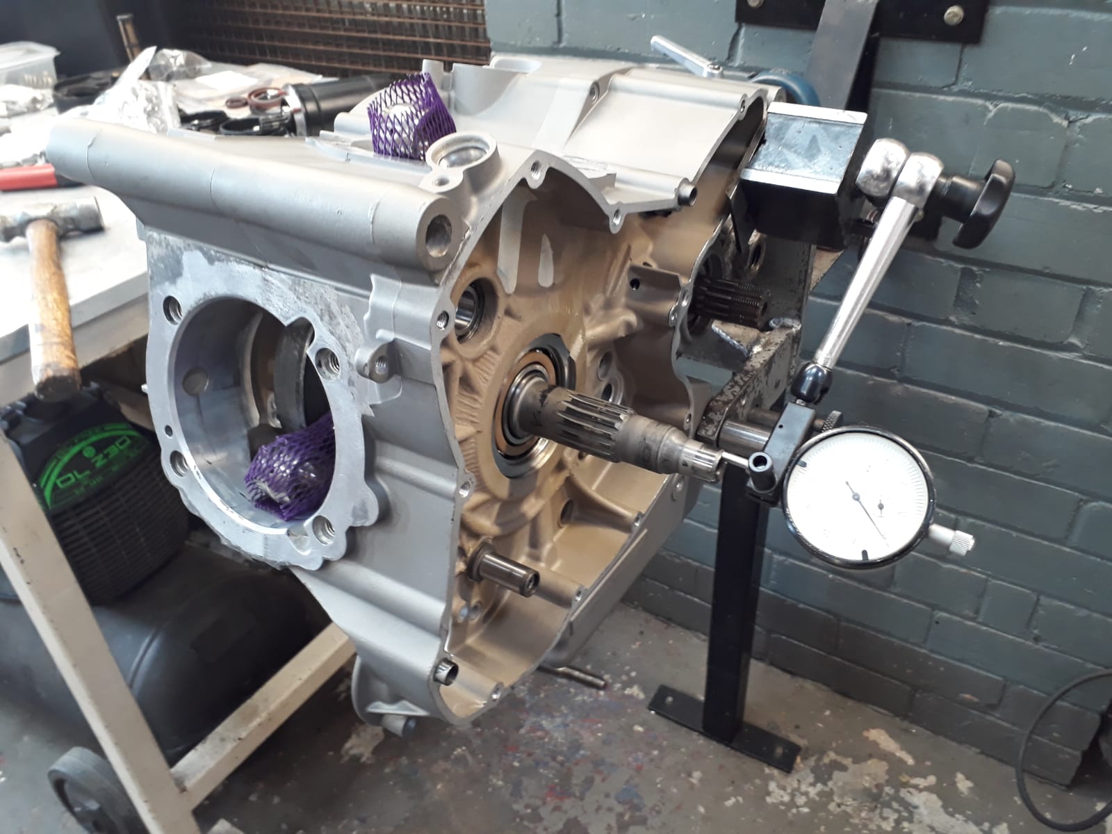

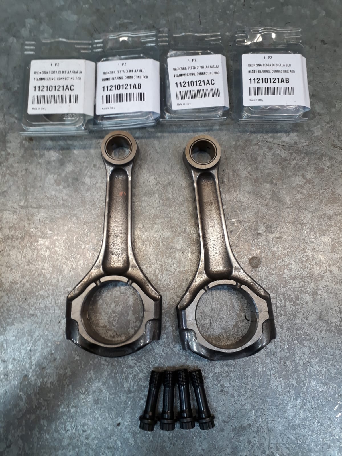

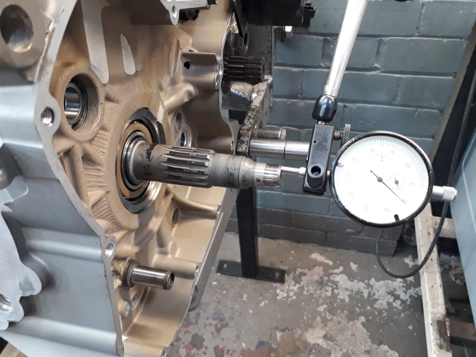

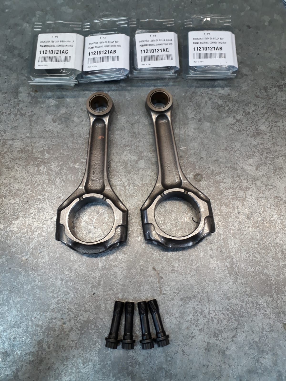

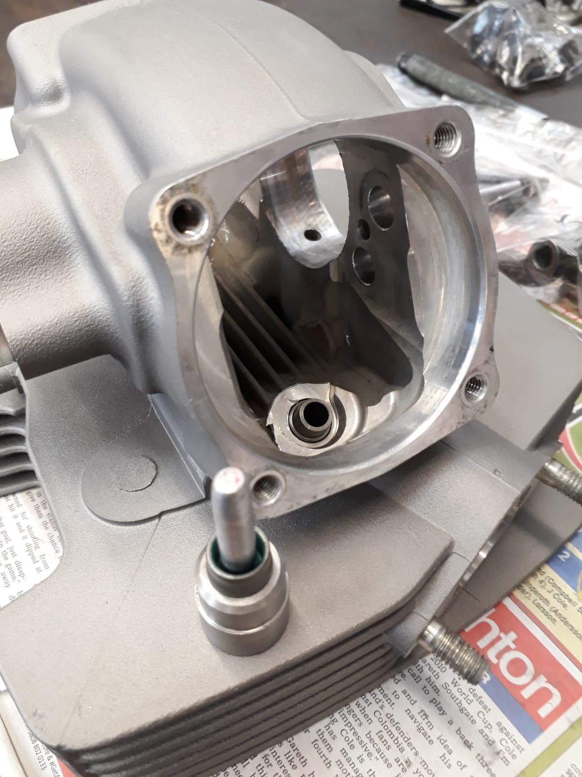

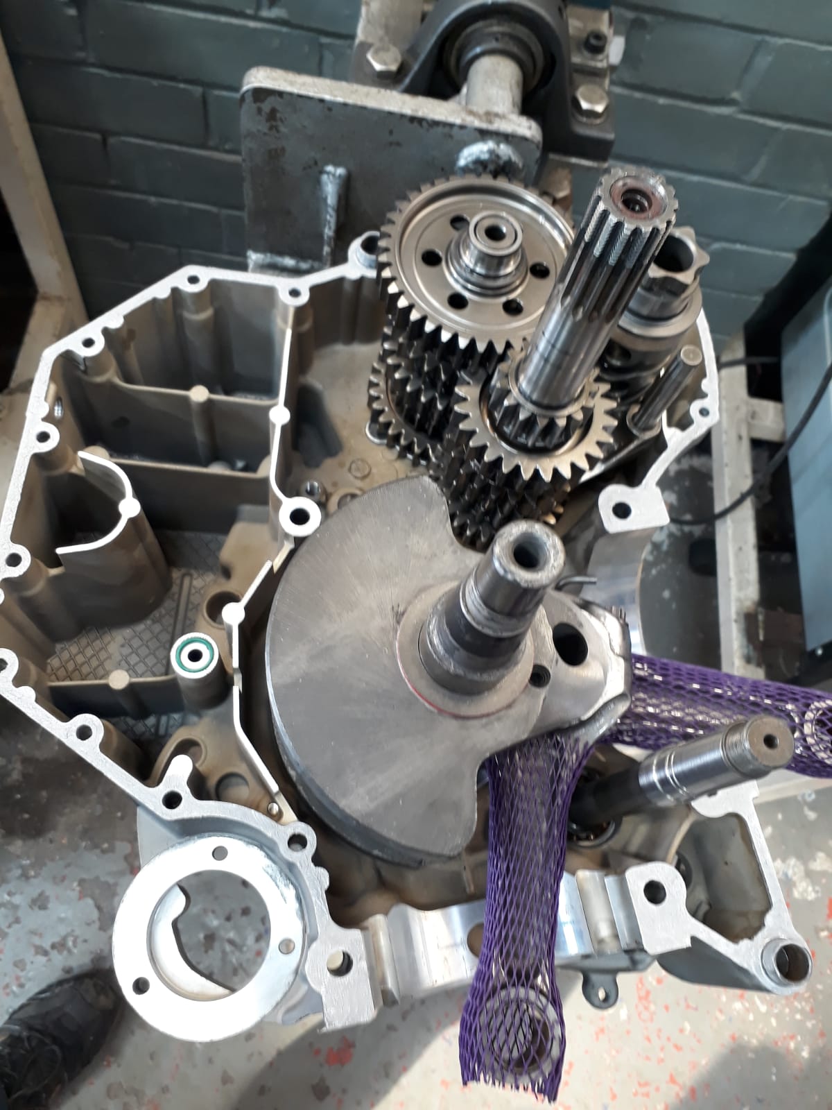

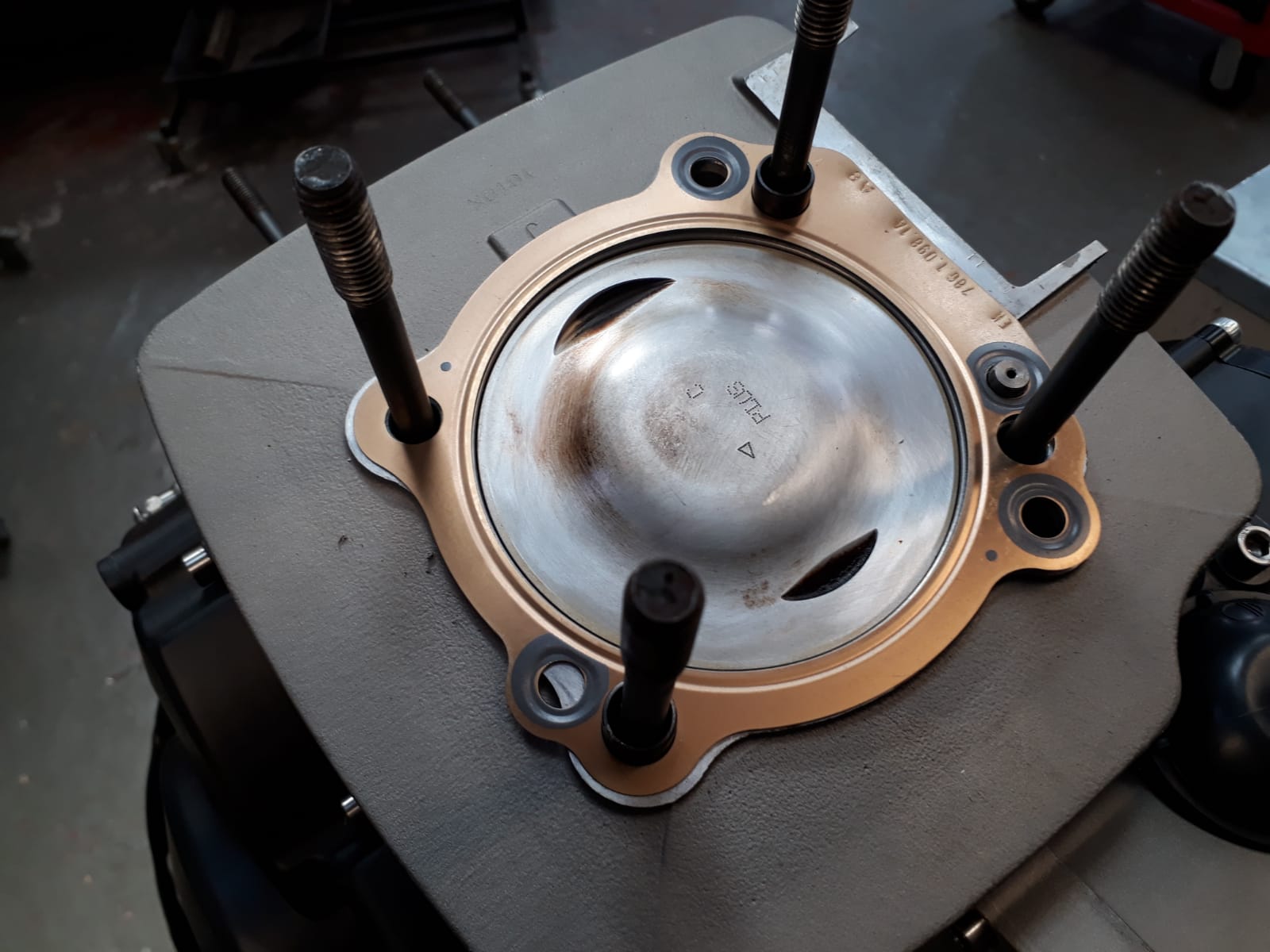

  11. The rebuild begins....at last....
    IMG-20180723-WA0010.jpg IMG-20180723-WA0011.jpg IMG-20180723-WA0000.jpg IMG-20180723-WA0012.jpg IMG-20180723-WA0001.jpg IMG-20180723-WA0013.jpg IMG-20180723-WA0002.jpg IMG-20180723-WA0009.jpg IMG-20180723-WA0007.jpg IMG-20180723-WA0008.jpg IMG-20180723-WA0014.jpg IMG-20180723-WA0003.jpg IMG-20180723-WA0015.jpg IMG-20180723-WA0004.jpg IMG-20180723-WA0005.jpg
  12. Temporarily stopped as he's waiting for some gaskets to come in but its going the right way now....

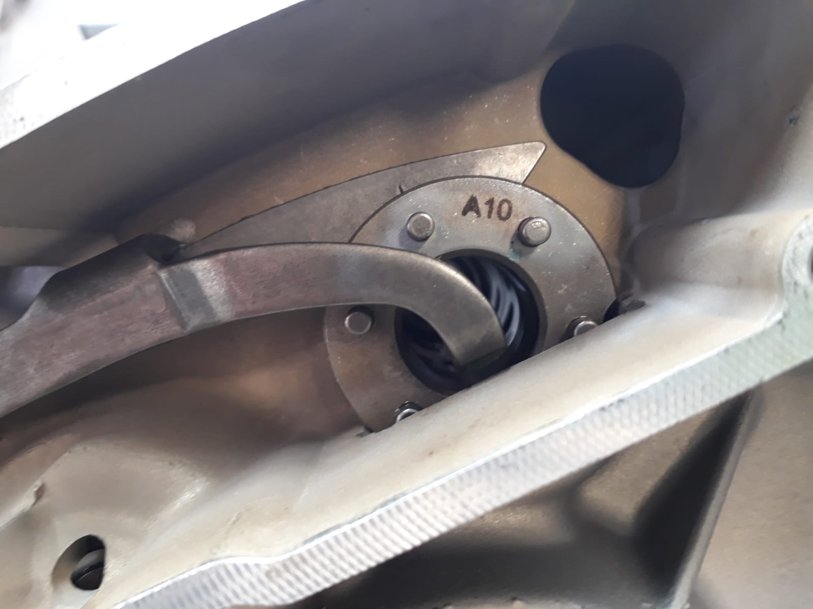

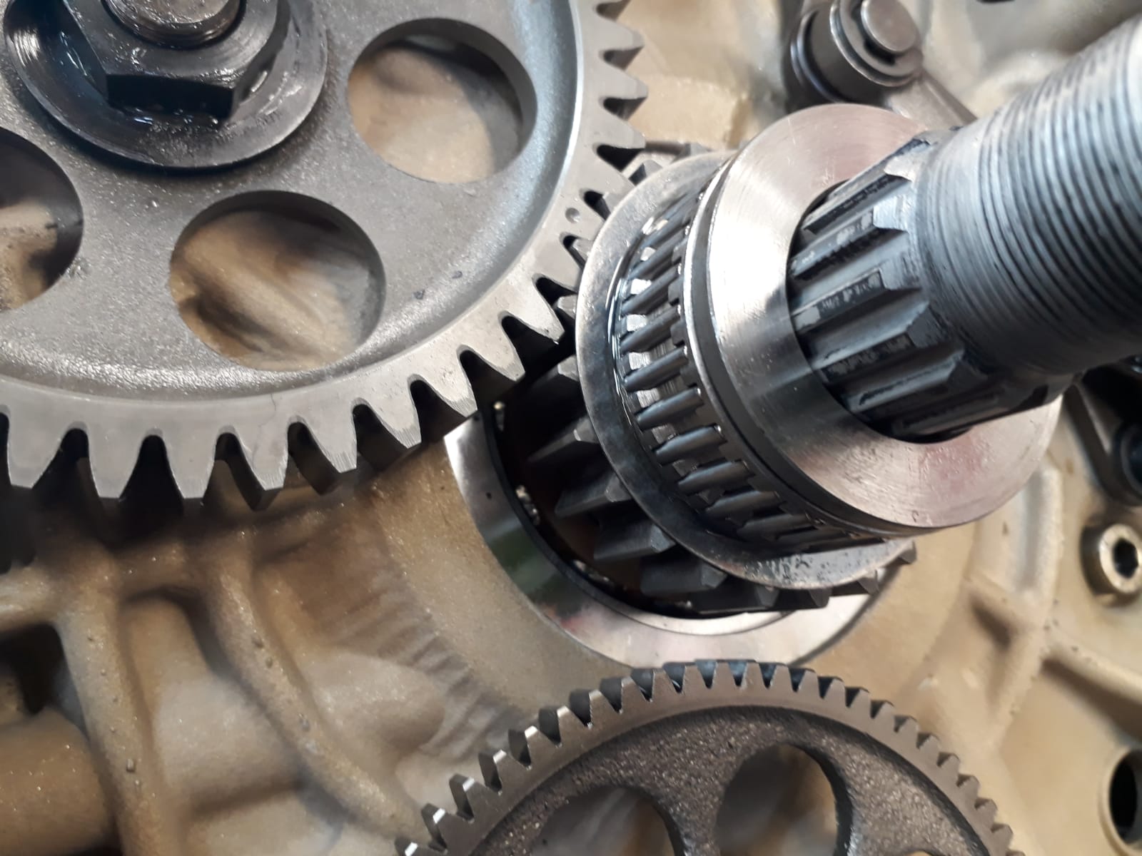

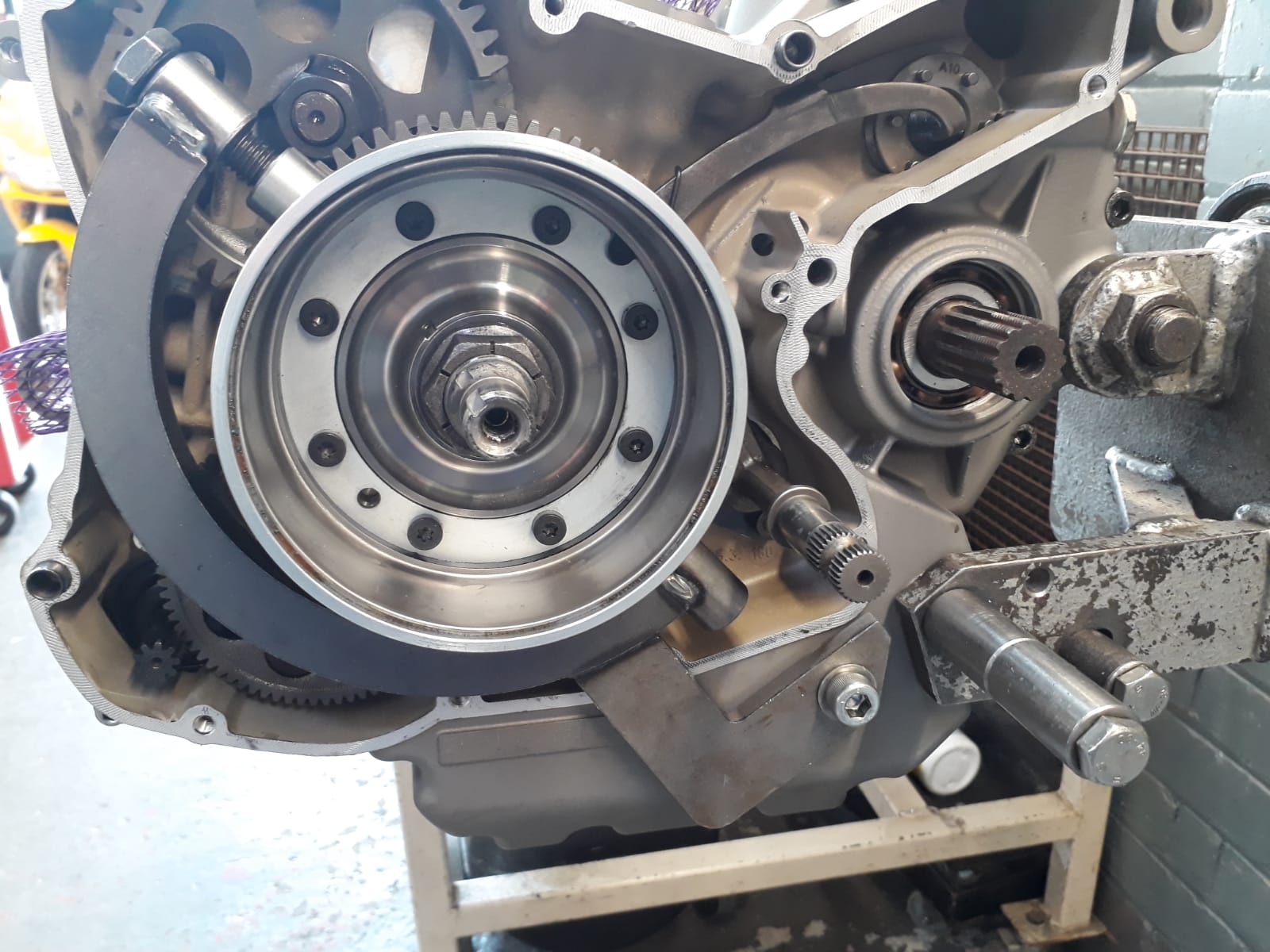

  13. That sprag wear on the starter wheel, I assume is ok? Are you replacing that nuisance sprag whilst youre there?
    Cant wait to see finished engine. Should look the nuts.
  14. I presume so...its at Ducati Johns....so im assuming he'll replace if he needs to but ill ask all the same...

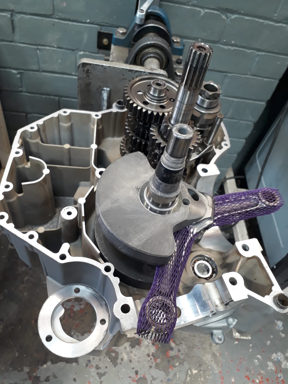

  16. Hey andy, was only thinking this morning bout how its going, you had the crank assy balanced, was it far out? Should be silky smooth when all done.

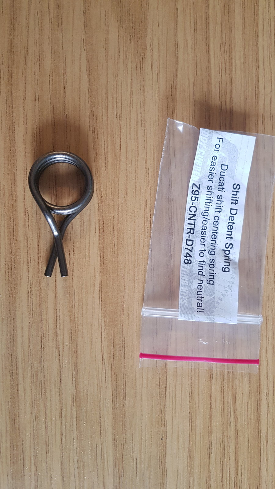

  17. Yep - all balanced and done as you can see....only fly in the ointment was i bought an aftermarket gear return spring from the states (80 quid to get it here) i stuck it in the box and for whatever reason it got lost....bollocks. My bro is going back over later in the year so ill get another sent to where he's staying....(will cost half the price then)!!

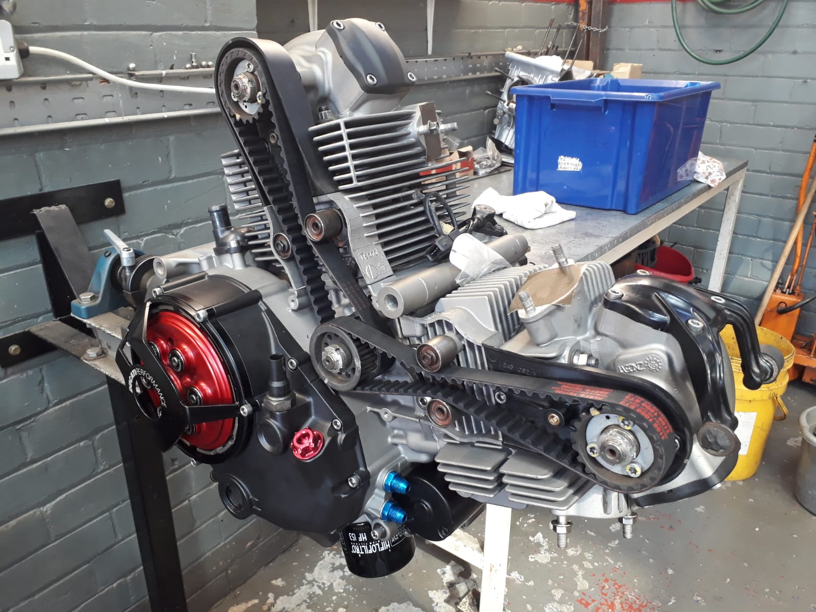

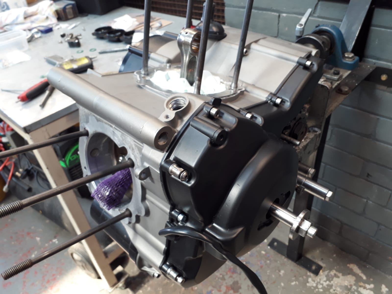

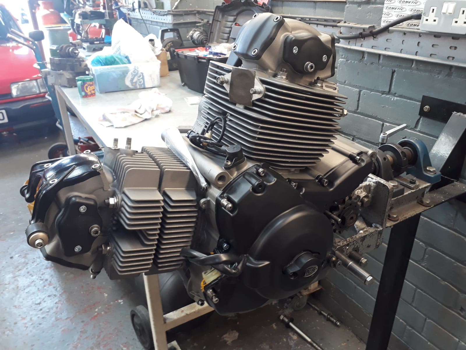

  18. And we're there...all rebuilt and back together...its been off the road night on 4 months...worth the wait...!
