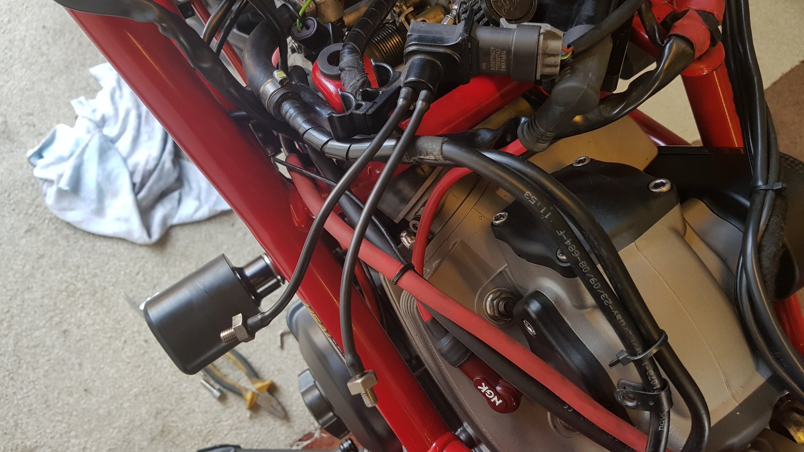

    While I'm going other stuff...took these off the throttle bodies...can't remember where they back in for the life of me.!
  3. Found it - pressure sensors on the throttle body connectors...yey me.
  4. Pipes on. Forgot to say...had the backend resprayed too...was a bit ropey, but it was before I got the bike...

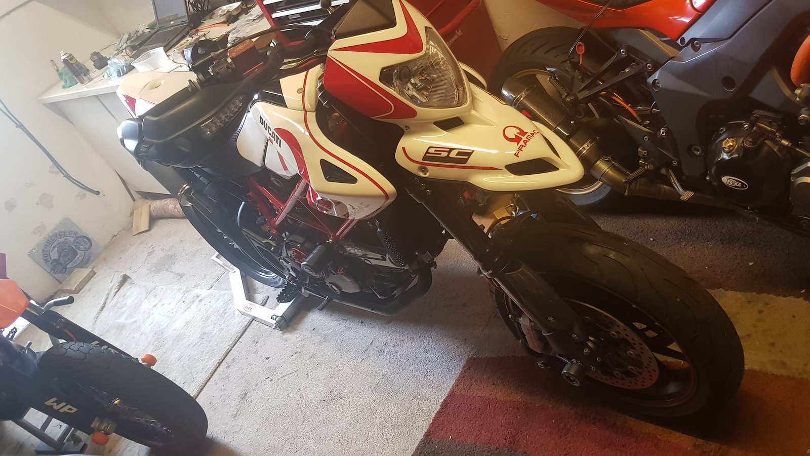

  5. Maybe...it's not taxed and the mot is out...might go round the block. Just soaking the air filters and having a break...

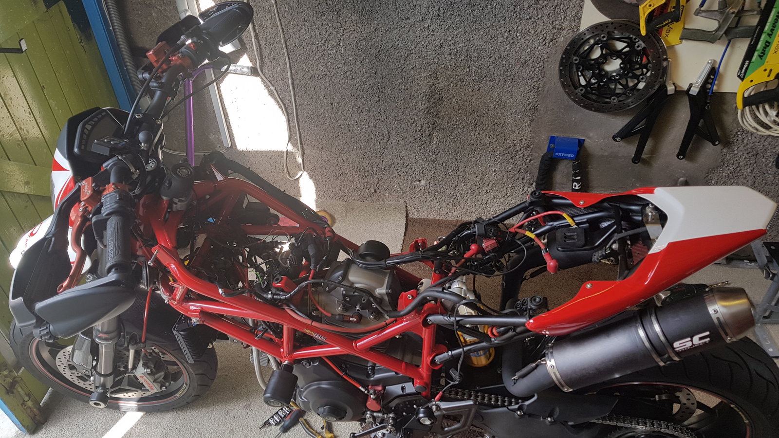

  6. Woohoo....she's alive!
    Loads more to do but, it's running...

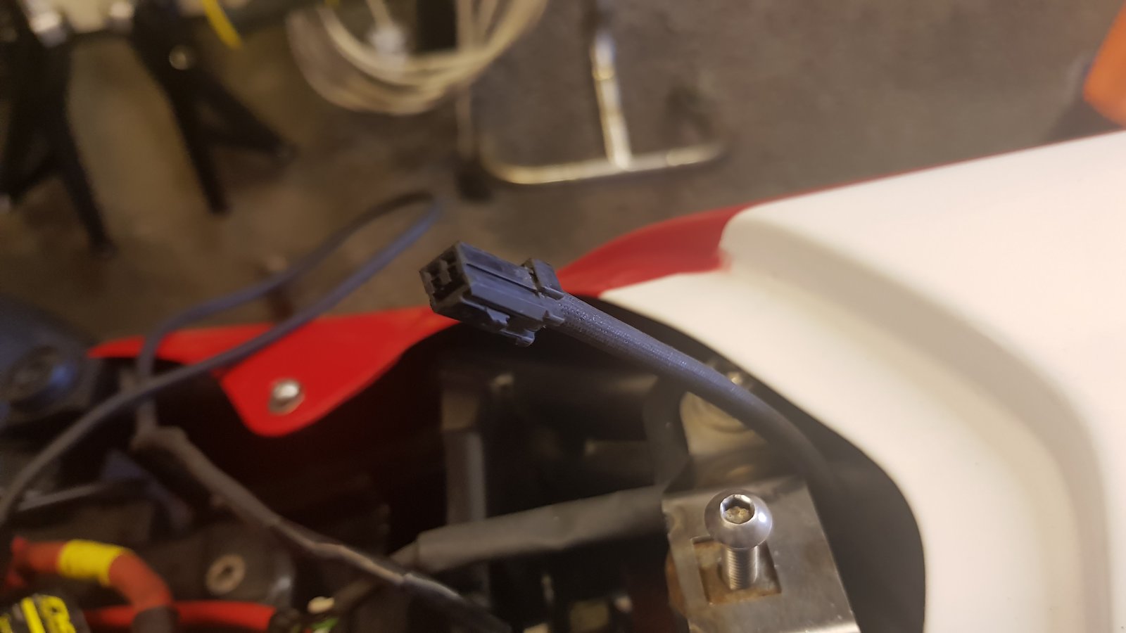

  7. Sorting out wiring this morning...anyone know where you buy these connectors...

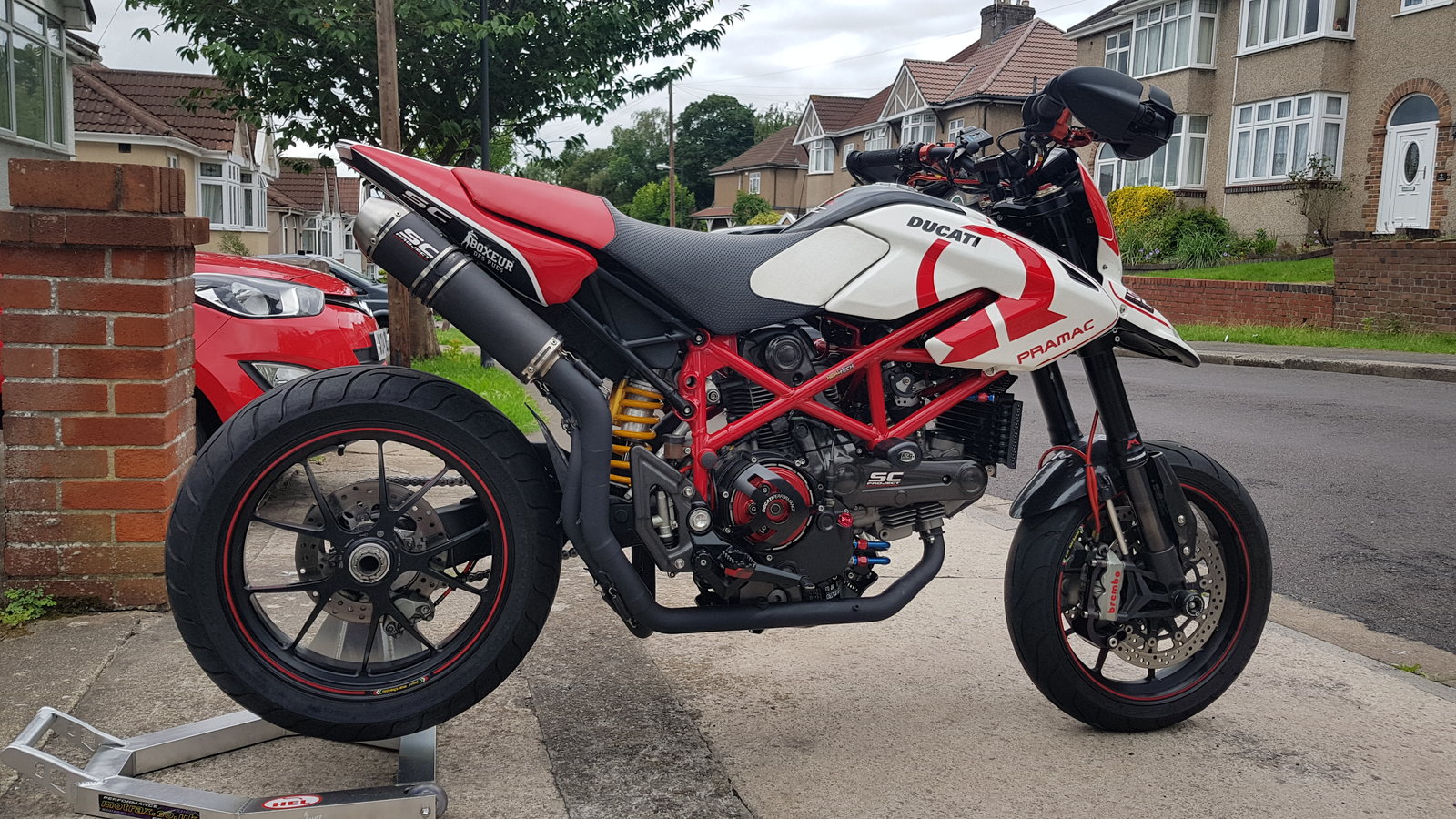

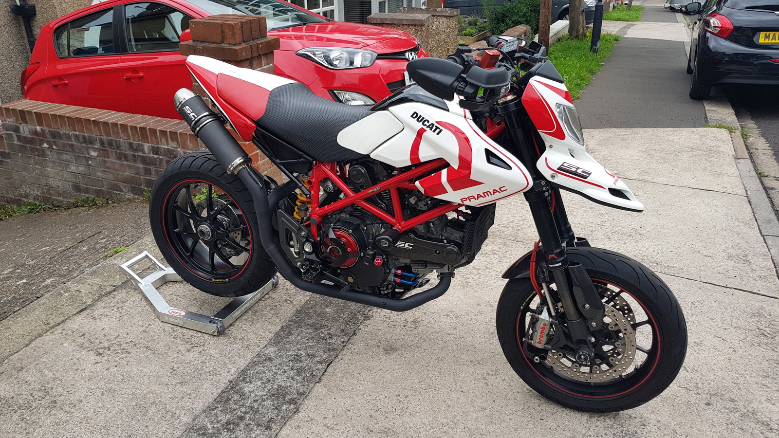

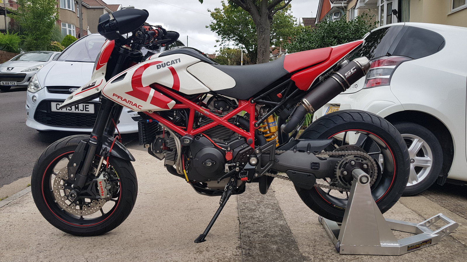

  14. Ready for test ride....been out all morning with my mate ( on the rsv i might add )...just got back in...pushing it to go straight back out...here it is in its cerakoted glory...

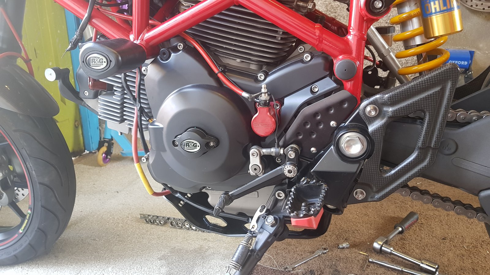

  15. Just for the record if anyone is considering stripping one of these down to the frame, ( bar the engine ) pretty straight forward and easy...
  16. Assuming fired up all ok no issues?
  17. Yep..pretty well on the button...!
  18. Initial test ride complete....a very gentle couple of miles round the block from my house done. No leaks, nothing fell off...the only thing was a couple of half turns on the exhaust bolts to tighten them up a bit more. First impressions....smooth smooth smooth....definately smoother ( paid a couple of hundred to the have the crank balanced and its definately better than it was before. Head work: hard to say as ive not opened it up but initally it feels more torquier....time will tell on that front. Sounds a tad deeper too but thats probably cos theres more volume now in the exhausts ports...
    Otherwise, brilliant, more than happy.
