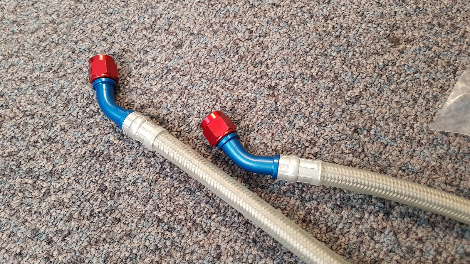

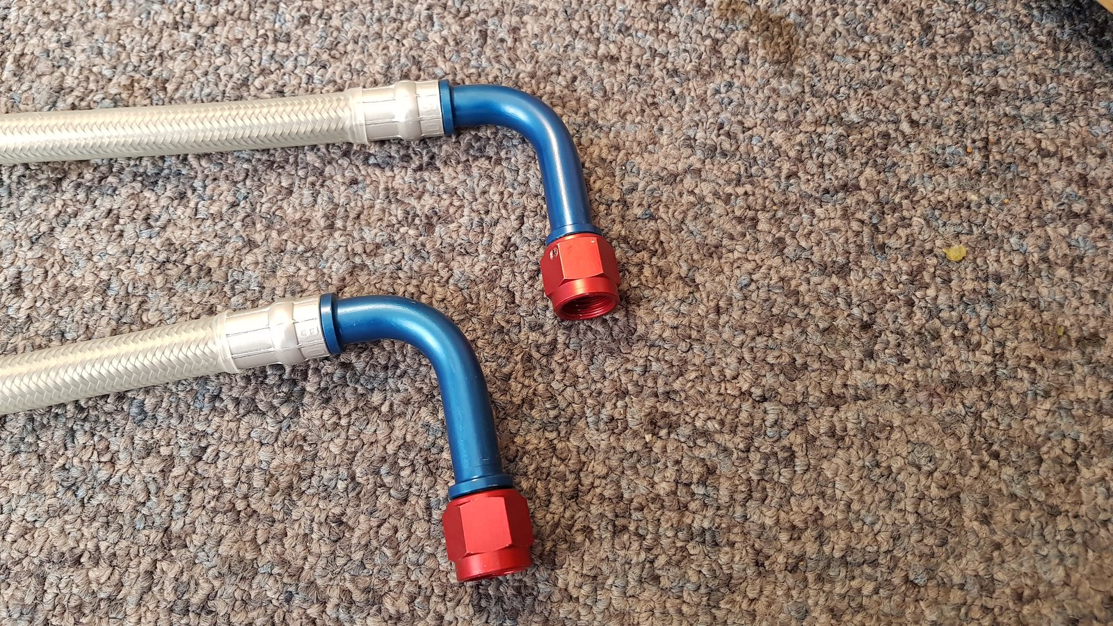

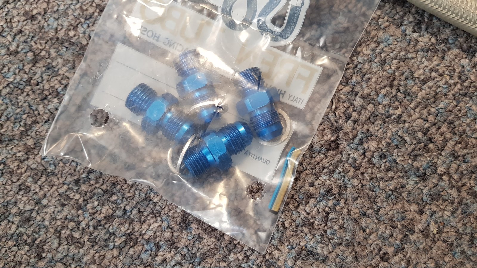

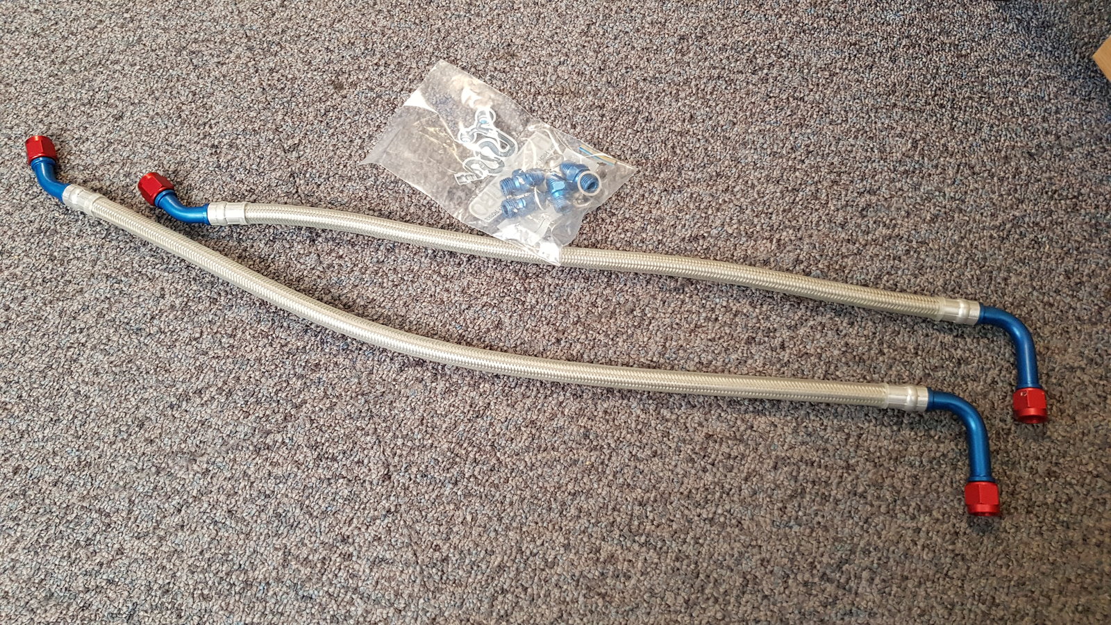

  15. Ordered and here!.....took about 10 days to turn up...went on the recommendation - ordered some Frentubo lines from Omnia racing in italy...
    20171130_132450.jpg 20171130_132455.jpg 20171130_132503.jpg 20171130_132511.jpg
    #15 comfysofa, Nov 30, 2017
  16. Are those ally connectors?
    If so, be very, very careful with them as they are known to rot and break apart!
    I have a video somewhere of some similar brake lines that I will try and find and post up; a slight tug with a spanner to get them undone and they fall apart!
  17. Funnily enough i asked this very question before i purchased....i asked for stainless....Omnia said Frentubo didnt supply any fittings in stainless as it reacted with the rad....im not qualified to tell them what they should and should not be using so, ive gone with it....ill put it up on my fettling thread - if i can find it!
  18. Ooh they look sexy!! I like those!!
    Think they'll be fine - the oil lines on my race car had ally connectors - never had a problem with them!
  19. Oh but be gentle with the spanner when tightening - the anodising can mark or scratch off :-(
