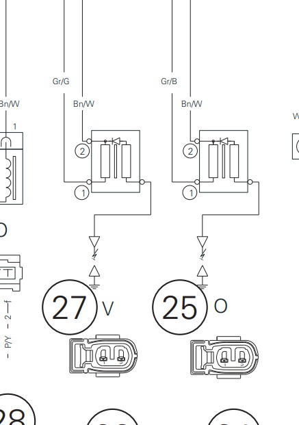

  1. As above. Im in the middle of upgrading my coils to a set of Dyna 3Ohm coils which have a simple slide connector - the oem's have a plug which ill have to remove - trying to decipher the wiring diagram...why cant they just put a "+" next to the positive fucking wire....could anyone tell me which is which??
    Broww/White = ?
    Blue = ?
    If someone could point me in the right direction please chaps....tar.
  2. Haven't seen the wiring diagram but on Ducatis the brown/white is usually the positive.
  3. Cheers sir....ive got the manual here....heres a quick snip...
  4. Yes, that confirms it. B/W is +ve
  5. Brilliant! - i can carry on! cheers sir. Thanks.
