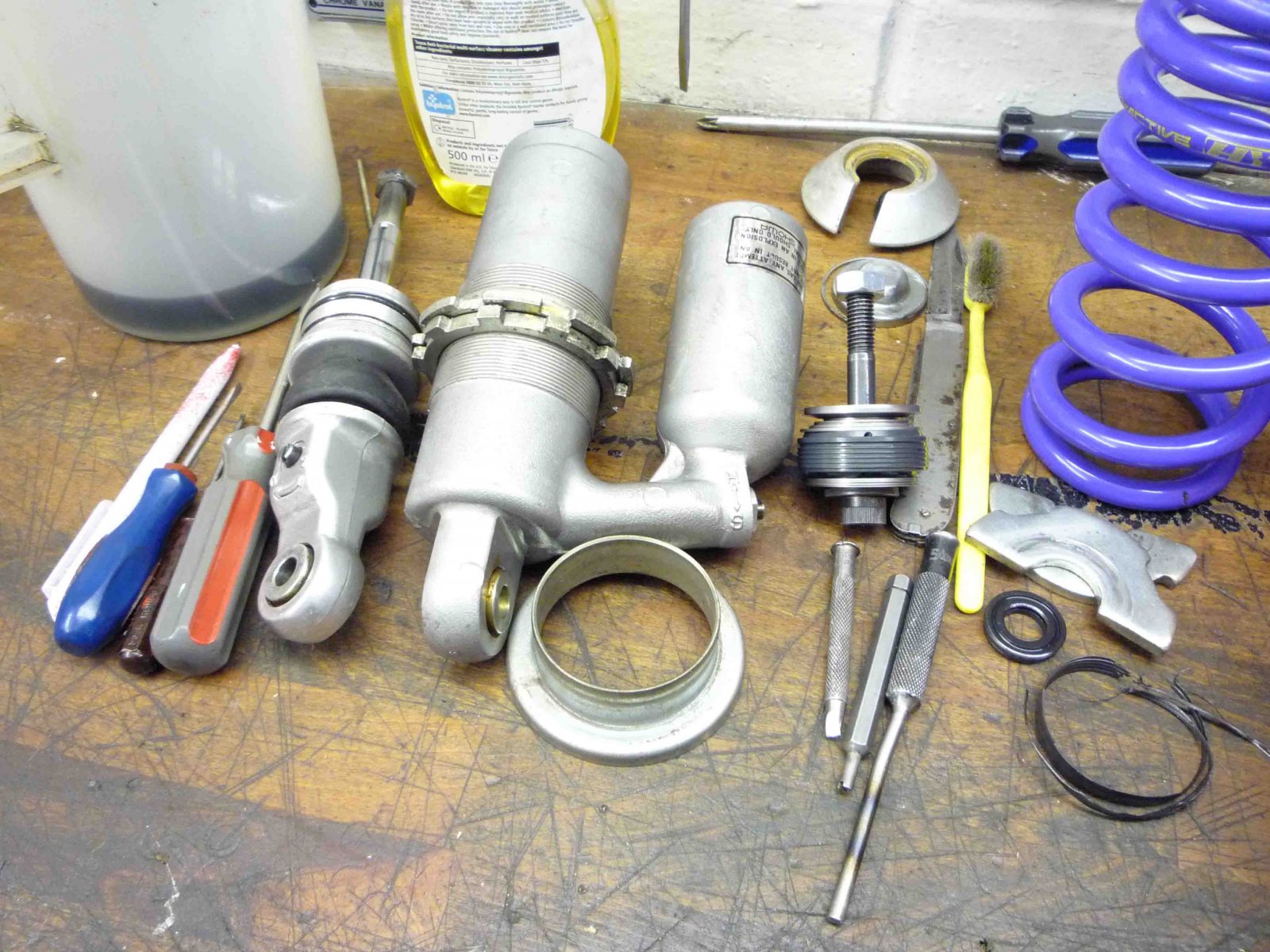

  1. Here's my Showa in bits when it was at a specialist for rebuilding........recharging done after removing the reservoir cap IIRC. Showa in bits.jpg
  2. From memory, Sachs can't be rebuilt and Showa etc can. Think the cheapest Maxton can't be either but that may be nitron I'm thinking of.

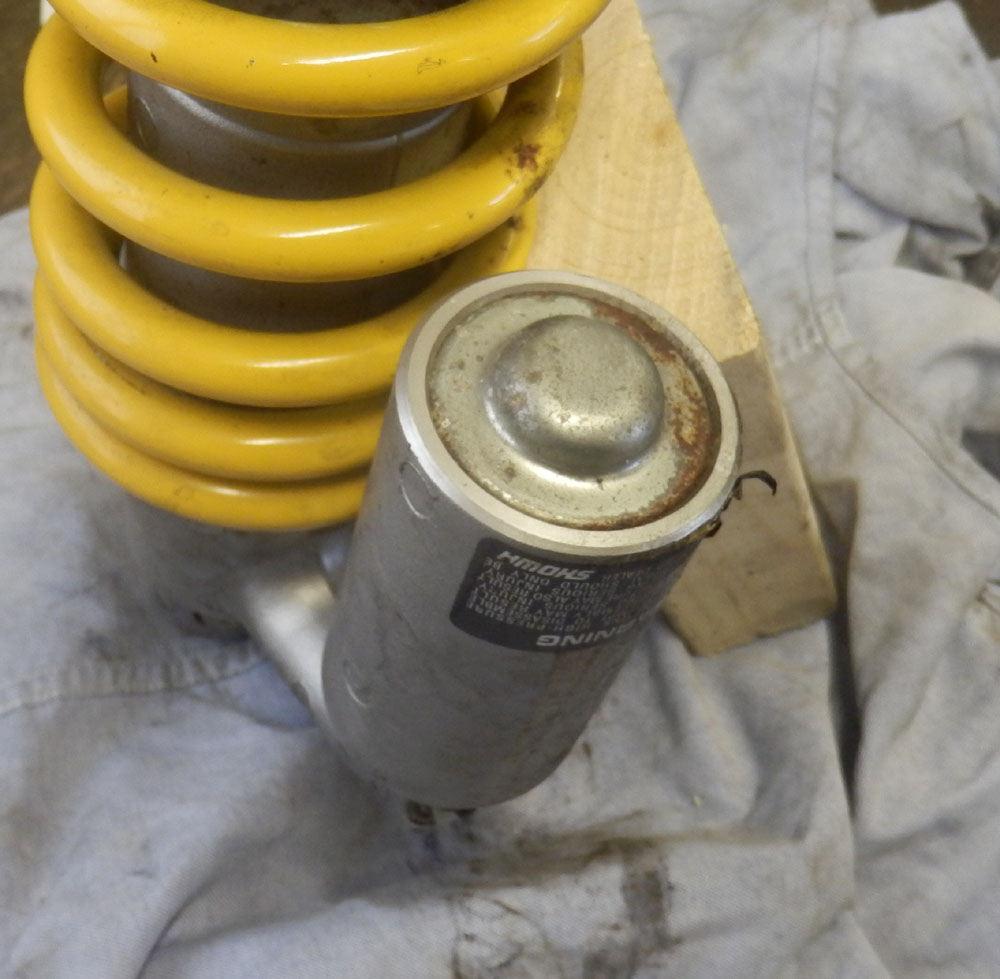

  3. Thanks Guys.
    Arquebus, are you saying there is a valve for recharging under this cap?
    Thanks
    Nasher
  5. I'm sure you know what you are doing, but remember this things can be under high pressure when taking them off. :)
  6. IIRC the cover is just a cover held in place with a wire circlip - no pressure.
    Once the cover is off and the valve cap is removed, the nitrogen is pumped in or released via the valve, which I think is similar to a tyre valve.
    Sorry, can't tell you what the pressure should be, although 100 psi rings a bell - don't take my word for it, though.
