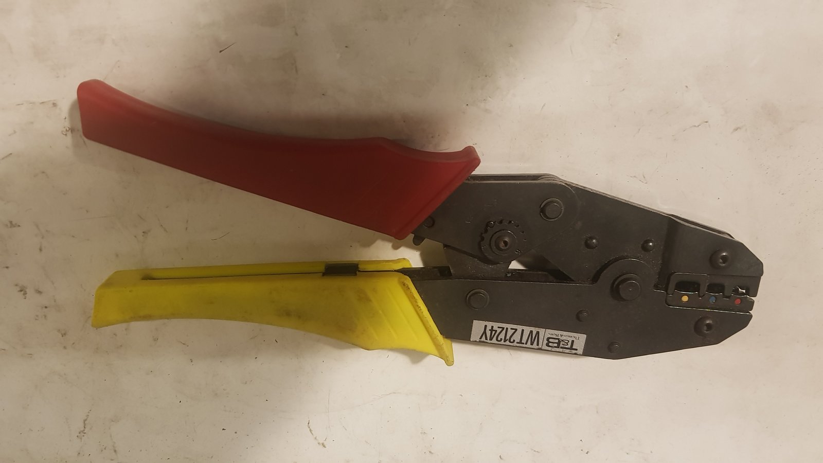

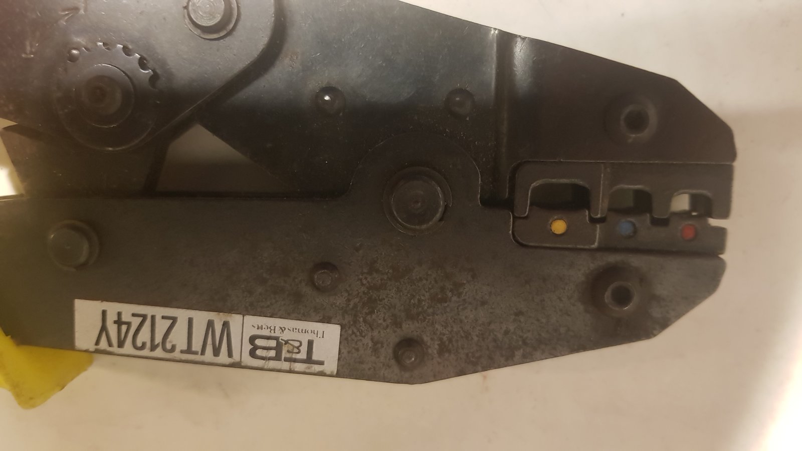

  2. Here you go...I got the as one of our wiring techs at work uses them all the time and swears by the...
    Thomas & Betts are the manufacturer.
  3. Many people swear *at*, not *by* those types of crimps :confounded:
    A lot of it is down to the quality of the tool. T&B are reputable, but there are a lot of cheap crimp tools out there which look identical but are total crap.
    I always solder and heat shrink connections wherever possible. Never had one fail.
  4. As do I, however sometimes a crimp is better if there's a bit of movement as it can break if too rigid with solder
  5. ill always solder - i only use these for where slide and bullet connectors are needed.
