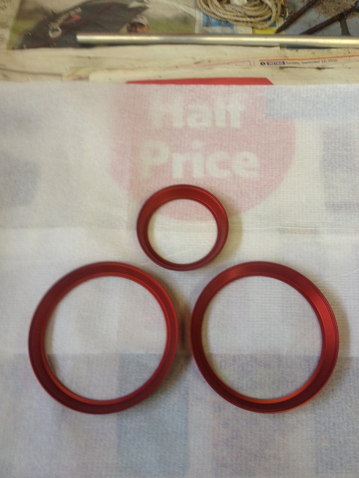

  11. I have a set of these which use glass instead of plastic inside the bezels. I've yet to fit them as my ordinary bezels are still OK at the moment. These have been machined and then anodised. The other photo is my DP dials as fitted by Superdials.
