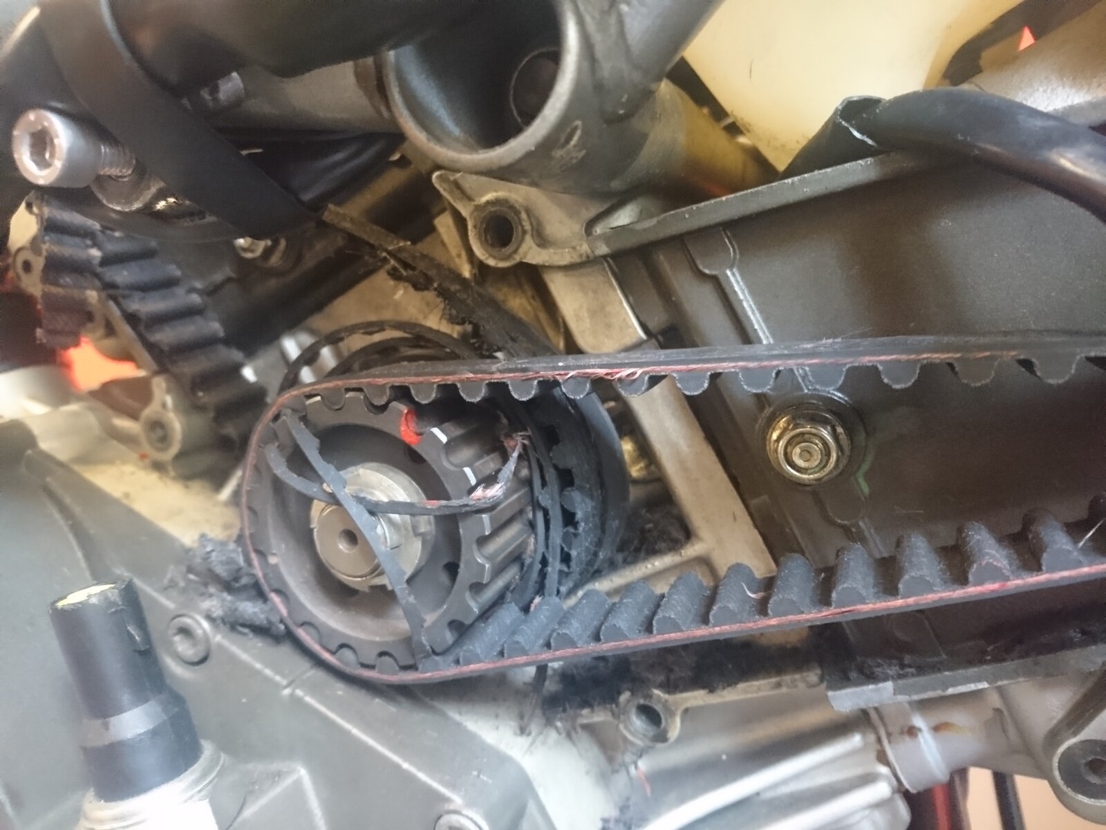

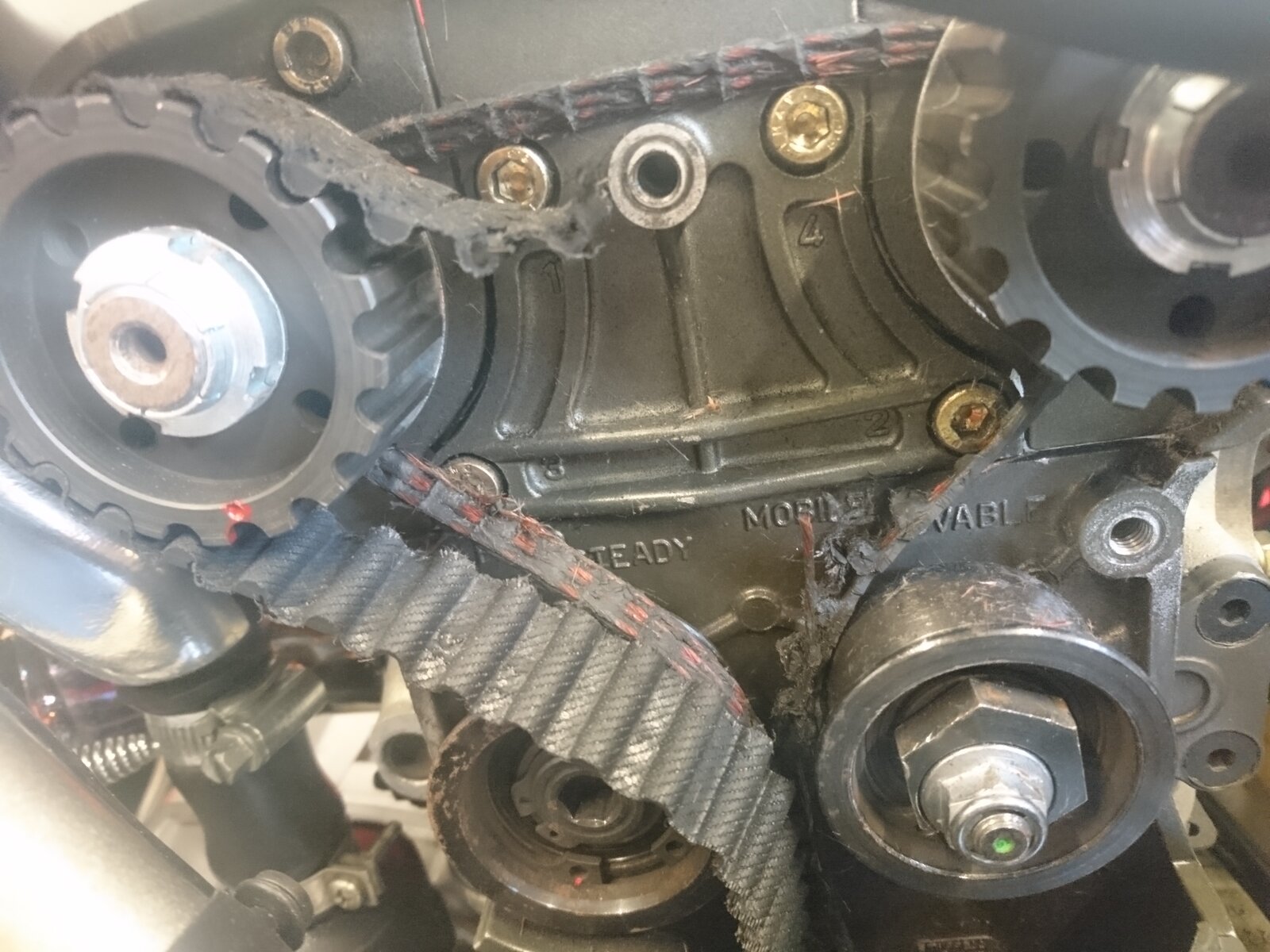

  1. First ride this year and I'd been having a great time, then just exiting a mini roundabout and all power's lost. Thought the chain had come off with the racket it made so whipped in the clutch and had a quick look. Chain still on so now thinking that's bad, and it was.
    I've only had a quick look as yet and damage appears to be on the vertical cylinder only. The cams turn and valves open and close. Rotate the cams fully however and both are binding terribly.
    Anyone what some used belts? They only have 130 miles on them
    I think I'll go and stand over here with TelRobinson.:oops:

  4. How did that happen? What’s the cause?
  5. Was the tensioner done the wrong way?
    • Nuke Post Nuke Post x 1

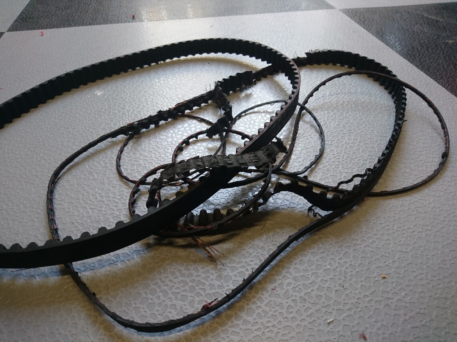

  6. Looks like the back of the belt has melted - seized idler roller?
  7. Broken belt...
  8. Looks like some delamination on there too.
  9. What sort of battery does the bike have?..... Lithium :astonished:
  10. Oh mate, not good at all. The tensioner seized on mine and cocked mine up. Hopefully you minimised the damage by switching it off quick
  11. Tensioner is rotated the correct way.
  12. Sorry for your loss dude... at least one belt looks ok...

    Possible weak spot created by sitting on the pulley all winter? Very sorry to see that. :(
    I'm just as guilty. Fired up the 916 for the first time since October the other day and rode off for 25 miles. Was just keen to hit the road, so didn't bother checking much apart from oil level and tire pressure.
    Could've been any of us.
  18. Think il get the belts changed on my 996 soon. It has been 4 years since they were done last :astonished:
  19. 99.99 % of times it's a fitment or other mechanical issue and in this case it deffo looks mechanical - the poor belt is still in a ring so it did very well not to snap! :eek:
    But 4 years (even if low mileage) is starting to increase that slim percentage mentioned above.
