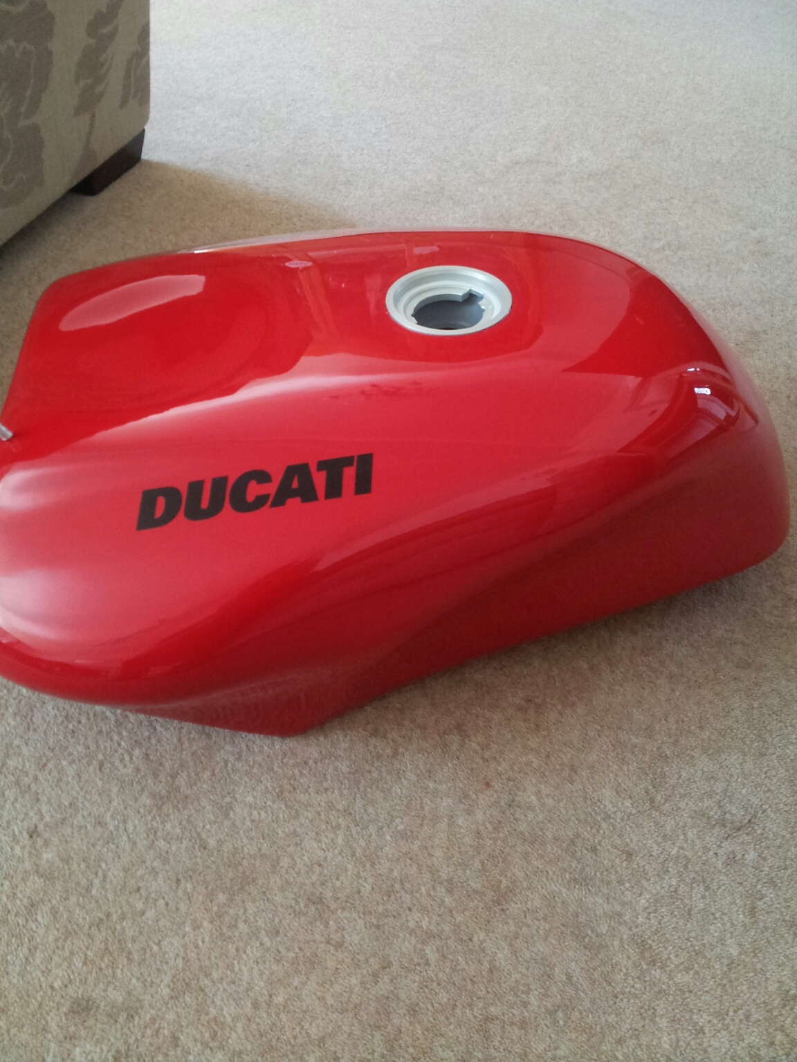

    I’ve done all the above, fitted most of the lightest bits possible.
    Ti bolts everywhere including engine mounting bolts and swing arm spindle. Carbon fibre bodywork including the 21 litre tank. BST wheels, lithium battery, mono sub frame.
    Only thing left to do is the engine blueprint.
    Probably lost maybe 15 to 20 kgs off the initial biposto std bike. It has cost me a fortune but have enjoyed every minute working on it and it is a stunning bike.

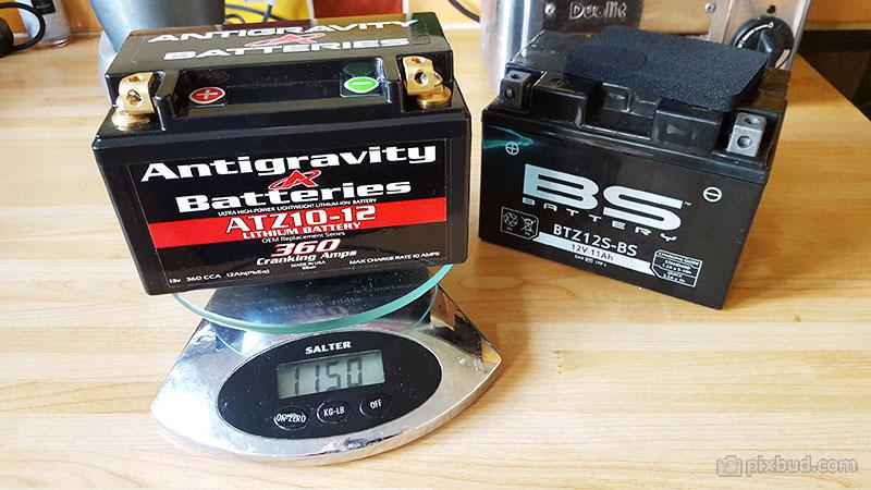

  17. Whilst you may want to go for a smaller racing LiPo battery, and I don't know the size of your existing battery, I have a Antigravity ATZ10-12 that I had fitted to the MV for a year. Took that off before part ex'ing it. About half the weight of the one it replaced. Always kept on a LiPo Optimate when not used for extended periods.
    If the size is right (151mm long, 86mm deep and 95mm high) and this won't fit the Mutley (will check later) then I could be convinced to part with these for £180 (for the battery and charger, over £300 new) plus delivery. The latter might be an issue as sending batteries though the post can be problematic.
    I'll post back if it doesn't fit (think it's too deep from what I can ascertain on-line).
