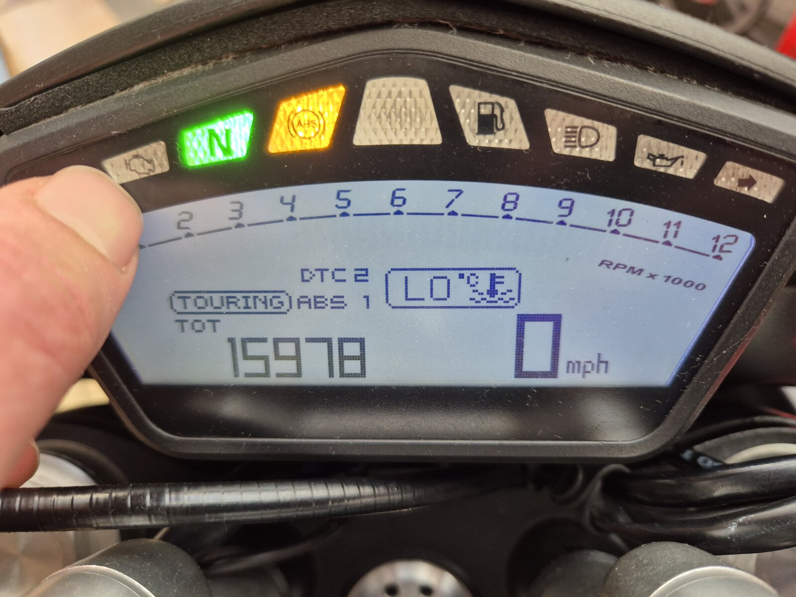

    Unfortunately all i can say is that 'error' appears on the dash next to the temp gauge a long with the engine light next to neutral. Where my thumb is pointed to in the image.
    It comes and goes as I'm riding and doesn't appear when I turn the electrics on

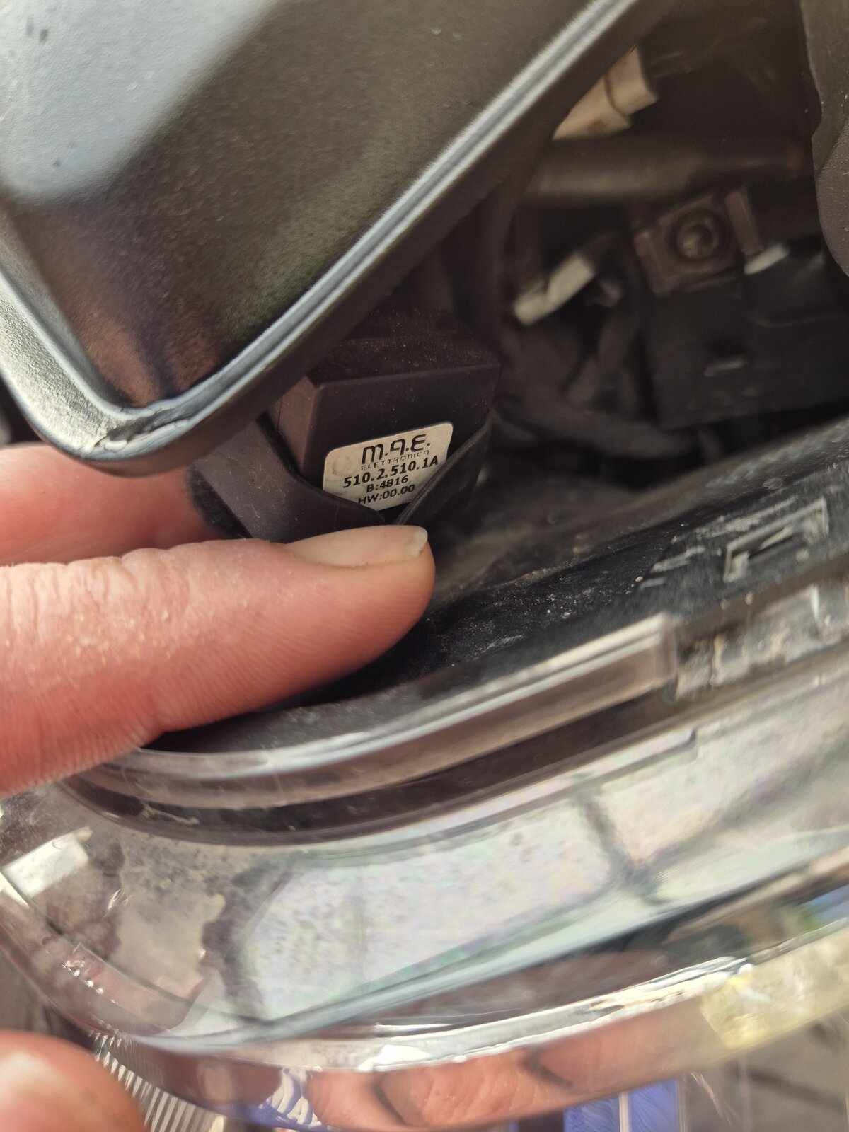

    Good news @West Cork Paul I've just checked the head unit and the little box with that part number is installed.
  16. :upyeah::upyeah:

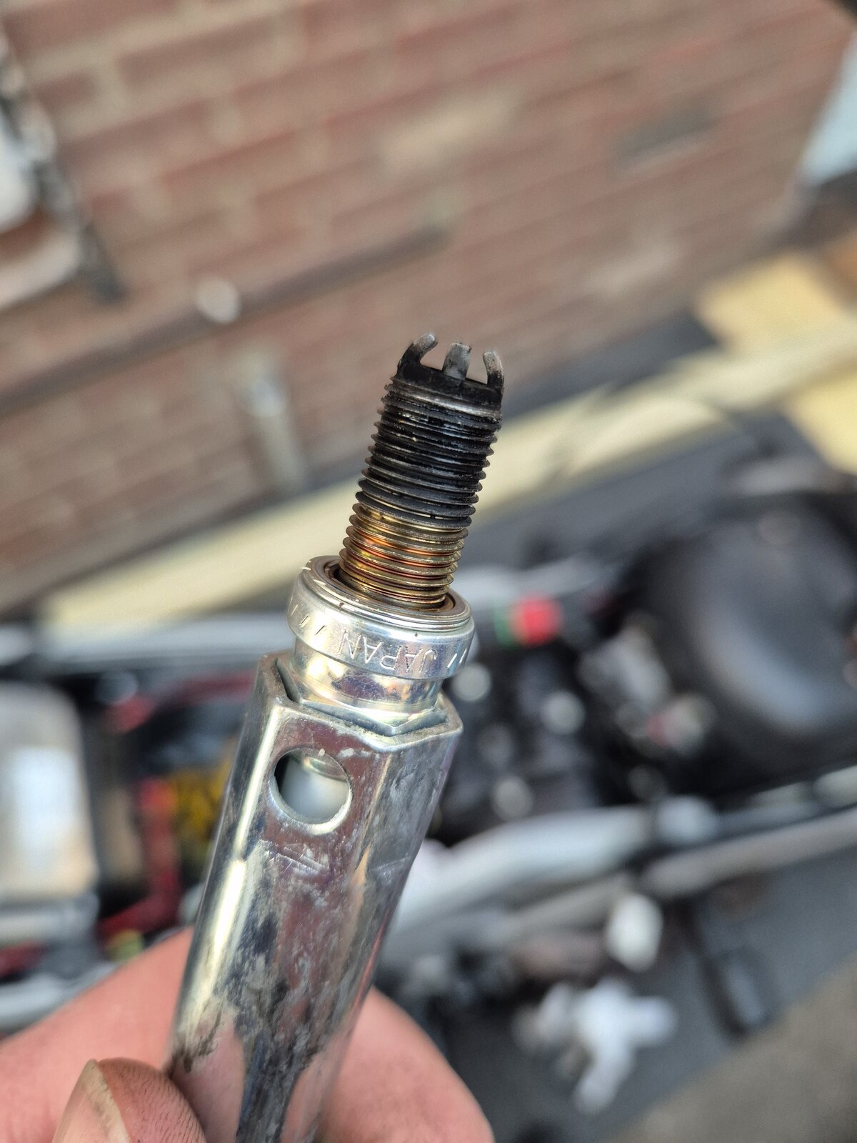

  18. Reading up online about spark plugs looking like this, it could throw an engine light. Could be what's causing my intermittent error on the dash, although I don't know if that's specific to my model or just cars perhaps. We'll see with the new spark plugs and eldor coils now fitted, once I run the bike
  19. A faulty, or failing, spark plug will only throw an error if the engine has knock sensors fitted. Even then it’s not the spark plug throwing the error but the knock sensor picking up and reporting a misfire. I haven’t checked the parts diag but I’m confident there are no knock sensors on your engine.
    The plug itself is ‘dumb’ it doesn’t feed any signal back to the ECU. That plug isn’t the cause of your EML. It won’t hurt to fit a new plug though now it’s out. NGK MAR9A-J is the correct plug for your bike.
  20. cant say for ducati but i have seen this back in my fiat days. incorrect plugs, or even a mismatch in age/millage of plugs would throw up all sorts of CAN and component errors. often injector circuit errors on the 2.4's . and could even cause the car to cut out on the smaller capacity fiats that used the same ecu's as ducati until either the errors were deleted or battery disconnected and then reconnected. i had one vehicle that took me an age to diagnose due to assuming it had been done properly elsewhere, you could draw a line on the road where it would cut out after resetting. it had two new plugs of one make, and two old of another.
