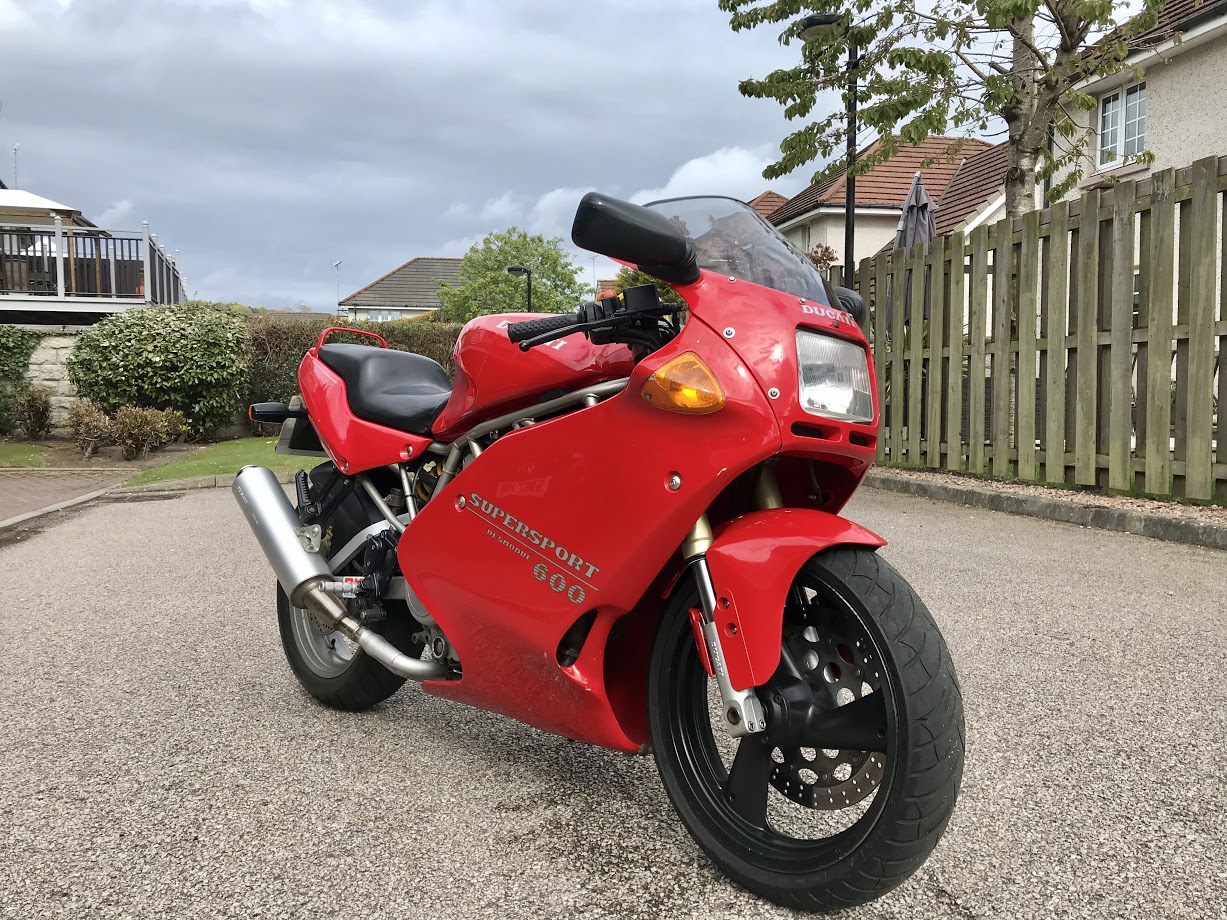

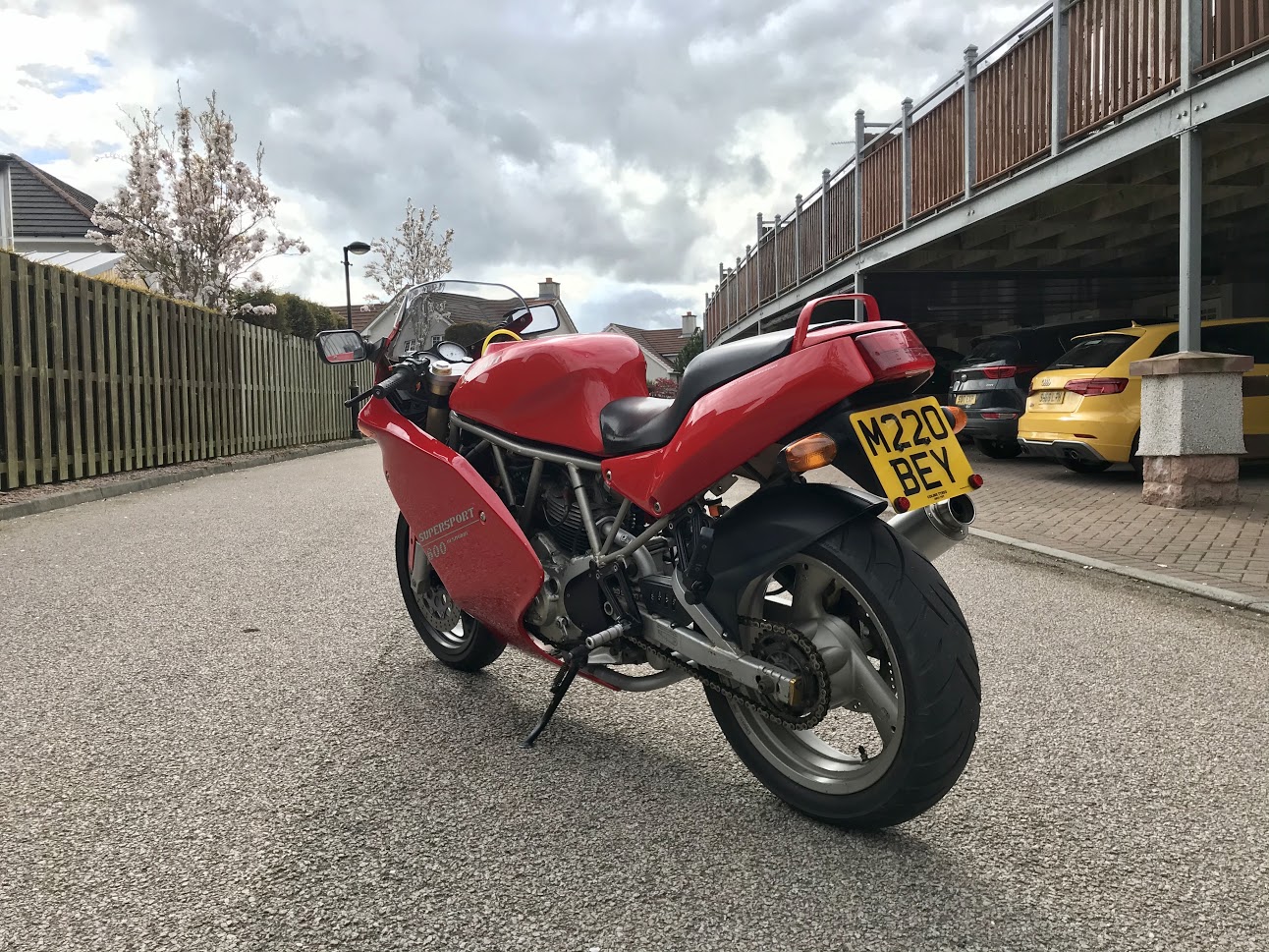

  10. It was just old fuel, picked up a gerry can of fresh juice, drained the bowls, filled her up and started immediately. A little rough to start with but the more I rode the bike the better it got. Now that I've got it all running and in a fairly decent state I think I'll put some miles on it and prepare it for sale. It's a lovely bike to ride but realistically I'd rarely choose it over the 748 and I've just purchased something very cheap and cheerful for my 4 mile commute. Condition wise the bike is at the stage where it's tidy enough to use regularly without feeling too precious about it, there's nothing more I'd want to do without doing a full rebuild and I just don't have the time and resources to do that.
