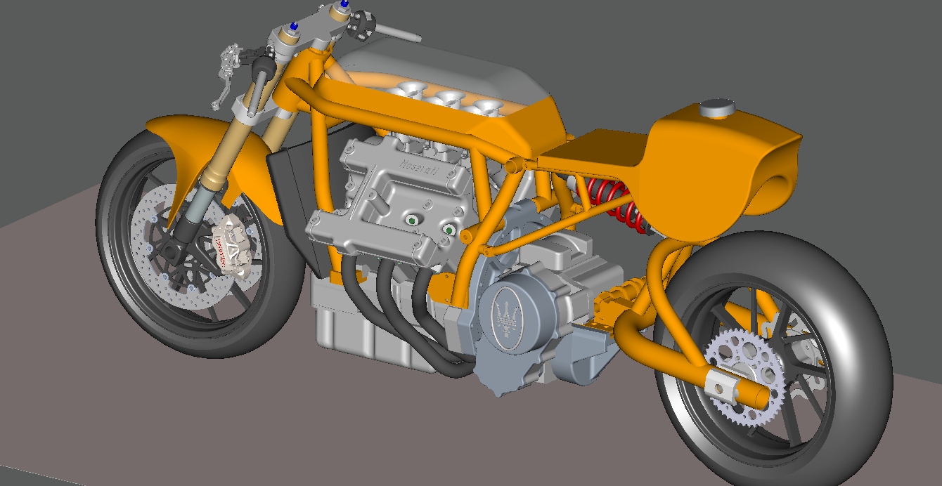

  3. I spoke too soon! I thought the ass looked a bit lardy, so I've trimmed it down. The software reckons it will hold 19 litres.

  4. [​IMG]

  6. That oddball Ducati ignition will work a treat on the Maserati, it's just the ticket for the 120-90 oddfire . I needed to lose the huge distributor and cap.
