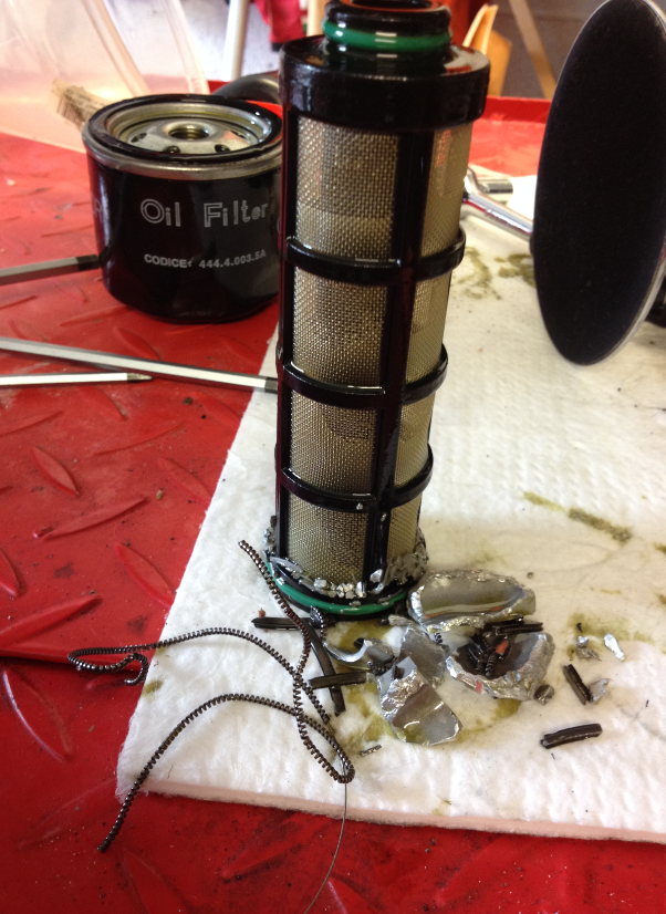

  5. Piston broke... :eek:
  6. Mary, you don't seem surprised by what you have found. I cannot believe that such damage was not extremely evident whilst you were driving it. I think it is called mechanical sympathy, those horrid mechanical noises you mention are the engine either saying "knock it off" or simply preparing itself for a £3,500 death.

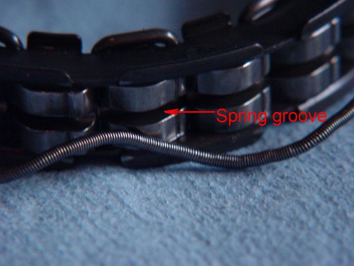

  8. Looks like it could be the sprag clutch lobe retaining spring and some of the magnet from the flywheel amongst general casing parts.
    If a piston detonated that bad I would have expected a lot more than a few nasty noises and a very quickly non running bike. If it is a piston, how it ran at all is a miracle.
  9. Spareparts has some s/h engine spares for sale.
    Def looks like an expander spring from the oil control ring.
  10. As mentioned, there was no drop off in performance at all.... The reason I had a mooch around down there is because I missed a couple of gears during a trackday. I'm glad I did judging on what I found... Yikes!!
  11. I thought sprag clutch spring when I saw pic.

  17. I changed the oil on my 1198 the other week and checked the
    gause filter and it was spotless but seeing your photo has made me shit my pants :Nailbiting:
