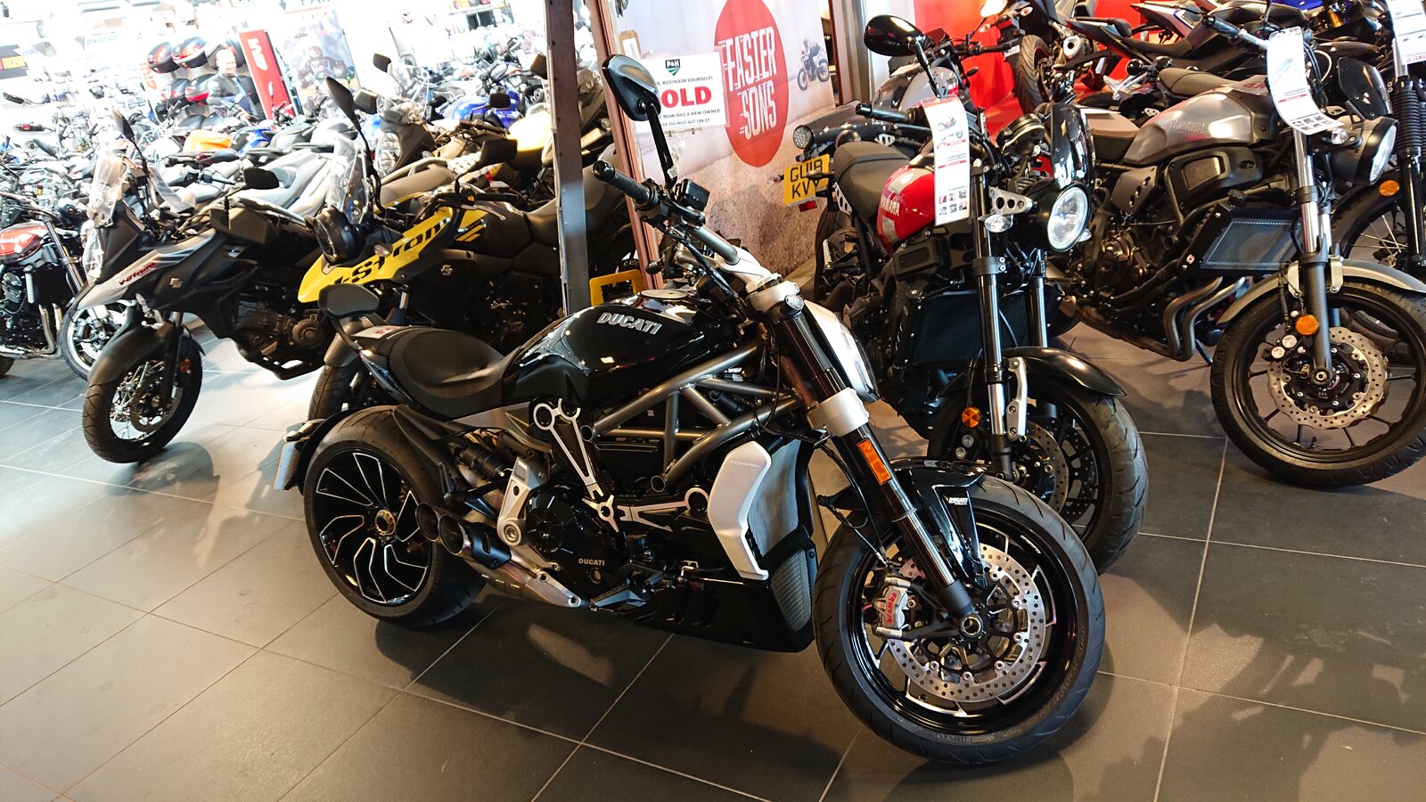

    Hope this is of some help. Good luck.
    Woodie
