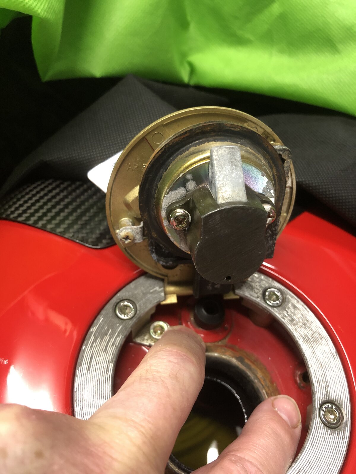

  1. My money is on blocked breather.
    Edit: remove the rubber grommet at the rear of the filler hole after removing the fuel cap. You may be able to clean it up from the outside only. If the grommet falls apart don’t worry - readily available for a couple of quid. Block the filler neck with tin foil first.
  3. Thanks Jack :upyeah:
    When I got finished work I had a look. The grommet was intact. I popped it off then I blew up the little hose that exits under the fairing and it seemed clear - no resistance at all ... I tried to start the bike with the cap open and no go .... does that square away the breather as a potential issue?

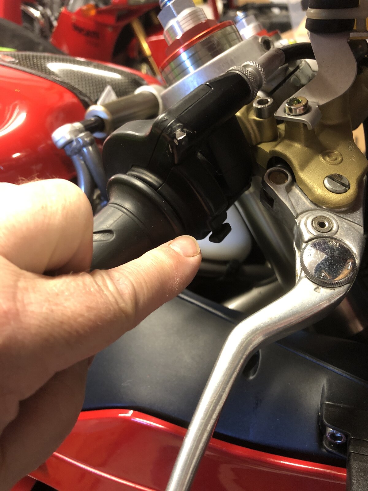

  11. Ok, I'll shoot over to the battery guys and get them to charge it :upyeah:

    You are turning the throttle about 1/3 of a turn then pushing the button up aren’t you? This in effect locks the throttle on. It disengaged the first time you manually close the throttle with your hand.
