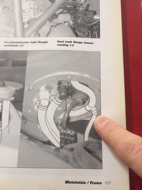

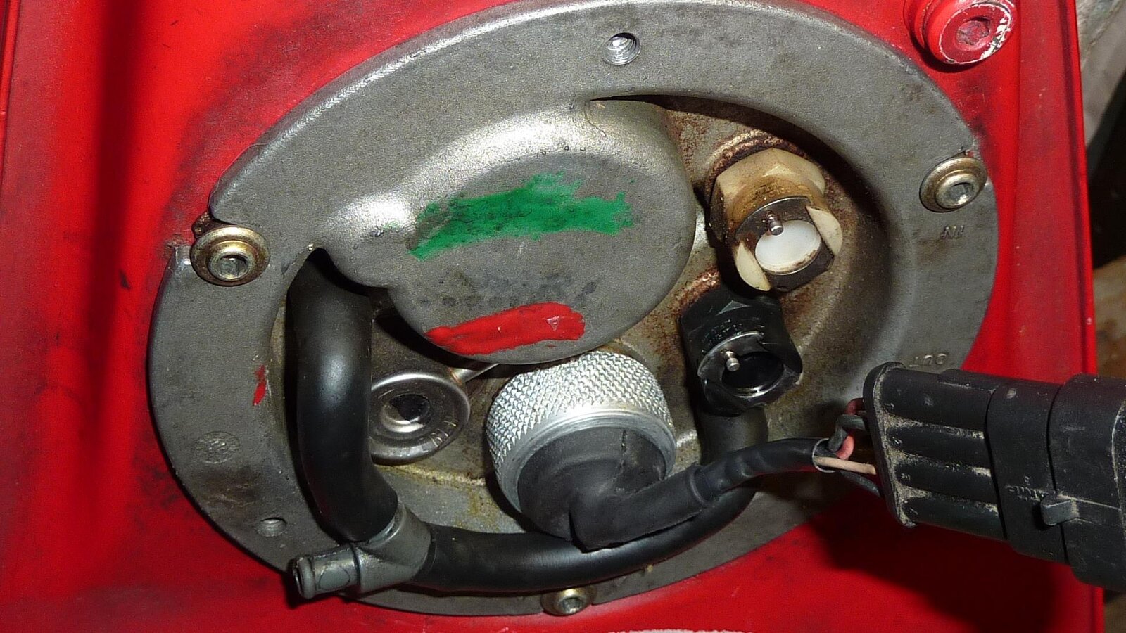

  5. One end should connect to the breather on the bottom of the fuel pump under the tank. 93.jpeg to the free end of the plastic y piece.
  6. Connects under the petrol tank and other end goes in a hole in the bottom of the fairing
    I was just taking a photo from the service book and Birdie has already got there :)

  10. The end circled on the right connects to the underside of the tank, near the fuel lines. The other pokes through a hole in the left hand fairing.
    If you hear the pump prime then that rules out the 2 big relays under the seat, the sidestand relay, and the sidestand switch.
  11. One bolt at the rear of the tank, lift gently and prop with something 3 or 4 in thick while you disconnect the fuel lines, they should be quick releice, squeeze the metal tab to releice and pull and twist the connector.
    Steve
    In the picture in my earlier post you can see the metal clips that have to be squeezed.

  14. On the fuel lines after pushing in the release tabs pull gently STRAIGHT down in line with the male pat attached to the tank. Best viewed from under the tank on the right hand side first - you will see what we mean.
  15. I put a jubilee clip around the same breather on mine, didn't need to take the tank off completely to get to it just propped it up a little, and was careful not put and strain on the main plugs into the tank
  16. Got it lifted and attached the tube pretty easily. I didn't take off the main fuel lines ... but they look ok to me..?
