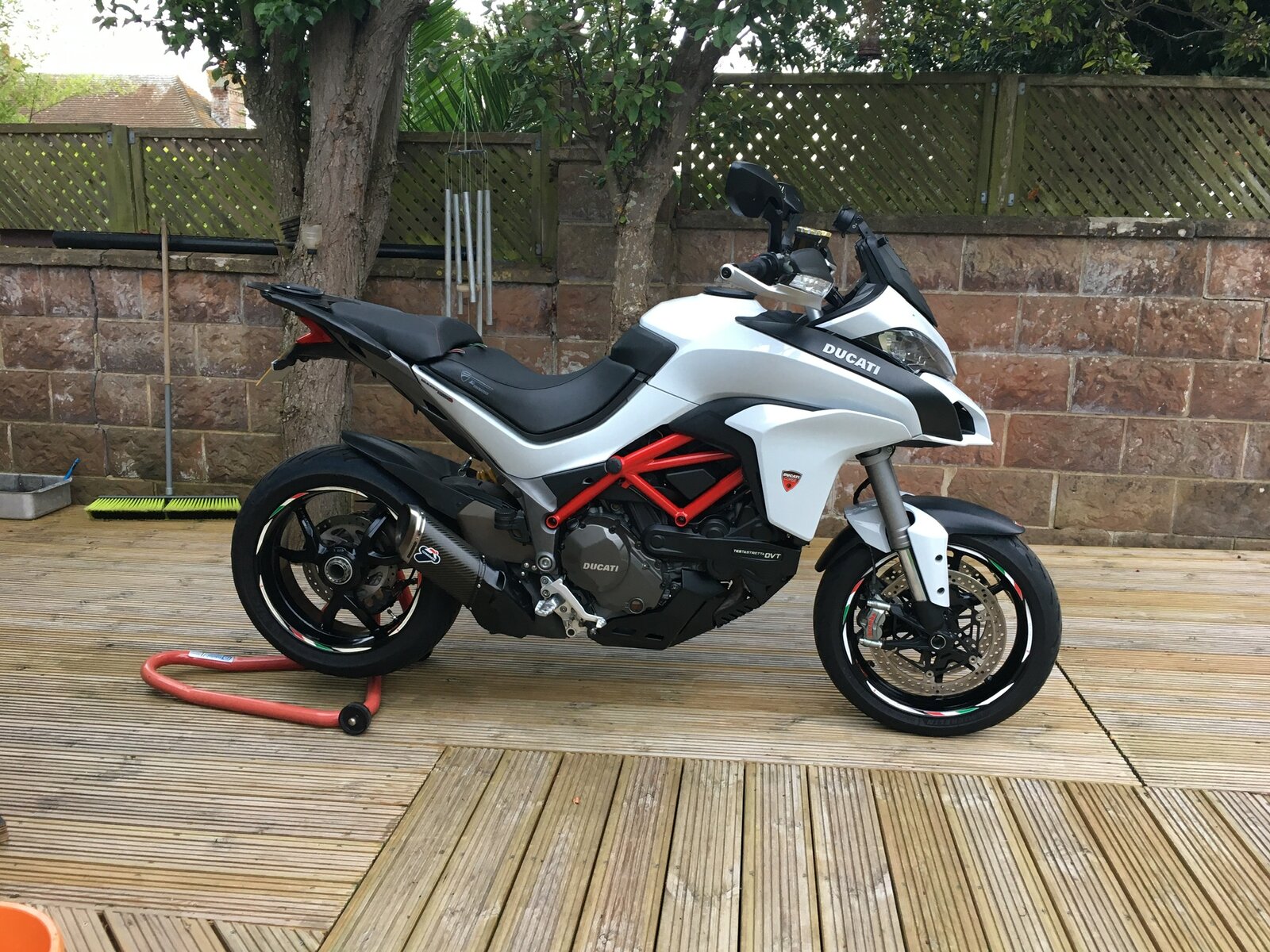

  1. Do the stick-on fork reflectors come off without causing hassle?
  2. Yes - use some solvent and tooth floss string or nylon thread to ease them off the fork legs, may then need a small careful clean up with solvent.
  3. Agree, just sounds ‘Better’ than standard
  4. Cable tie and WD40also works to get the reflectors off and then a plastic scraper
  5. OK cool, thanks for the help all...
  6. I like the black engine guard thingy. Is it carbon?
  7. Powder coated. When used in conjunction with the Evotech engine guard, it finishes off the bottom of the engine(IMO!)
    Exhaust box was painted with Hi Temp black paint. I whip it off occasionally and give it a quick going over with same paint. Seems to last quite well.
  8. Looks better than the silvery standard paint. Might get mine done...
  9. Exhaust box good in black too.
    I like the look of the Evotech guard on their website. Not impressed with the arty instructions though.
  10. +1 for powder coating the sump fairing and the pillion footrest hangers. The sump fairing powder coating takes a battering from front wheel debris so it needs touching up occasionally.
  11. Their products are top notch, instructions er.. a little wanting.!
    The guard is very simple to fit but beware, take great care when trying to loosen the exhaust flange nuts as they can shear, leaving you having to replace the studs. If the nuts look phuqqed put plenty of release agent on them, wire brush the thread showing and/or use a dremmel to split the nut. Easy to wind off when done.
    If nuts come off easy, replace afresh. I put titanium on mine and torqued to correct setting. 10nm, off top of my head
