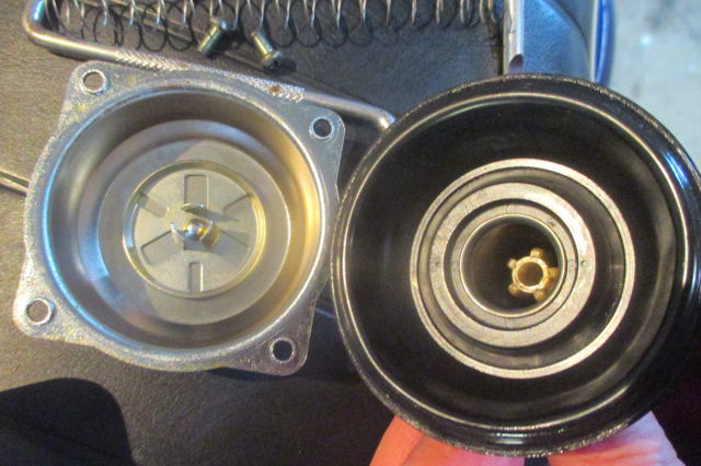

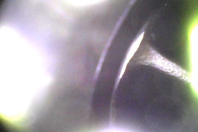

  9. Took the top off of one of the carburettors to have a look. Couldn't see anything that would stop the slide coming all the way up so no restriction there. Stuck my endoscope camera in the slide hole - after opening the throttle flap - and can't see any restriction there, so I assume that it is not restricted.
    There is a bit of a step mismatch between manifold and head - just in front of the two inlet tracts - the sort of thing I will sort out at some point in the future. (The endoscope camera no longer works 100% since it was immersed in transmission fluid, hence the poor photo).
    EDIT: These are a lot easier to work on than 900 carb. Supersports!

  10. No yours doesnt have them
    They are pretty easy to spot once apart like that
    I guess a pair of uk pipes and you will know i think i took off the egr stuff and blanked the diaphams on tne front of the heads and blanked off the airbox hole
