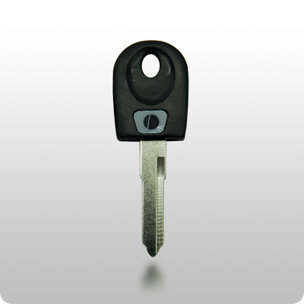

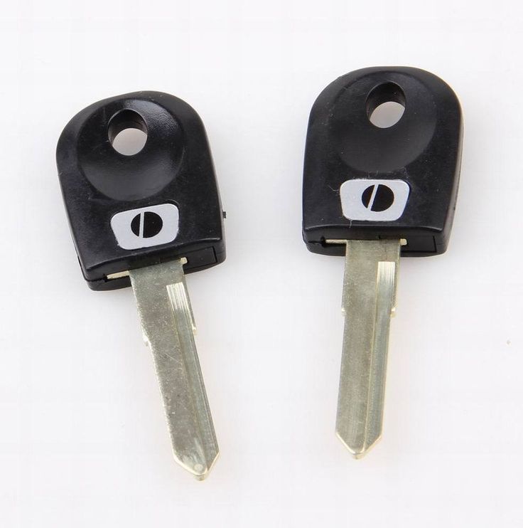

  2. At the moment this will work for chipped key bikes using the type of key in the above images
