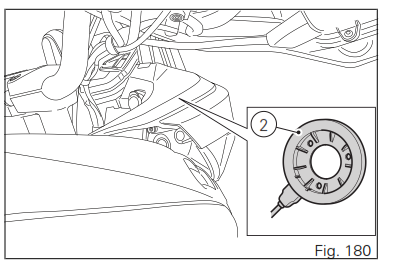

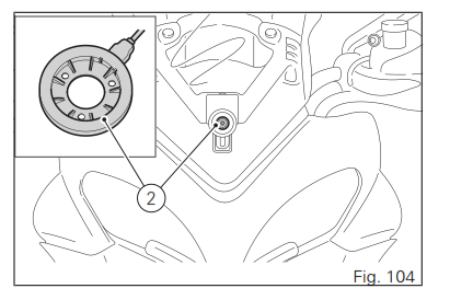

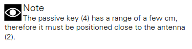

  7. So, just to confirm, the red key for my 1200DVT can be used to start the bike? Where abouts does it need to be held as I tried it and not a flicker?....
    Images above taken from the Controls section of the owner's manual for the DVT model.
    For 2010-2014 models, the antenna is in a different location.
    RTFM!
  9. The 1260 has what looks a little key symbol combined with a WiFi symbol moulded into the righthand black plastic fairing panel beneath and forward of the right hadlebar to indicate the antenna location. Not sure if the 1200 DVT has the same.

  11. Great info thanks guys, I tried the red key where the diagram said and bingo!
