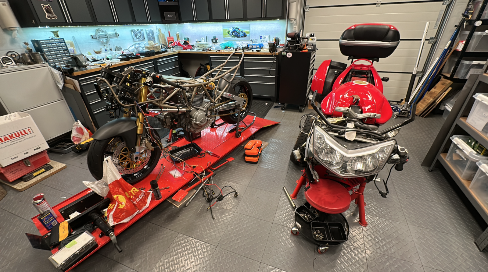

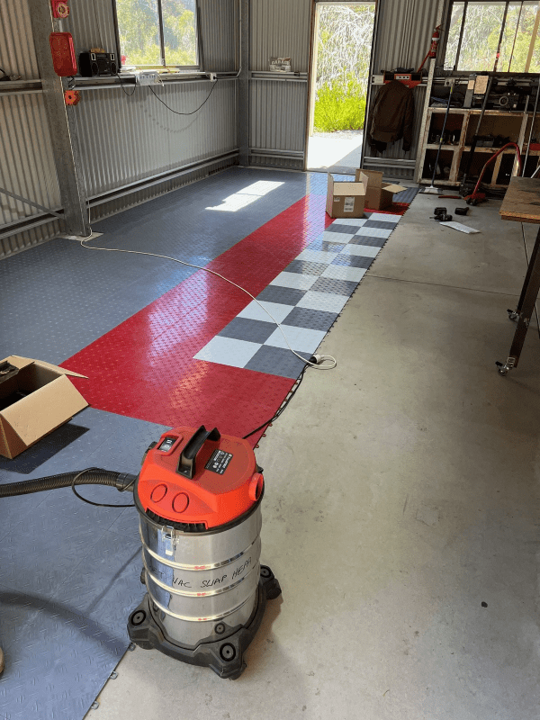

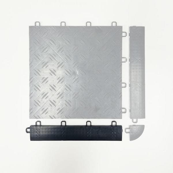

    I used a contrasting black edge strip (also comes in tile colour) to finish the door entry edge, tidies things up and removes an awkward lil’ step.

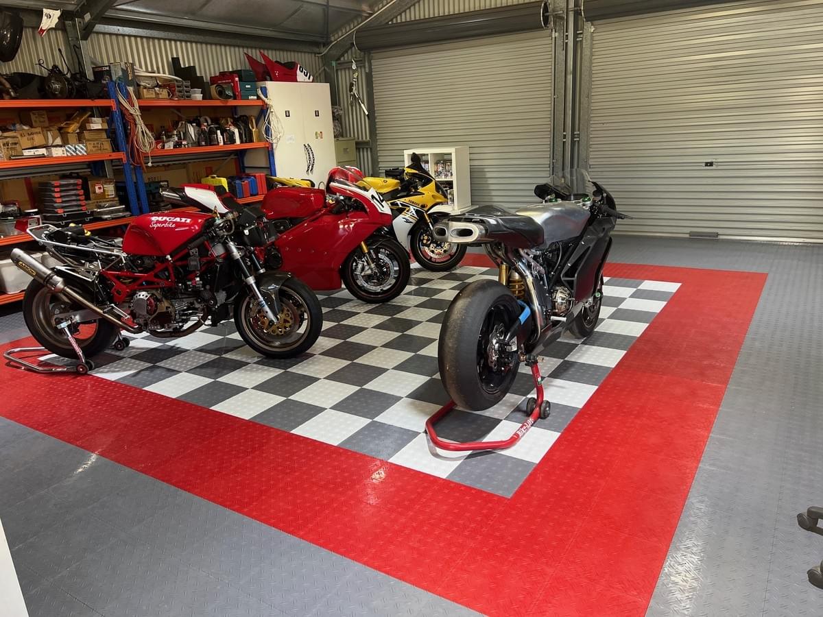

    Black/White checkers seems like a classic motoring combo and sounds good in theory but looking at various photo's on the 'net I found it absolutely dominated the area, all you can see is the checkers, everything else pales against them. So the above looks like Grey/White checkers, but is actually Dark Grey/Light Grey to sit a little more in the background, and realistically white just isn't practical for a grot like myself.
    Yup, high point loading/dropped heavy/pointy objects will damage the tiles, but they are easily replaced, just be sure to order a few extra.
    They are breathable, so no problem with damp/spills (not talking a flood here), and if you have THAT much water accumulating you’re pretty much buggered with ANY floor covering: the number one cause of failure with paint or epoxy coatings is moisture migrating through the concrete.

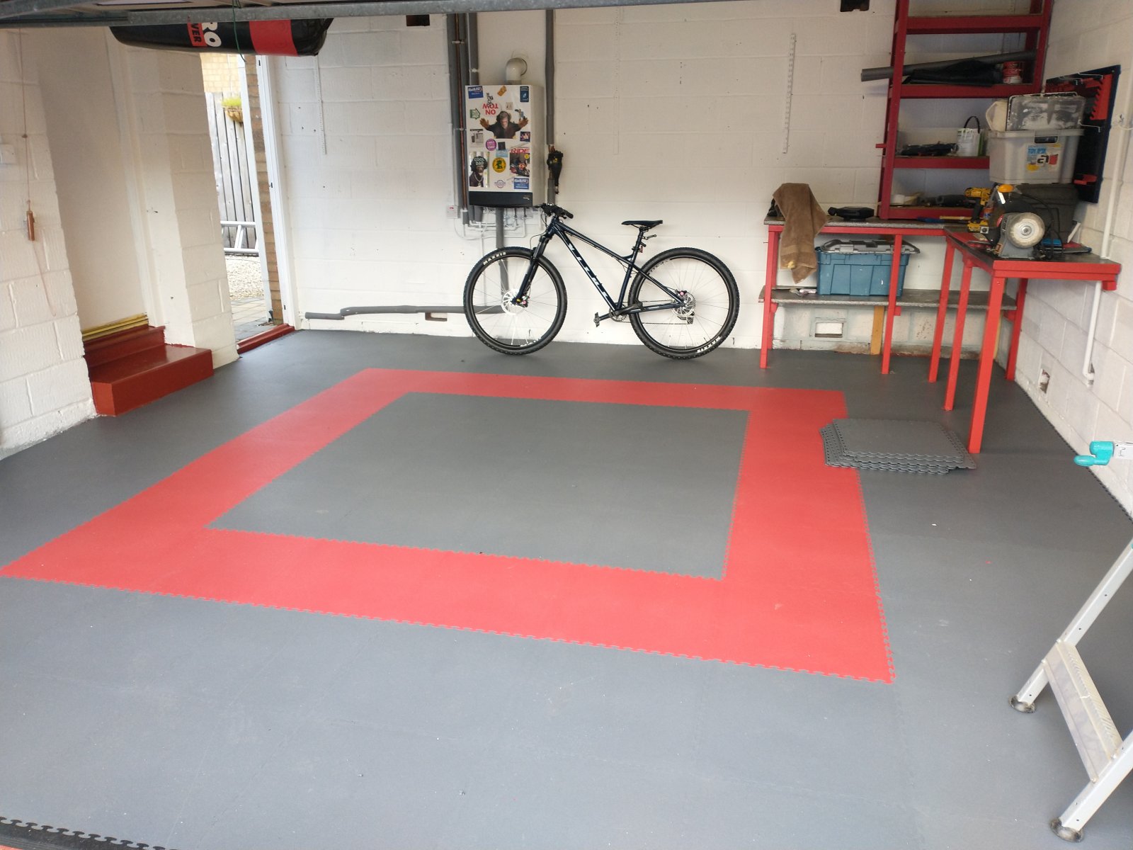

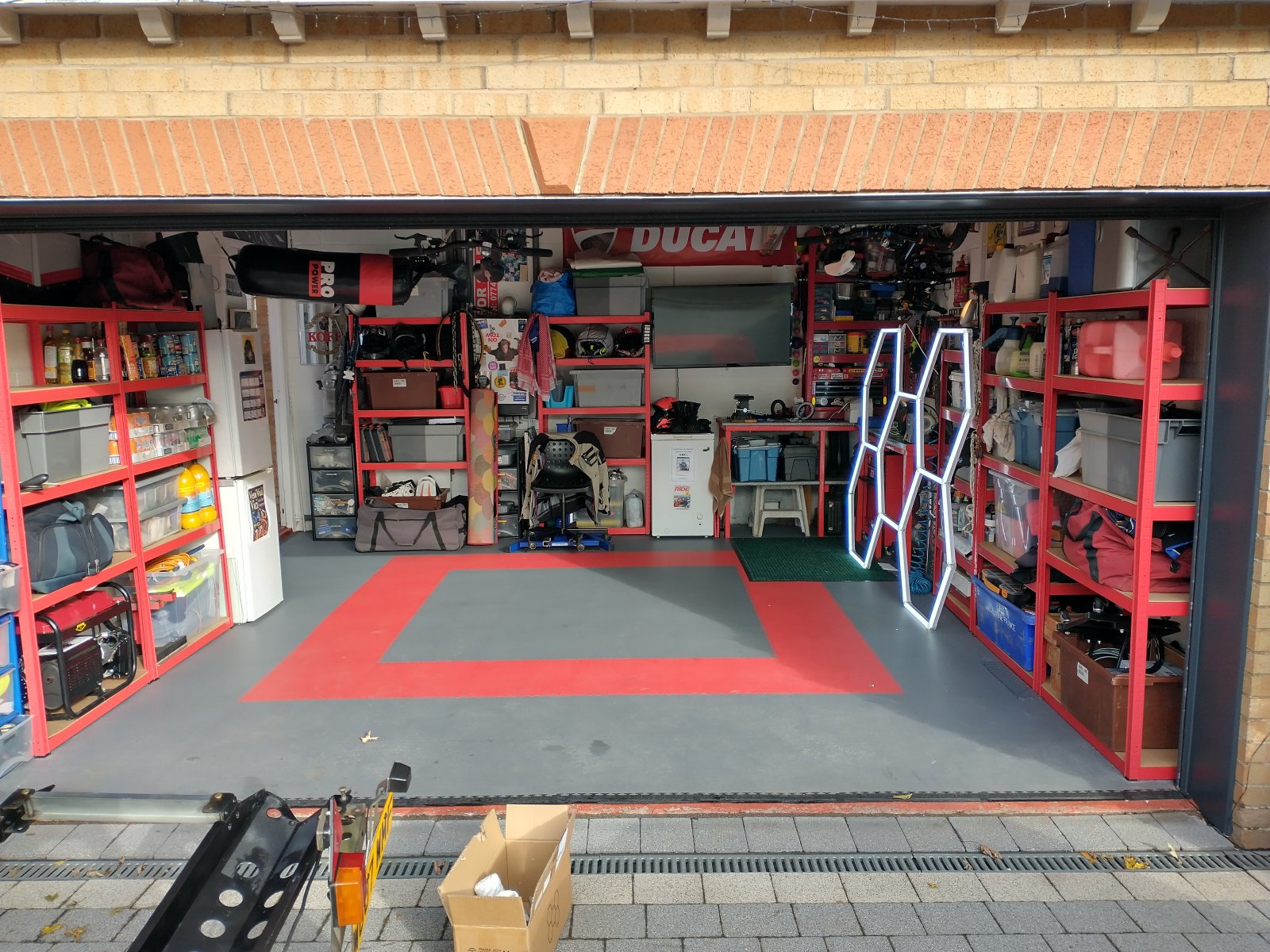

  8. Oops...anyhoo. thats mine above. Just completed a few weeks ago. Floor, paint, shelving, boxes, lights, sundries and double electric shutter on a 5*5m double garage..cost about 4700 quid on a five grand budget from SWMBO. Winner me! Room for about 6-8 bikes although I only have four now.
