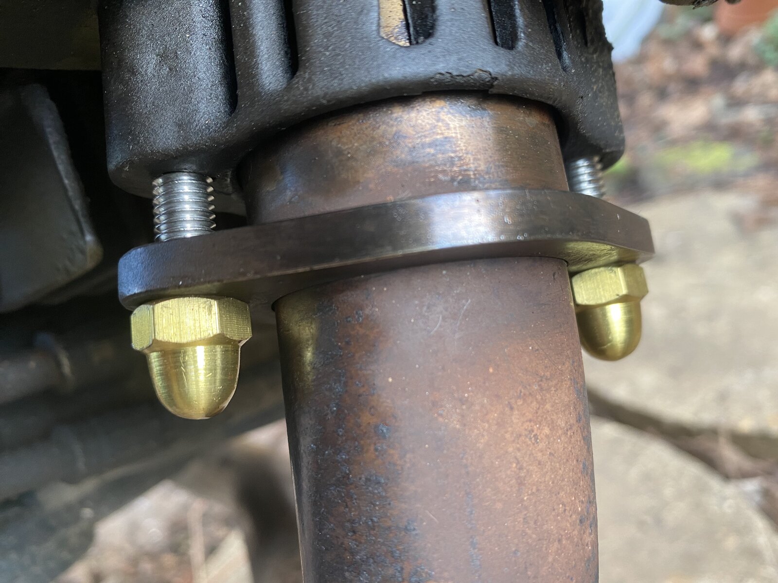

  13. btw - just did my last Multi with same engine as O.P.'s - stud length of 45mm is the shortest i would go - 50 would work also if you aren't fussy. I used lovely capped brass* nuts this time.
    *have always used brass out of choice, ditto on a car, for nearly 50 years.
