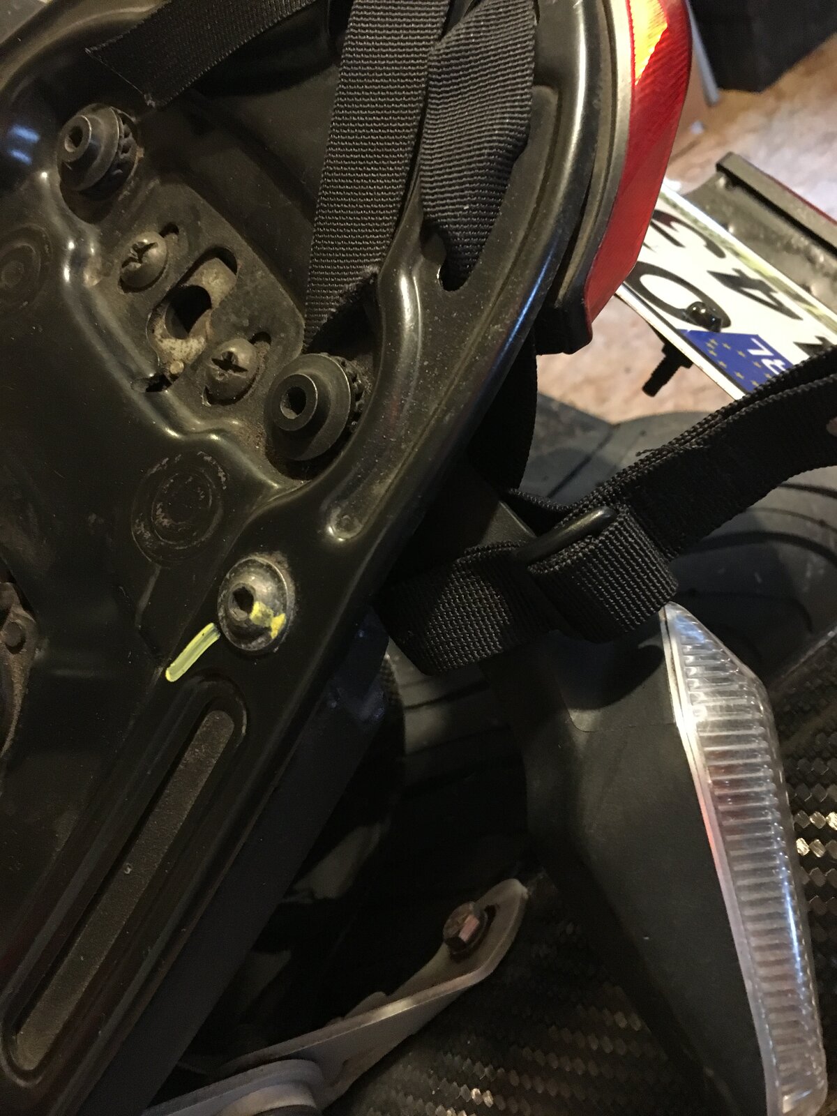

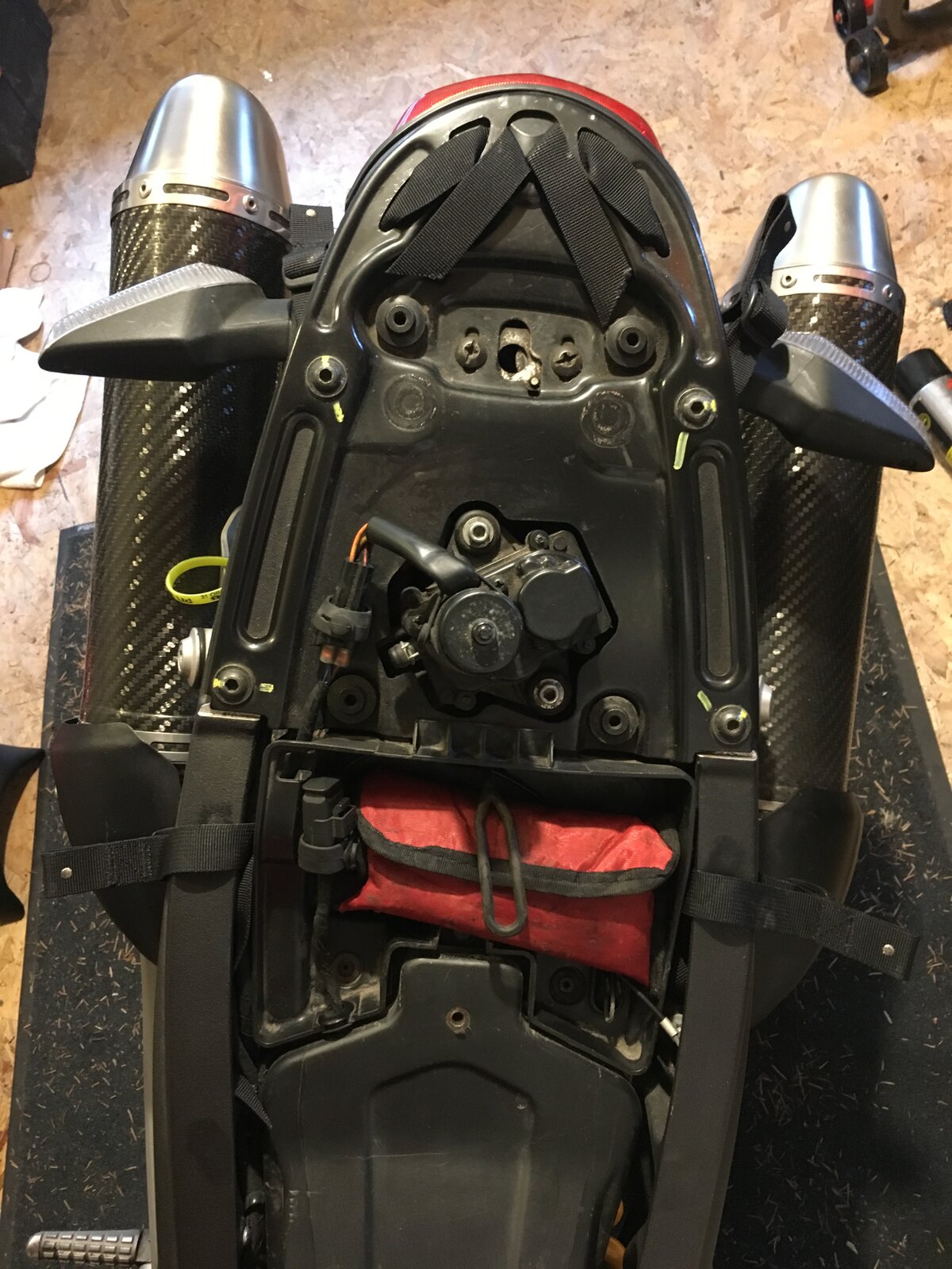

  5. Thanks Colin. I sussed it out in the end care of a thread & picture in the UKMOC forum. For anyone else in the future it looked like this when done. The front securing loops are around the subframe just ahead of the exhaust hangers that way they can’t slide backwards when accelerating. The rear loops are around the metal hangers the indicators attach to that way they they can slide neither back nor forwards.

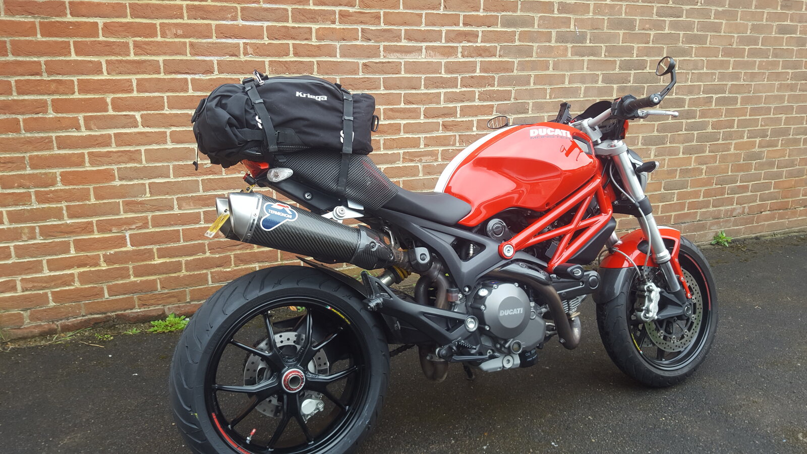

  7. 20190503_081726.jpg US30 on my 796

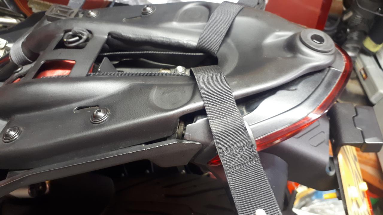

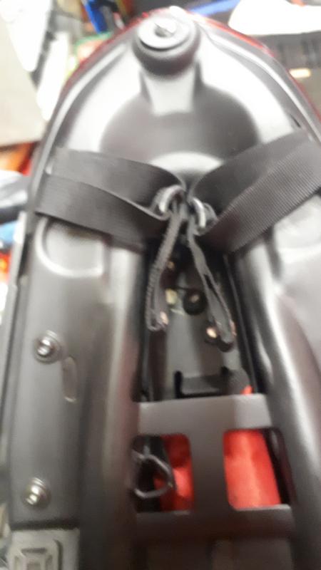

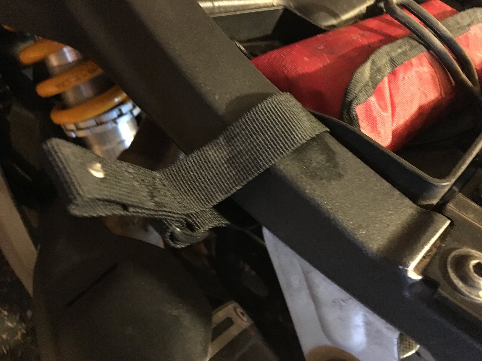

  9. Here's some pics for the 1200r subframe.
    You can rotate the rear straps round the frame and into the wee space around the seat locking thingy.
    It's a bit of a faff but doable.
    I'm on a FudFest to the Pyrenees in September and I reckon I'll be using the 30lt and 3x10lts or the 30lt with 2x20lts and a 10lt on top.
    With all them coupled together I need to have the 30lt running longways which isn't ideal, too effin cramped to be honest.
