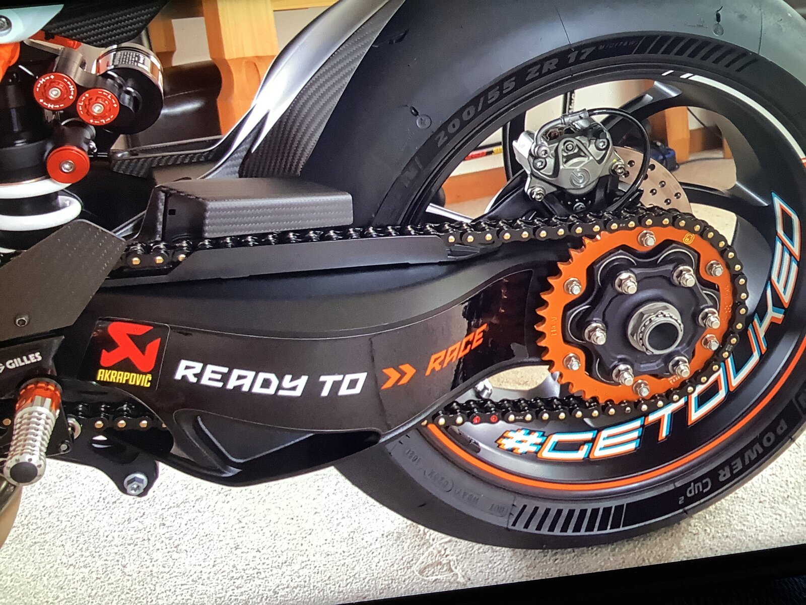

  8. Gen 3 front sprocket change is simpler, literally remove 2 bolts that hold the cover on and you have full access to sprocket nut. Definitely recommend 1 tooth down on the front, from 17 to 16 makes it way easier and punchier! As if it needed more get up and go. I changed mine out along with lightweight rear sprocket and RK chain…. image.jpg
