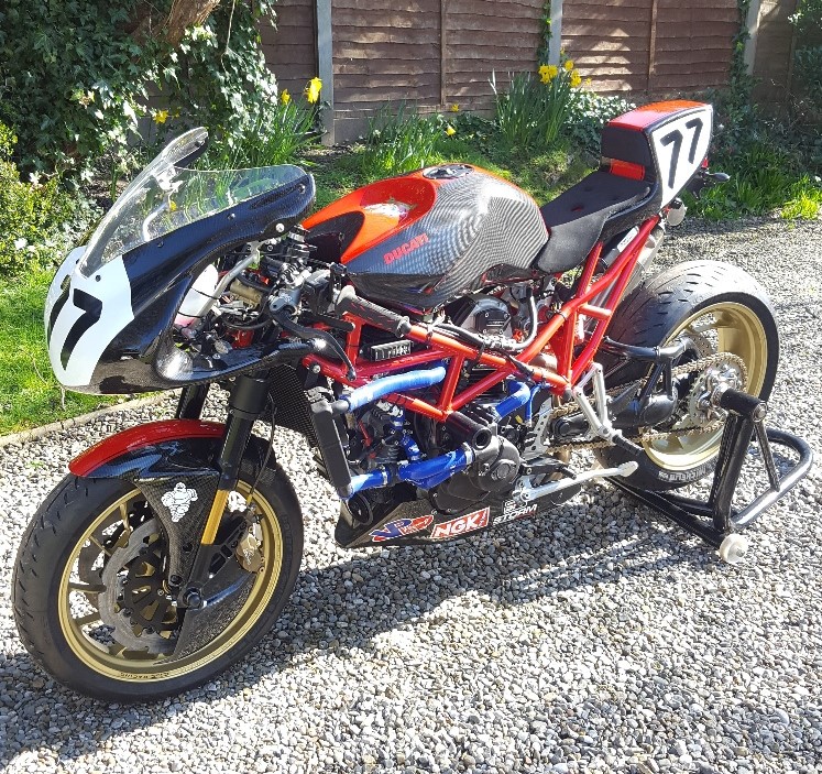

  1. Just thought we would upload a photo of a project my son and I built.
    Hope you people like the end result as much as we do.

  10. Thanks for the appreciation guys....
    @Geoffrey Lebowski haha, yeah a bit older than 10/11, he is 27, he has been fettling since he could walk and studied Motorsport Engineering at Uni.
    @VINNIE
    Spec:
    ST2 donor bike;
    996 forks, billet legs;
    S4R swing arm with NCR rear wheel nuts & sprocket carrier;
    Bespoke 2 into 1 exhaust by SPF (Storm Performance exhausts) with titanium end can and hanger;
    CF Radical Ducati tank and seat;
    CF belly pan, disc scoops and mudguard;
    Durrani magnesium eccentric bars;
    Hyperpro steering dampener;
    ExtremeTech shock;
    Samco hoses;
    OZ wheels;
    Translogic dash;
    Thumb brake;
    Brembo 19RCS with remote adjuster;
    RamAir filters;
    Magnecor leads;
    Barnett clutch;
    Rewire by RupesRewires
    We have some Hi Comp pistons on the shelf, but just wanted to see how she runs first, work in progress.

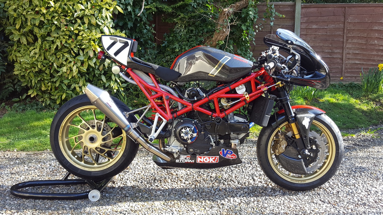

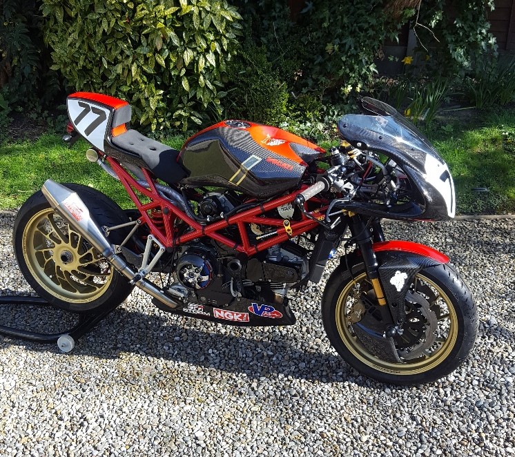

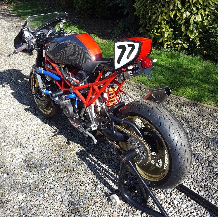

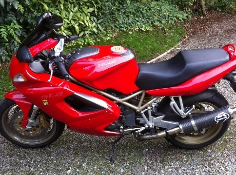

  20. The plan was to ride it until I can't and then give it to my son on the condition that when he has a son he hands it down @LeighAdams
    Come a long way from this......embarrassed to say how long it took to build @ck_uk , but we got there in the end. There never is a plan as such and when you do have a plan it constantly changes, the amount of head scratching, problem solving, research time, and brews drunk would probably add up to the spannering time.
