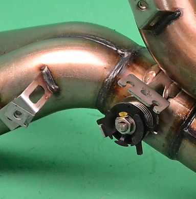

  5. Have you isnatlled the motor and cables?
    To keep the valve in the open position just disconnect the cables from the EXBV and the spring will keep it in the fully opened position.
  6. Yep put the lot back on!
  7. The motor is now redundant because it is disabled in the ECU. Just take it all off except the sprung pulley. The valve is held fully open by the spring. You're carrying around dead weight in the motor.
  8. Think I'll disconnect again and see how it goes on Sunday, and if all A1 junk it all and leave the spring.
