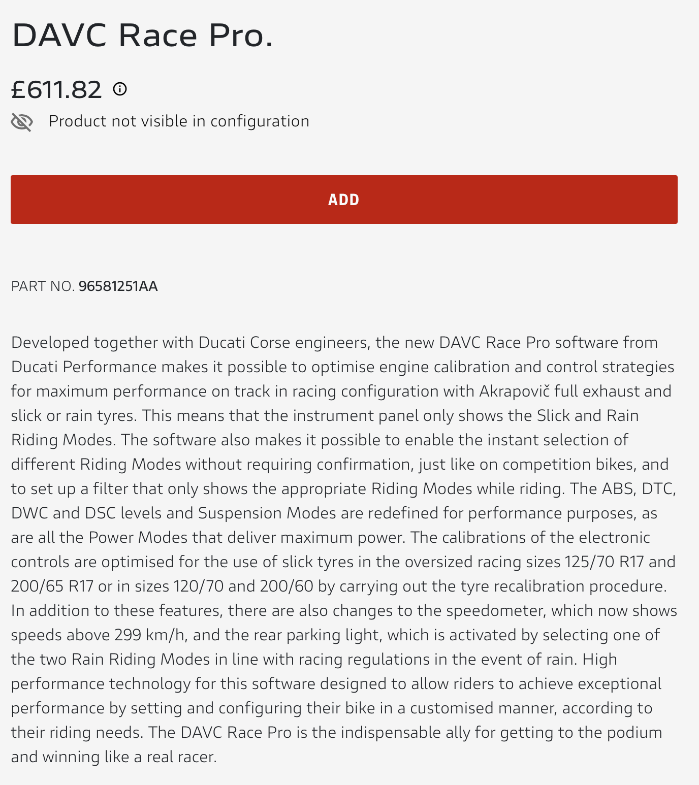

  10. from Ducati website
  11. interestingly not listed for the R yet though

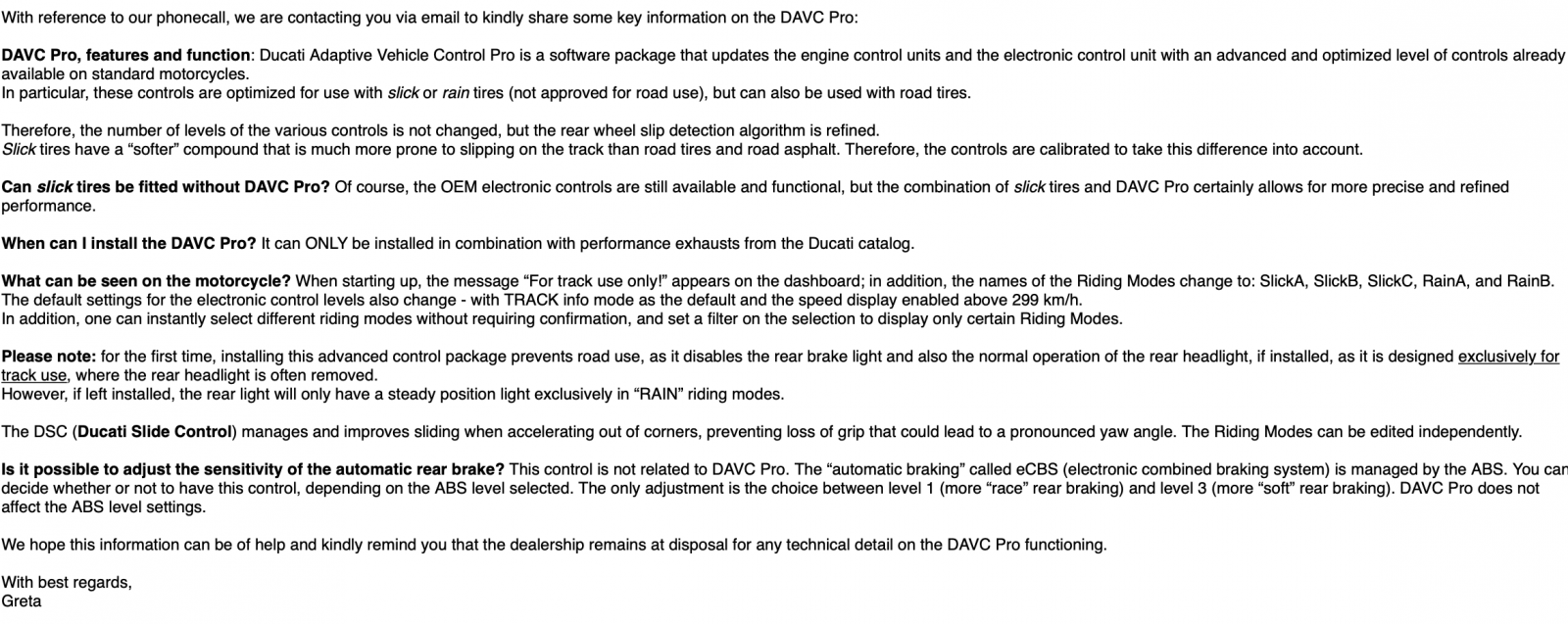

  12. Email I sent
    Dear Ducati UK,
    My question is concerning DAVC there has never been much info concerning this, particularly in English, and still not much information for the ever technical 2025 DAVC. Yes you can feel and see the benefit with a bit of guess work but, what would be really beneficial is some sort of presentation regarding what it truly is and does, and how this benefits the rider.
    I would pay for a day half day meeting/presentation delivered by someone fully in the know ideally in English regarding the DAVC. I know i'm not alone in this request to understand the product. Is this something you could consider please even at Ducati UK Silverstone HQ say during the horrid winter months Im sure there would be a big take up on this
