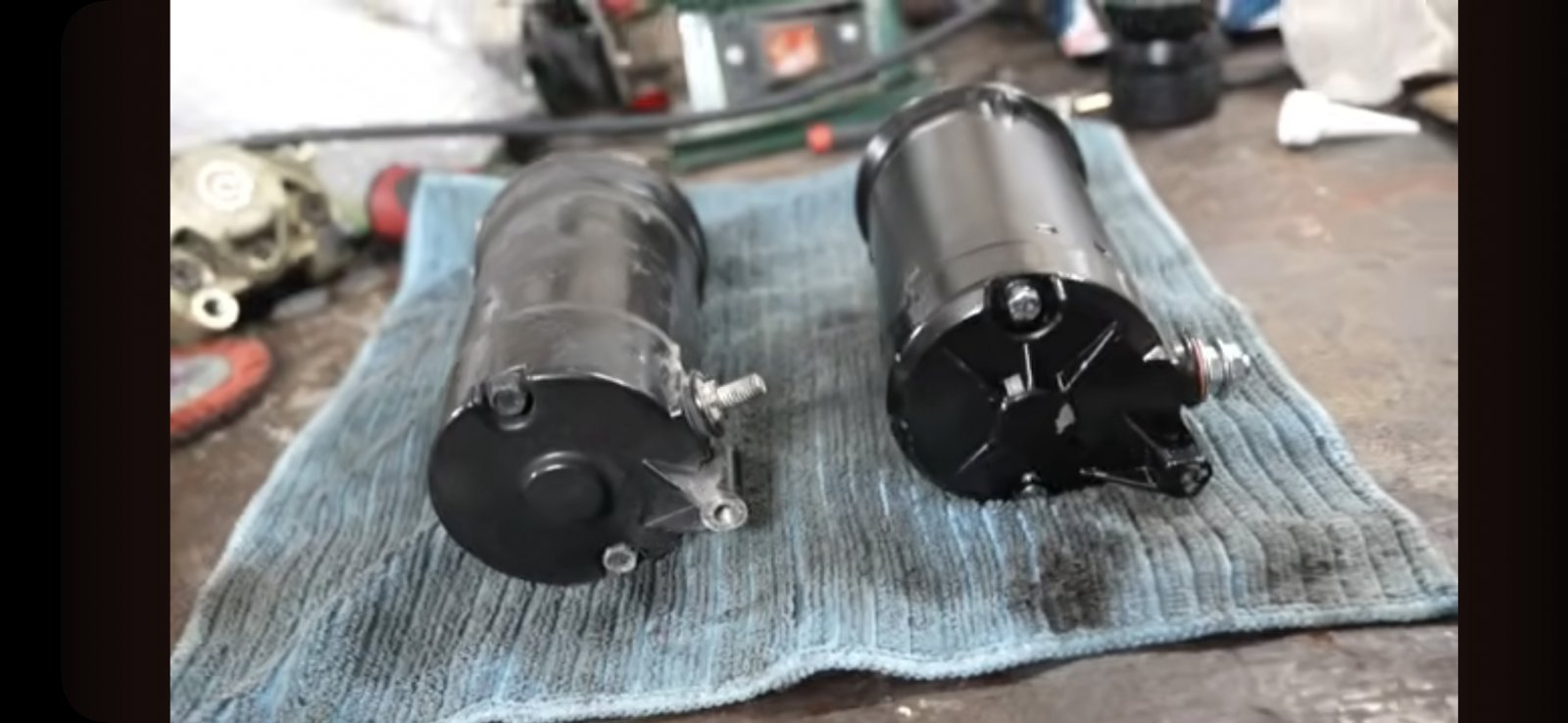

  8. It is apart from the silver bolts and head is ever so slightly different shape.

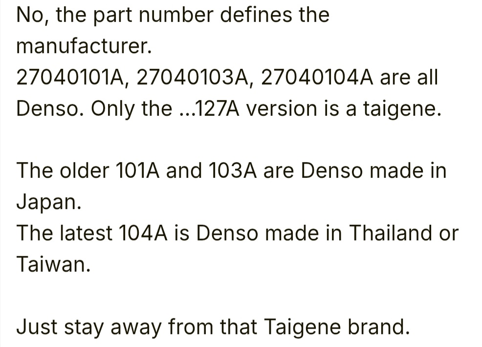

    From what I've found on a different ducati forum is to stay away from the taigene brand and go for denso
  9. The bolts arent an issue - do you have a picture of the different shaped head...? so from those 3 part numbers im guessing the higher the part number the newer the part/less use....technically...
  10. Left is original taigene, right is denso.
    Some have listed hyper 1100 on ebay as fitment as well as 821, 939 and 950. But double check if you do purchase
